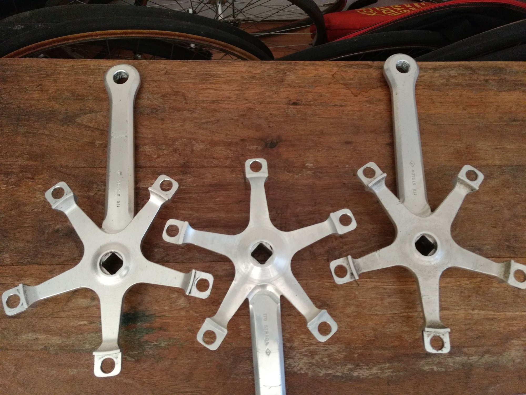

Be aware of the CPSC differences when you buy a Campagnolo crank. The 73 shown above is pre CPSC based on the date and the larger built up area on the back side. Post CPSC have less of a built up area. Different spindles are required.
Check out photos in this BF thread to see the actual differences.
Go here for BB information you will find useful
Isn't it 78 and later are post CPSC? Or is it 79 and later?
According to Chuck's Campagnolo Timeline:
1978
C.P.S.C. (Consumer Product Safety Commission) mandates changes to NR/SR. Included are a front derailleur lip, 2.5 mm increase in spacing between crank spider and arm to clear the front derailleur lip with corresponding increase in bottom bracket axle length, a curved quick release lever and ball-end added to quick release conical adjuster, dome-shape added to quick release cam lever on brake calipers, plastic covering added to the wheel guides on the brake shoes, and plastic safety-shields added to rear derailleur screws.
rootboy is offline
Old 08-19-19, 09:21 AM
Last ride 76
Last ride 76's Avatar
Posts: 1,155
Quoted: 226 Post(s)
Liked 86 Times in 69 Posts
1978
C.P.S.C. (Consumer Product Safety Commission) mandates changes to NR/SR. Included are a front derailleur lip, 2.5 mm increas zzze in spacing between crank spider and arm to clear the front derailleur lip with corresponding increase in bottom bracket axle length, a curved quick release lever and ball-end added to quick release conical adjuster, dome-shape added to quick release cam lever on brake calipers, plastic covering added to the wheel guides on the brake shoes, and plastic safety-shields added to rear derailleur screws.
Photo of difference pre CPSC (center) and "post" CPSC (outer arms)... Apparently Campy was trying to get ahead of the curve, which makes sense from a sales/stocking perspective.
Note the date code on the right, is a 7 in the diamond. Left is an 8 in the diamond, the center arm is the pre-CSPC design, with a 3 in the diamond and the beefier center " bulge".
