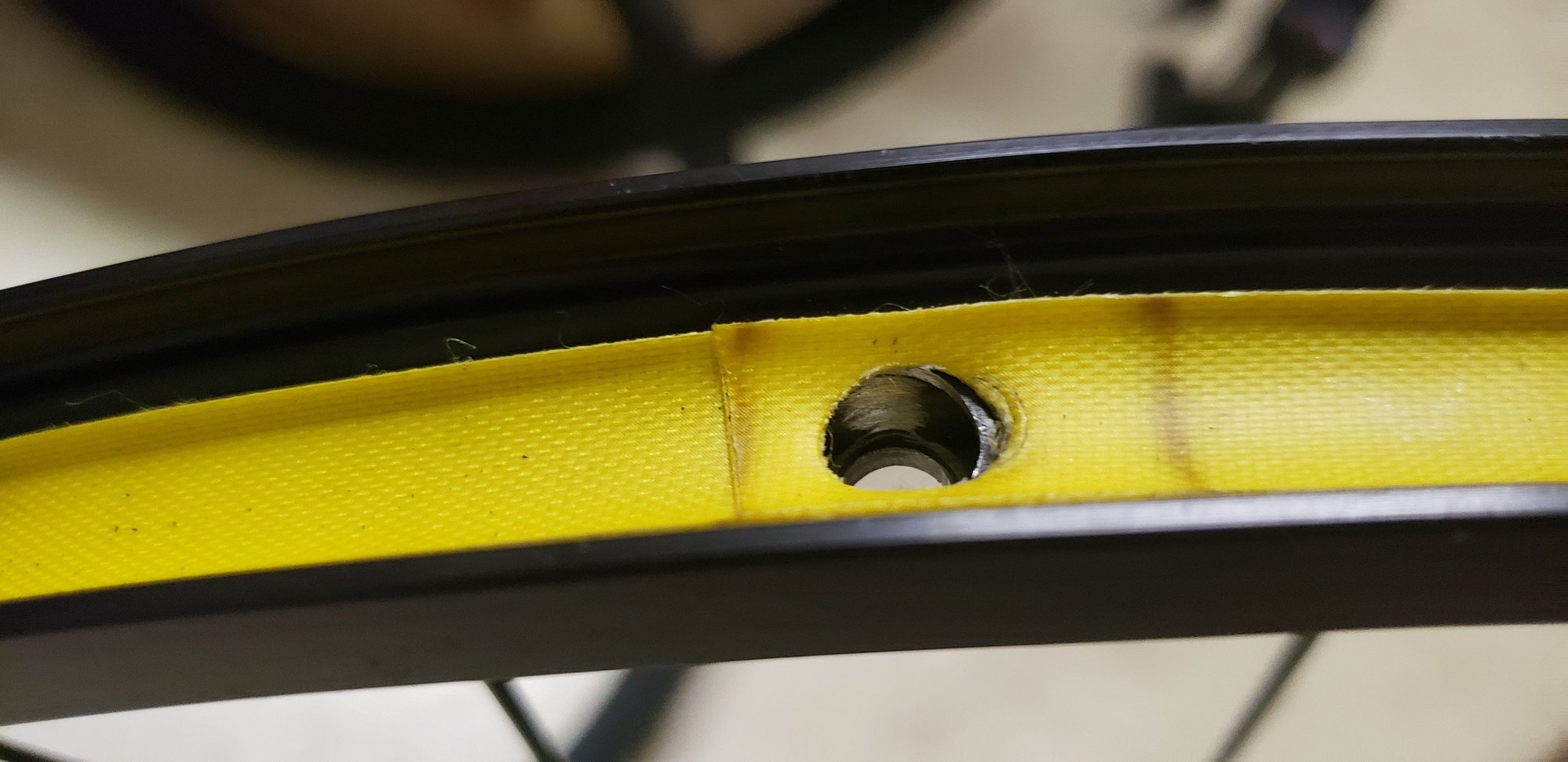

Sorry about that, forgot to post the rim, which has been suspicious since the tape ends where the valve is and that's where the punctures have been

replace the tape & tube.
-Oh Hey!
-Oh Hey!
Replacing the tape is a good move even if it is not related to the problem. Please use Velox or similar cloth rim tape. Tube splits are tough to figure out. Often it is simply poor tube quality. We had a rash of these in 2011 from Specialized. After that batch, the problem went away. Regardless, coat the tube with talc. It does help the tube settle in and not stick to things as well.

A good way to check for burrs or objects is to use a dryer sheet and drag it around the rim, tire, whatever you are checking for snags or protrusions. Dryer sheets will snag on anything and let you know if there's a problem. In agreement with what others have said so far.
Not the puncture pictured, but twin cuts (like an equals sign but with some acute angle) are pinch flats. The tube gets caught, and the two sides each get torn open. Sometimes just one side, and some times both. Both more likely if there is a pinch and you hit something hard.
