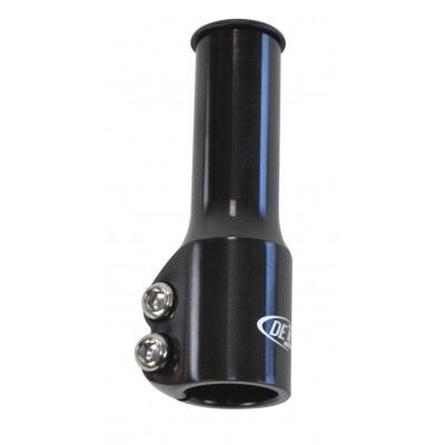

If you want to raise bar height without much effort or expense, you can install one of these Delta stem raisers.
Then you can raise or lower the bars to suit.
There is one complication with raising the bars: you will likely have to replace the brake/derailleur cables and housing with longer ones.
