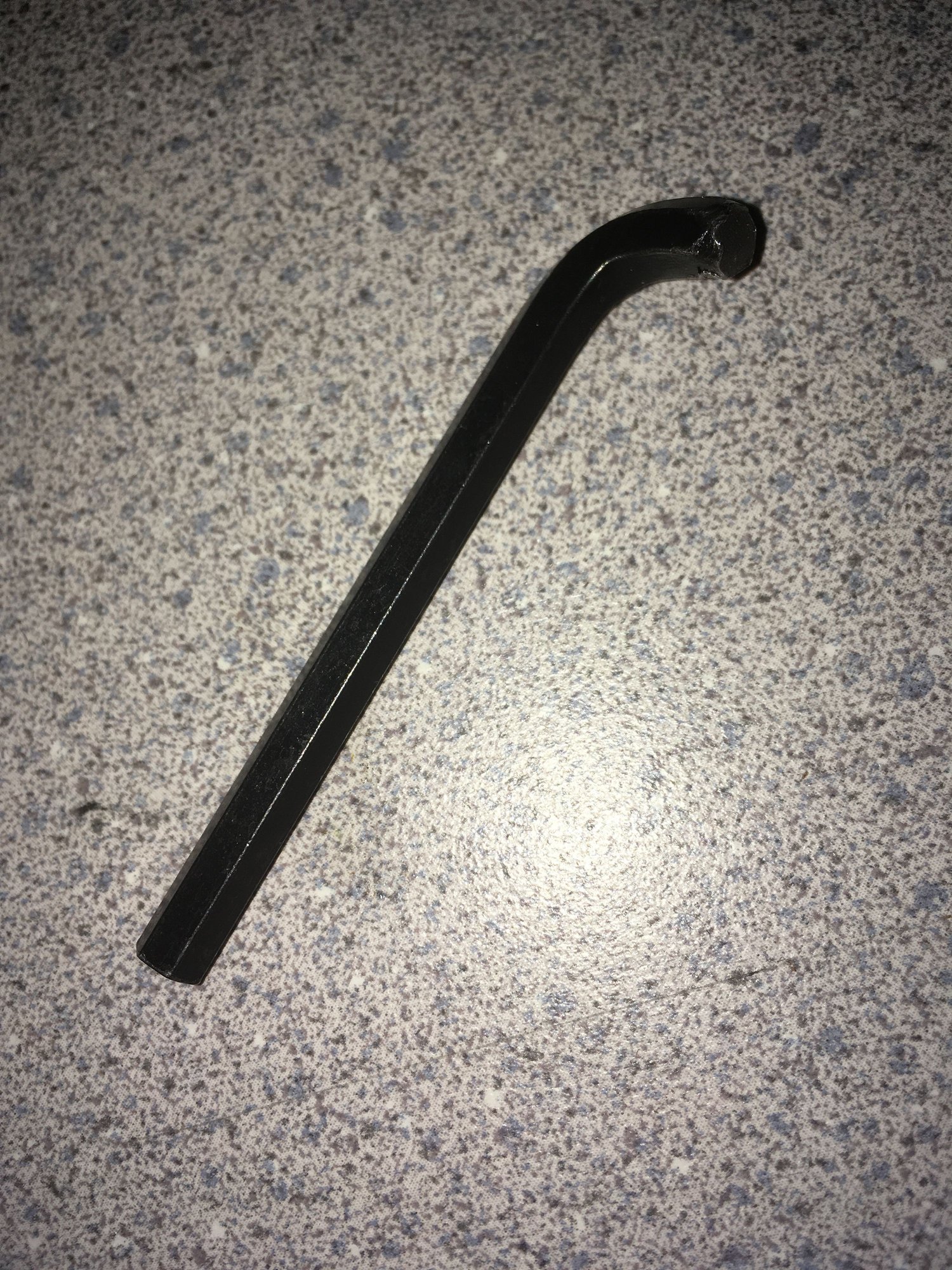

OP: I have a similar situation and rather than 1) replacing a perfectly suitable factory braking system simply to facilitate routine service, or 2) visiting a largely dis-interested LBS for this easy DIY maintenance item, I simply followed another posters suggestion and cut down an allen wrench for this very use.
Problem solved and good luck.

So, I 'm guessing getting a allen wrench thats shaped like an L and cut it so that it'll fit within the gap. You got a picture I can see of yours?
I used a side cutter (die cutter) with a cut off disc for this.
