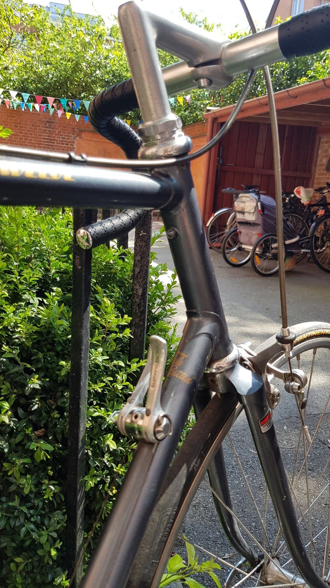

Just purchased myself an ‘89 Miyata 912
Couldn’t resist sticking a bid in for it at ~$220.
Kitted out with mainly Shimano 600 gear and with the Araya rims. However, for some reason I couldn’t find this paint job in the catalogues… which didn’t make sense to me.. also the listed Miyata is a 914 for that year. Can anyone advise on what’s what here?
Anyway, it looks to be in great condition.. just hoping that it’s not too much on the large side for me… I’ll update on my build as and when it happens

Are you sure that's an '89? I just bought a 1984 Univega Gran Premio with those same type "aero-style" shifters. Love the look of 'em, and people say they're the finest friction levers ever built, I'm hoping so.
But friction shifting ought to place the bike's year of manufacture no later than '85 or '86. Post 1986, I don't think you buy anything new that didn't have friction shifting.

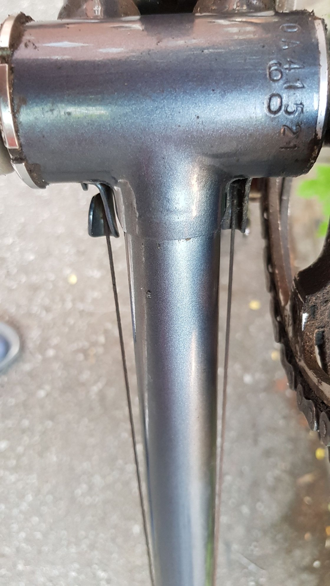

I’ve asked for the serial number to confirm the year, but I’ve looked through a few of the catalogues and there is no sign of the paint job.

Yes, the serial numbers indicates a 1986 model but I knew it wasn't American market the moment that I saw the top mounted, aero shift levers and the friction New 600EX. Both are typical of European models for 1986, though they're typically branded Koga Miyata and their 1986 model with Shimano New 600EX was the Roadwinner. So, while it's a better match than the Amerian market 912, it still isn't perfect (wrong model, wrong tubing decal, no contrasting head tube).
I'm not aware of Sweden having a different Miyata importer and models than the rest of Europe but it's possible. Most brands imported into Sweden share a importer with the other Scandanavian countries and the legislated bicycle VIN system for Denmark does not include Koga. It would be interesting to know if there is a 2nd serial number (i.e. Danish VIN), which is typically located on the lower down tube or seat tube.

Interesting that on a Euro market bicycle, most of the decals are in English.

The only frame markings are the ones as attached. Does the above still mean that the bikes originate from the same place as the American imported Miyatas? I’m a newbie regarding the Koga- Miyata

I looked around for these VIN numbers and nothing seems to add up. The original 912 I posted has a frame number letter prefix of OA, which, according to the Danish VIN system does not exist due to them omitting ‘O’ due to it looking like a ‘0’

The OA and RA numbers are the factory applied serial numbers, indicating the first fortnight of 1986 & 1989 reapectively. However, the latter ycle wears Shimano New 600Ex, which was only the 1986 & 1987 model years. A 1989 would have 600 Ultegra. Conseqently, I believe the RA is actually PA, representing 1987. This would make it another 912 but one model year newer.

The serial number from the receipt is OA41521. As searched - 'O' appears to be 1986... although the catalogue that year was black with a pink headtube.

If the Swedish bikes used a different head tube decal, maybe they changed the contrasting head tube feature as well.
Arghhh... I think I’ll have to go for it unfortunately, only to selflessly stop someone else stumbling into making such a mistake
I noticed your Swedish Miyata has a different head tube decal. All the American Miyayas i have seen use a variation of this "gear" design (this is a 1987 "Competition" model 512).
