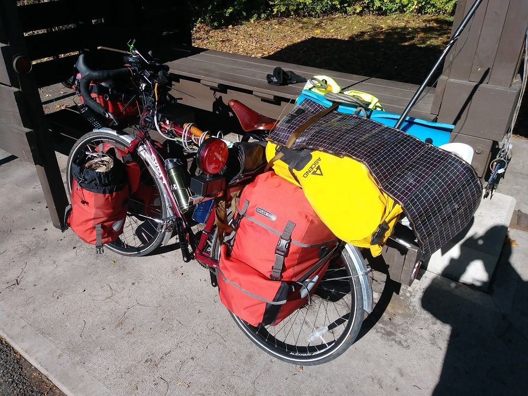

Thanks for the thoughts. Yeah, I have thought about a dynamo system. However, I am using a 12v battery to power my electronics so since I already have that power available making use of it for lights, also, seems like a good idea.
I experimented with some portable trailer lights I have that are LED. They draw around 50mA in running light mode so that is acceptable. I wanted a wider lit profile for my trip so mounting these lights on the bar worked. Yea, its bulky but it was what I had and for the experiment it worked.
I'm thinking of looking in to some smaller LED trailer lights - they are all 12v. The trick is how to control them. I will look up some control circuits and see what I can find. Who knows, maybe I can make my own. If I can get by with a couple toggle switches by the bar somewhere to control them that would be great. As to headlights - no idea on that yet. Maybe dynamo headlights would work - they are wired so I could run power from a switch. Though, I am not sure on available "modes" - brightness level and flash pattern - or if they even can exist in the form I am envisioning.

That is quite a rig you got there!
