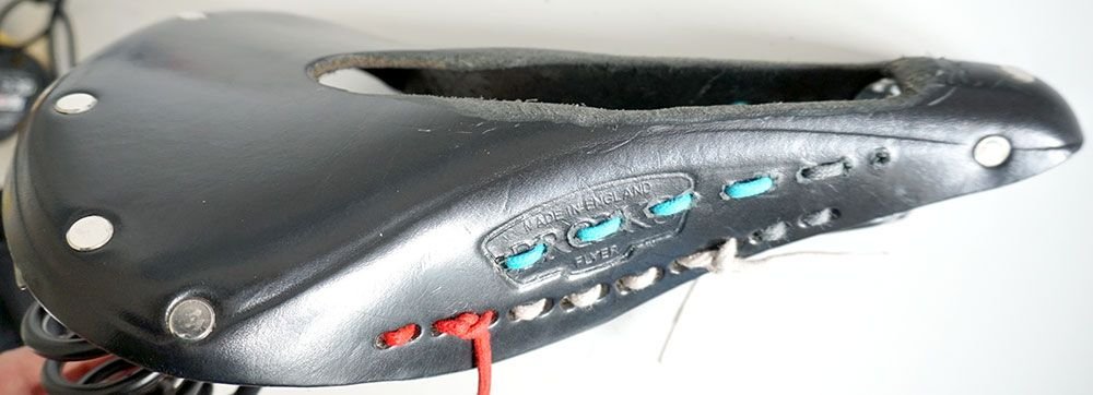

I have had a similar problem. I wound up raising the height of my handlebars and switching to a brooks saddle and that took care of the problem. Good luck

What type of Brooks saddle worked for you? Years ago I switched to a B-17 and never looked back.

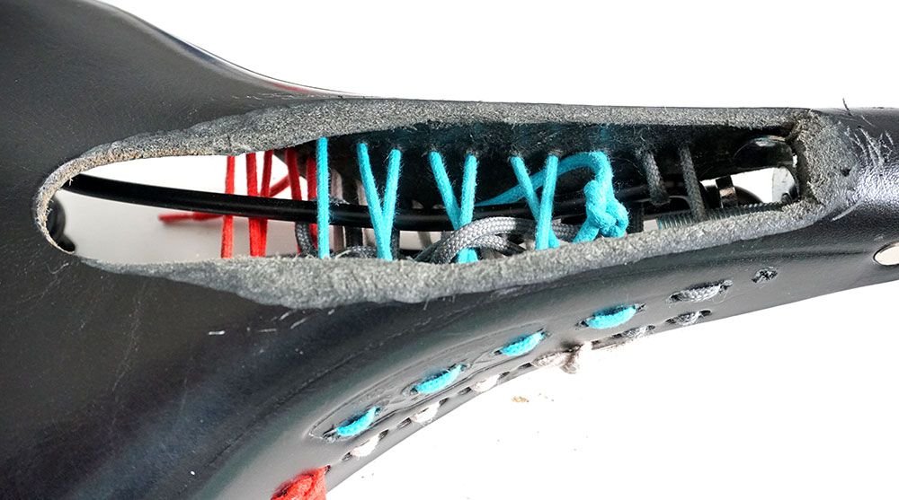

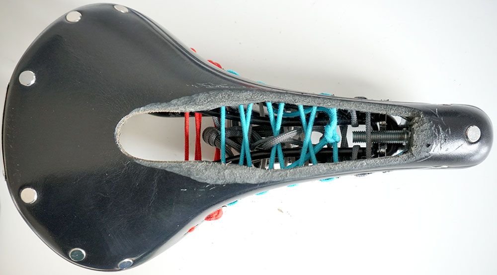

I have occasionally experienced numbness but not really since riding cutout saddles. The old Nashbar offered affordable cutout saddles for under $30 and I have them on most of my bikes. Also, I actually like my seats pointed up just a bit - keeps my sit bones where they belong and eases up the weight on my arms.

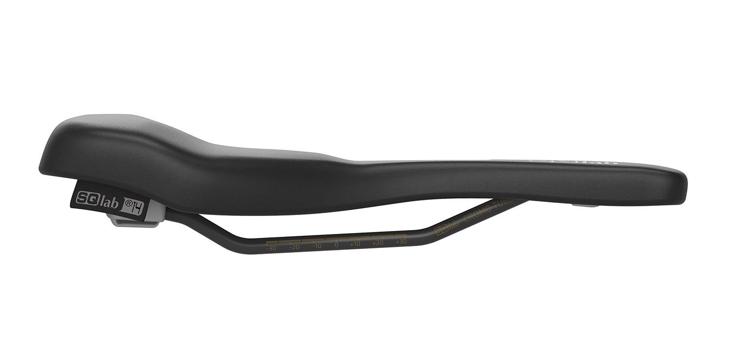

I tried a lot of saddles to solve the perineum discomfort, but none of them worked well because they either fell off too steeply to the sides so that the center rose up, or they were too soft and sinking down caused the material to be pushed to the front and middle. Brooks imperial with cutout was the least problematic with the perineum, but the sagging hammock shape resulted in the bridge and nose rising up and bumping into the perineum. So I cut off the top of the bridge to bring it lower. Now there is no more contact except on very big bumps. I decided to stick to this trimmed Brooks, as there are no other saddles that I've tried that have been better.
The only other saddle that was almost acceptable was the SQ Lab 610 Ergolux Active (1.0 or 2.0), but there were 2 problems. Main problem was the leading edge of the wings were too sharp and so dug into the underside of my legs. A more rounded edge would have solved this but they stuck to this design for many years. 2nd problem with the 610 series is that the bridge doesn't drop low enough for me and it actually angles back up to the level of the sit area. The sit area itself is sloped downwards, so I keep slipping forward. If I raise the saddle angle, then the bridge rises up and negates the benefit of the drop. The 602 series has a much deeper drop so there is absolutely no perineum contact, but in addition to the sharp edges, it is also much softer so material gets pushed forward towards the sharp edge. Also, if you plan to try the 610 or 602, the 610 seems to be 1 or 2 cm narrower than the 602 even if they are marked as being the same width, so you should order a larger width 610. I have 13cm sitbones and the widest 16cm 610 was ok, but anything narrower was too small for me.
