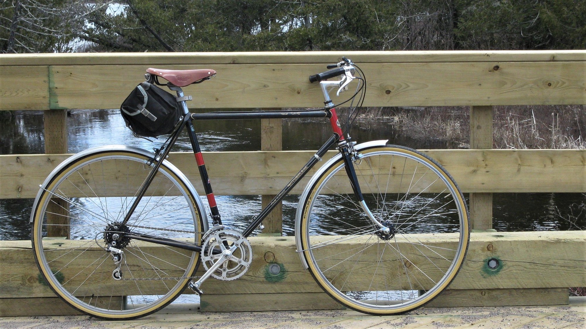

OK I thought this would be my build thread but I guess I need a new post, I'll look into it.
Here's a picture I took this evening on a test ride with new seat and handlebars (which seller threw in with bike). No bueno, those bars actually put me a little more forward then the drop bars did, and makes it uncomfortable on my hands/wrists. Figuring out the right bars will be my next big challenge I think! I'm thinking I might try to use these bars though to find good body/hand position, by rotating them up and back and trying different positions. Worth a try. Also wondering if I might need a different stem...?

Ah yes, many have fallen to the charms of the mustache bar only to realize once installed that they don't do what the rider wants them to do. Ask me how I know... You might be better off getting a flat bar or a city-style flat bar (some examples here: https://velo-orange.com/collections/...d-upright-bars) and new brake levers with the correct amount of cable pull. If you still want to try these mustache bars, you can get a shorter stem to try to bring the bar closer to you.

Another question: are those 700c wheels, and what tire size are they? Thanks!

Those bars you have there look like maybe they go a little forward before turning back, yes? Is the hand position in line with the stem? No worries, if you don't have it anymore to know for sure, I'm just trying to get a feel for what I might want.

The wheels feature Dura Ace high flange hubs laced to Weinmann concave 27" rims. The tires, I believe are 27 x 1 1/8. For what it is worth, I am running the same rims on my Legnano, only the Leggy has 700c rims. Needless to say, though pretty heavy, the rims are darn near bullet proof and look the vintage part also...
And thanks for the pics of the upright bars, I bought some very similar ones today from a bike shop for cheap, they were take-offs from a Linus he said, $20. Will put them on tomorrow. Actually looking at your pictures again I think maybe these bars I bought don't have as much rise. I'm thinking they will still be a bit low, so I may consider a different stem next... Will post pics tomorrow.
if you are going to not use drop bars, you should change out the brake levers i like the tekrro https://velo-orange.com/collections/...-22-2-dia-bars

Making some progress. Changed handlebars, and I like them, but I need more rise, so ordering another one. Also ordering an offset seat post. Next I need to figure out wheels, want to order some 700c wheels and tires...
I have had a couple of "Nice bike!" shoutouts while riding around ;-) On the other hand the bike guy at REI was strongly arguing against putting a lot of effort into this bike, a losing battle he said. Ugh.
Gears are not very well tuned, and I think when I do new wheels I will try fixed gear for a bit. Have been hardly shifting at all, and am fine 95% of the time.
