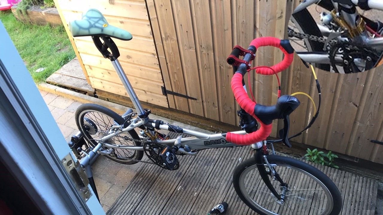

No it is fine; itís 1.5 mm clear from the longer chainring radius. The chainrings are power q rotors that are supposed to smooth the low torque.

This is a more "universal design". In my limited experience, the adaptor needs to be able to be fitted upside down as I did (put the braze peg on the other side) whish you can do wit this new design however, the cable stop is still an issue. ideally, the cable stop would be linked to the peg so that it is totally universal.
I'd about 100kms with my setup of mountain biking in the mud, giving through fords and it works well. if I can be bothered, I'll take it apart to improve the look of the adaptor, machine the excess out and paint it...

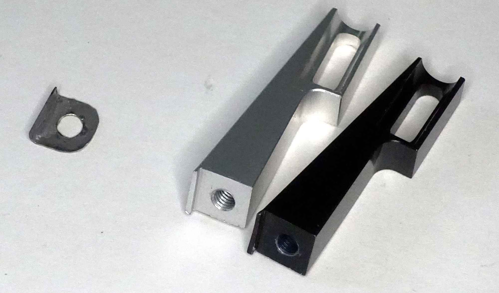

One problem is that the vertical part of the adapter with the actual braze-on is only held in with a single bolt, so it could possibly twist itself loose, and on my copy, the tiny tab on the bottom that's supposed to be the "anti-twist" stop has such a huge gap to the surface that the tab is supposed to press against, so the vertical part would have to twist almost 5-10 degrees until it hits the stop. I would probably have to glue some shims to it if I want to keep it more parallel to the clamp.
If I had the chance to redo my FD adapter, I would still 3D print another vertical part for the new clamp, for better ease of adjustment and positioning. But at least the new model might solve some of the problems that the old adapter had, although it introduces 2 new problems with the "twisting" with the single bolt, and the flat bolt face.
Uh, I just tried this new Litepro on Brompton and the finger of the adapter, secured with just one bolt, rotates uncontrollably under the forces common for derailleur operation. Yes, maybe one could stabilize it with some shim, but then the shim might slip out or something. I am retreating from that route and going back to my adapter for Birdy there. The latter worked fine, but I was curious whether I could pull the derailleur in by 1 mm or so by swapping the adapters Another problem was with the derailleur's spring getting in the way of shift cable. As background info, I have there a double derailleur working as triple. I was working around that area so it was a good opportunity to try.

I did order the cheap one with the single bolt because it was just $10. I did not install it, but the braze on part twists around and doesn't stay perpendicular. They should have used 2 bolts or milled an insert or used better tolerances to keep it from twisting. But I would still 3d print my own braze on part and only need the clamp. So $10 for this new version vs $30 for the old version is better for my purposes. Although the trapezoid shape of the old one made it more forgiving for 3d printing tolerances. The new one with a slot would make it more difficult to prevent slipping, you'd probably just rely on 2 bolts to keep the printed part in place.
As for a shim, maybe folding it over so a part of it also goes into the slot may prevent it from getting lost.
Yeah, I already made the first washer with a lip as a ship and it limited the rotations, but it was too thin, so I will try a thicker sheet. Nonetheless a better design with 2 bolts would have been obviously better, with a longer leverage arm for holding back the rotations.

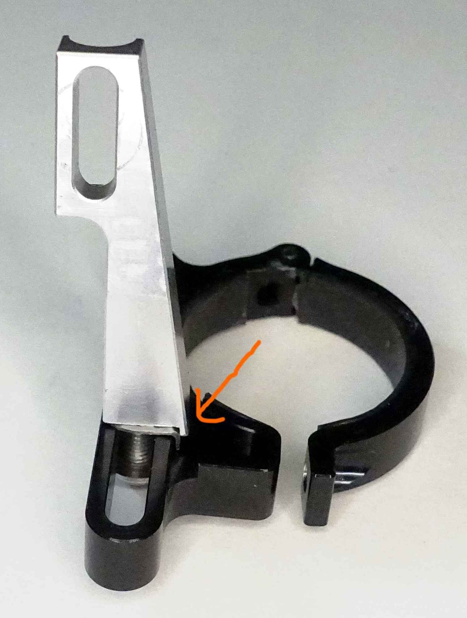

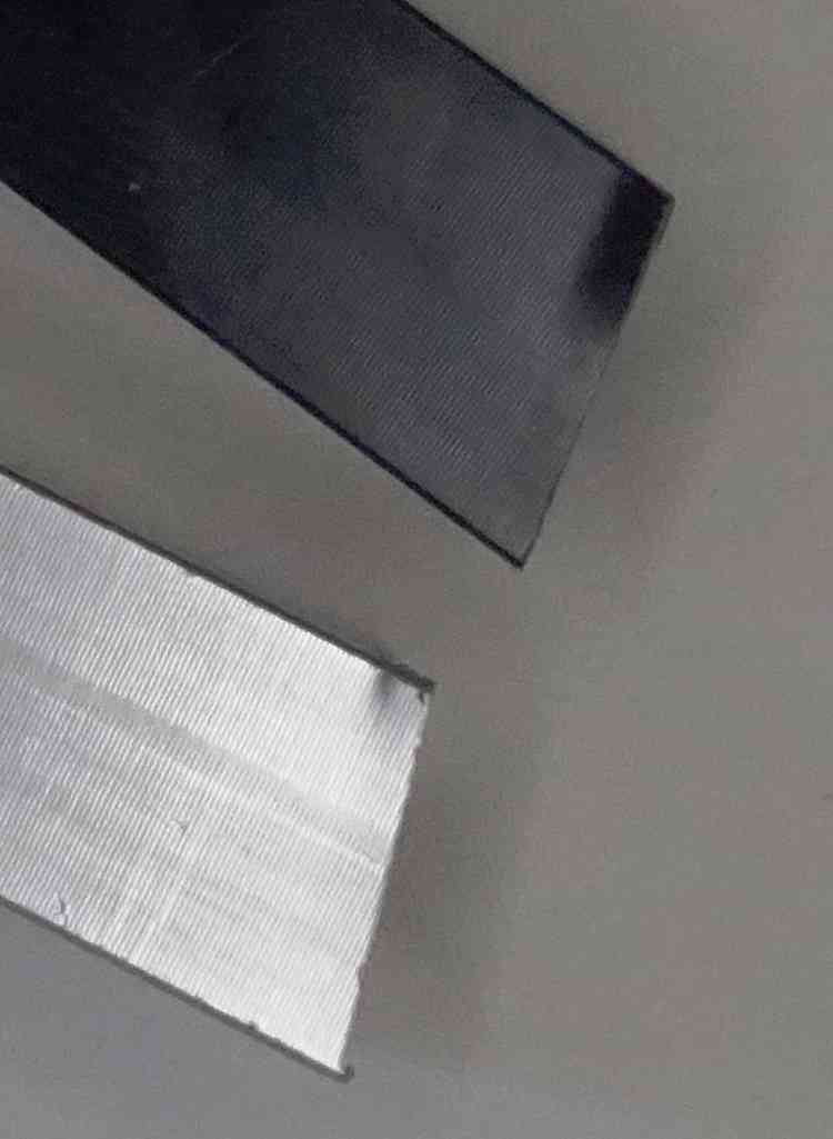

The tiny tab along the bottom of the finger is so thin, that the twisting forces can shear it off. One photo below shows the outside of fingers bottom with the bends signifying the start of the shearing off for the tabs. Manufacturing variations appear to yield tabs of different thickness, so I am using an old silver finger with a thicker tab in combination with the newer slimmer band that leaves more room for the derailleur. My L washer, placed where the arrow is, fills the gap between the finger's tab and clamp, preventing rotation, trying to fix the design's flaws.
Fingers w/different tab thickness + washer
The thinner tab has progressed more towards getting sheared off.
L-washer in place.
2_i is offline
