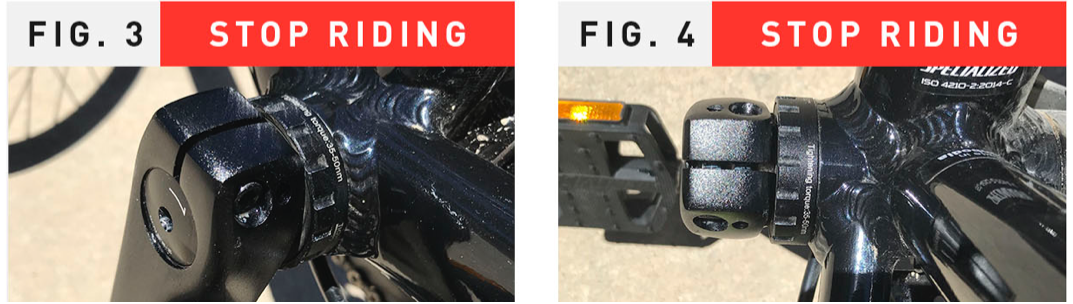

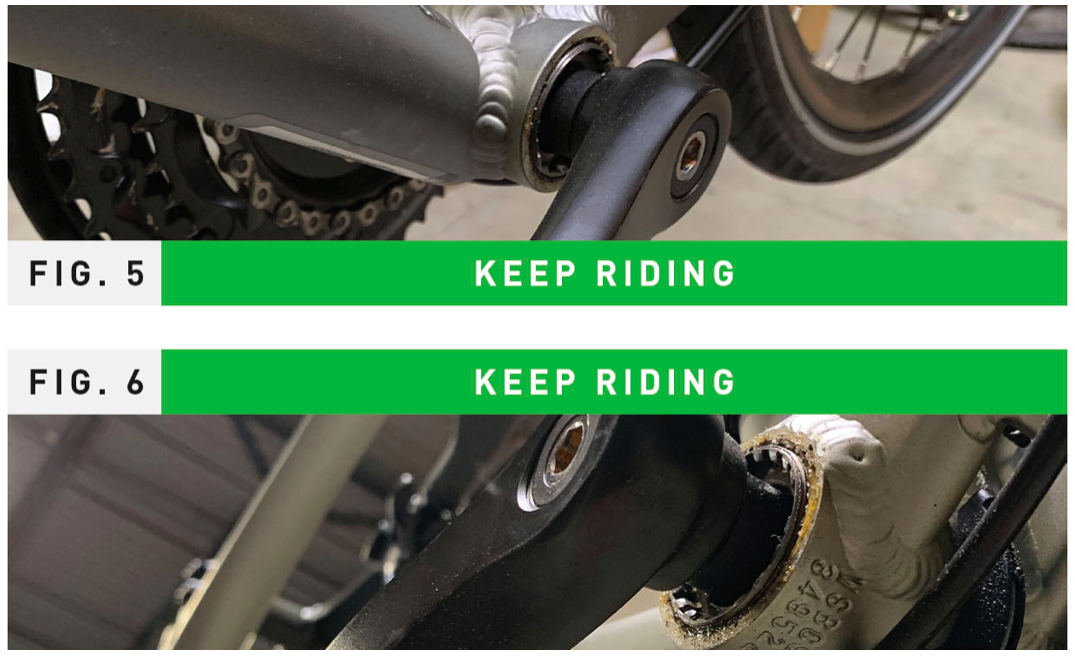

These images from Specialized website's recall notice show you the crank design subject to the recall.
jimmyodonnell is offline

well, I got the left crank in figure 3/4, now just to wait. I agree, doubt we hear this week with the holiday. Not a good way to start my relationship with Specialized, I'm sure they make it right, but they damn sure ought to fix with higher quality parts, just to compensate for loss of use of bike.

the specialized website is now updated with instructions to contact your retailer to schedule a fix on the crank recall.
so I took in my bike (along with the crank which had fallen off it) and the shop says oh it's supposed to have these bolts on it but specialized hasn't given instructions on what to do if the bolts aren't there
and I said well if the bolts were still there the ******g crank wouldn't have fallen off and we wouldn't be having this discussion
so they're keeping the bike there and estimate they'll have an update in a week but don't know if they'll have it fixed in a week

By the wording of that, I'm going to guess that a spacer was added that shouldn't have been there. This will cause the splines to not engage fully, and the left arm will fall off. Or the stopper plate is missing.
Correct. As I understand it, that (spacer installed that should not have been installed) is the issue.
That's a little odd to me; a spacer is a quick visual check, IMO there is no need for all two piece cranks to turn their bikes in. To further confuse matters, their picture shows no spacer. Maybe some bikes need spacers and others don't, which is a different can of worms. Anyways, this sounds like a nightmare for all involved; I hope everyone gets satisfaction once the dust settles.
A pic of my nearest external BB (NOT A SIRRUS) with two spacers clearly visible for reference.
