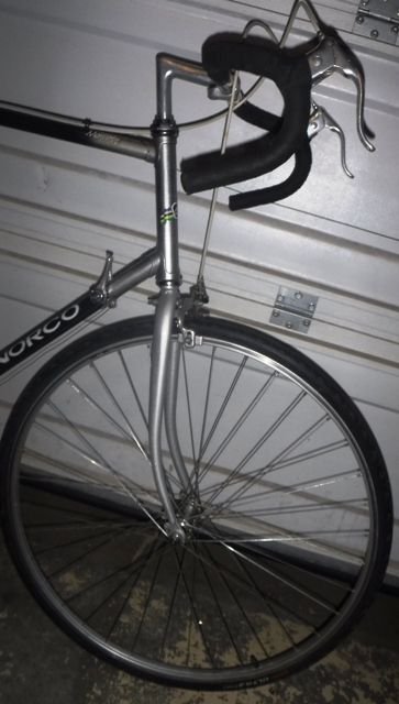

I picked up this Norco Monterey very cheaply for a friend and met the PO who was riding actually it when I arrived. PO had just rode 17km (about 10.5 miles). He had owned it for about 6 years and rode regularly. I rode the bike hands free and it rides like a dream. Everything worked fine. It shifts well, brakes and steers properly didn't notice anything to catch my eye. But, I should have....
Tonight as I was cleaning the bike I noted the angle of the forks. I took the photos standing slightly off side to prevent causing a shadow and though they don't look it the dropouts are actually aligned with each other. The issue is that angle and I can't believe I didn't see it. Even though I can see it with my own eyes, I have trouble believing that it is an issue after having ridden it though the rational side of my brain says don't let someone ride that as it stands!
My bad and I accept I have to eat this but now I am wondering how feasible it would be to attempt to either remove the current steerer and replace with a new one or make an attempt to straighten out the forks. I should say I haven't pulled the forks and who knows, might be a shock when I do that. But as I said the bike rides very well and seems a waste to just strip it and ditch it.

I don't have any experience straightening unicrown forks. My first response is to be hesitant. I don't think the steerer is bent, or the headset wouldn't be smooth. I would look at the top of the blades for evidence of damage.

If the fork bent back with no side deflection (when impacted) then the steering alignment is not changed. The stability factor is. As mentioned the first thing to figure out is whether the steerer is bent above the crown seat. If not the ease of re establishing the fork's rake is better. Have you looked at the main frame for impact damage there? Andy

Main frame (top tube and down tube) look quite good. If they were damaged it's not noticeable now. This afternoon/evening I'll pull the forks and photo that.

Ye local frame builder took one look at the forks and said, "front end collision at very low speed". Obviously I'm not gifted with the eye for such fine detail.
I can happily live with a little humiliation in exchange for a good bike!
