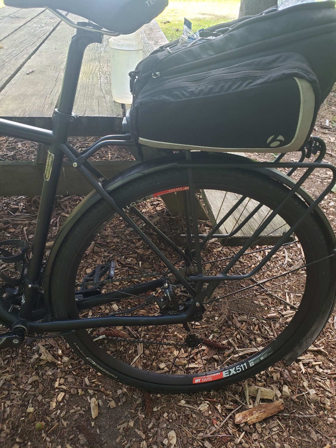

On my Lynskey Backroad, the only way I got my rear rack (RackTime AddIt) down to a reasonable level with the high mounting points was with two modifications.
(1) My frame has two mounting points, the upper for rack and lower for fenders, I am using the lower for both fenders and rack. That lowers the rack a half inch.
(2) The RackTime rack has flat vertical aluminum plate for the two lower mounting points, I drilled new bolt holes in the rack so that I could lower the rack another half inch.
Initially, before I drilled it I mounted the rack on the upper mounting points and fenders on the lower, that put the rack way up high. I would have liked to get it another half inch lower than where it now is, but I can live with it the way it is.
I prefer racks that allow me to hang my panniers down on a lower rail instead of the top. I use a Tubus Logo EVO on my other touring bikes, that also has the lower rails.
This photo is with modifications.
You can see closeup of the modifications here, fenders mounted inside frame and rack outside.
Photo below is before I lowered it.

I use a bontrager rack and the interchange bag. Works good stays secure
