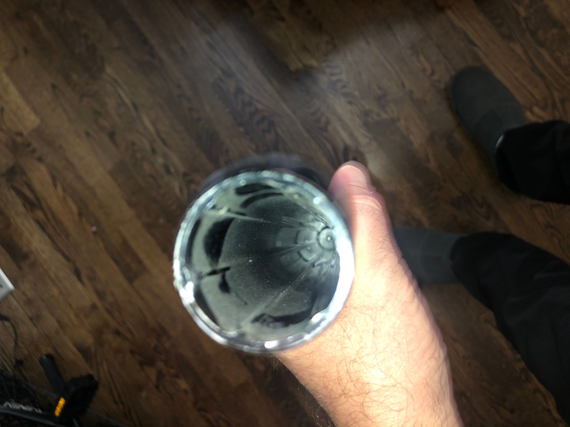

I just checked, and we have 7/8" factor of safety on the "minimum insertion" line, so you wouldn't even need to get a longer seat post.

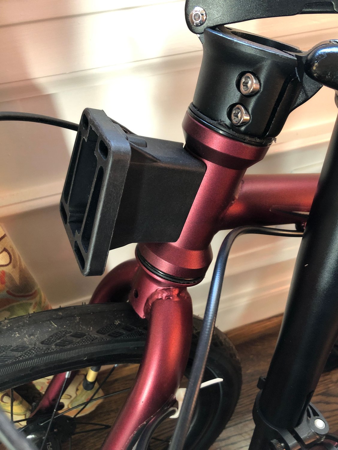

This looks good! There currently aren't tons of options for lower priced 16" folding bikes.
Personally I'd prefer IGH and rim brakes for a folding bike because of the risk of damage to derailleurs and disc brakes when packing/traveling but I wouldn't rule out a bike because of those things.
Can this bike accommodate a rear rack?
Front luggage block on Origami Lotus.
