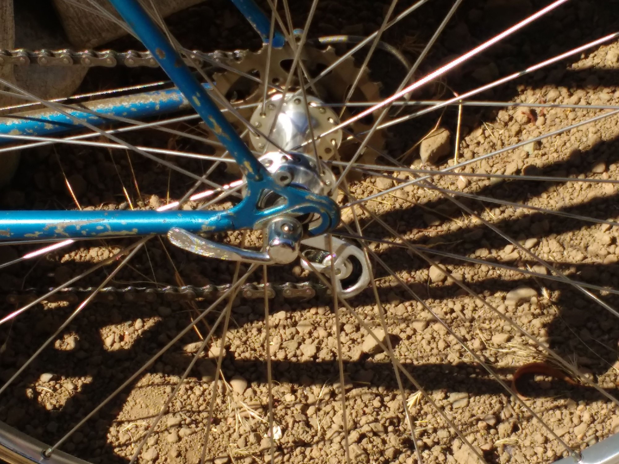

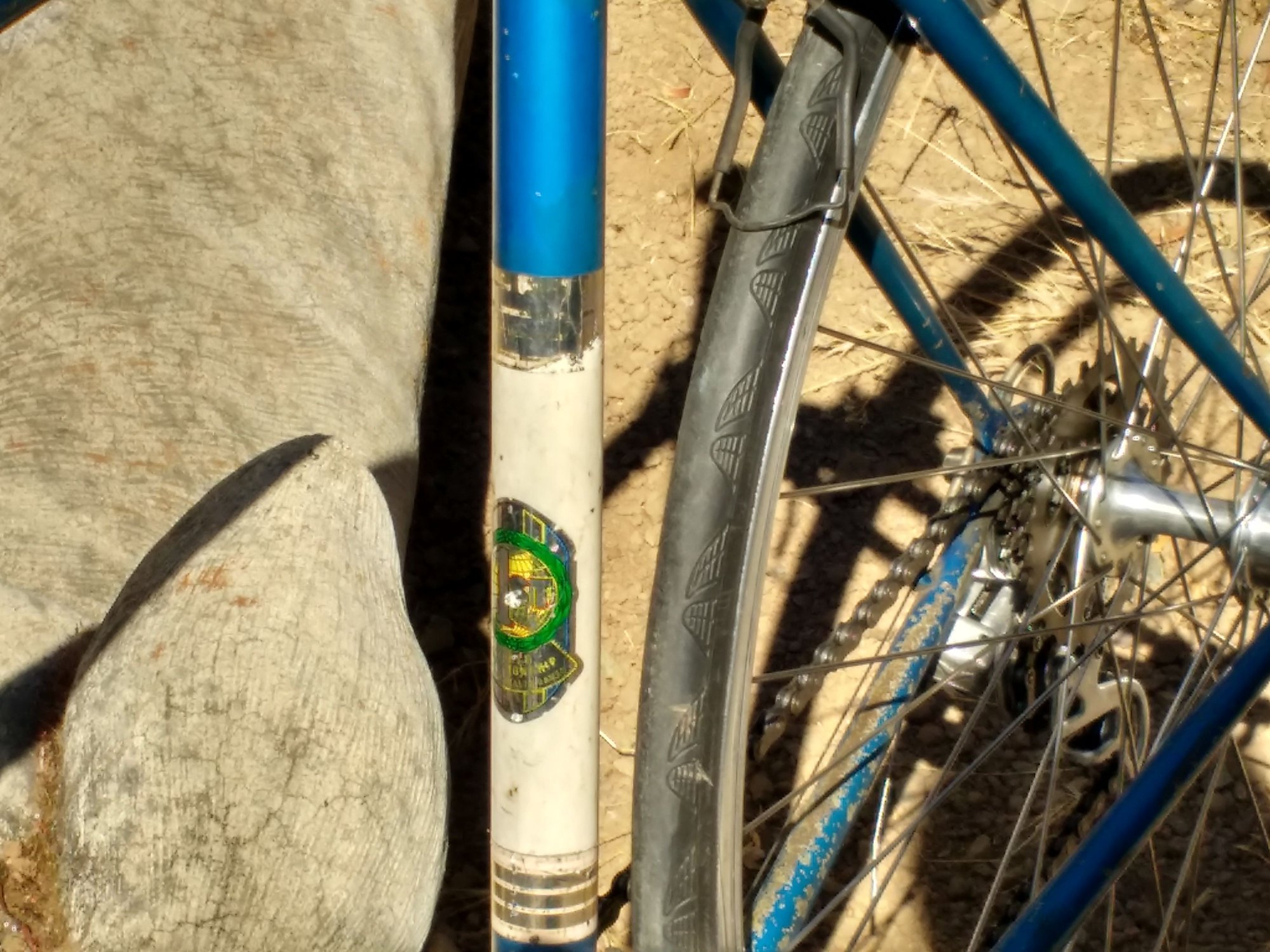

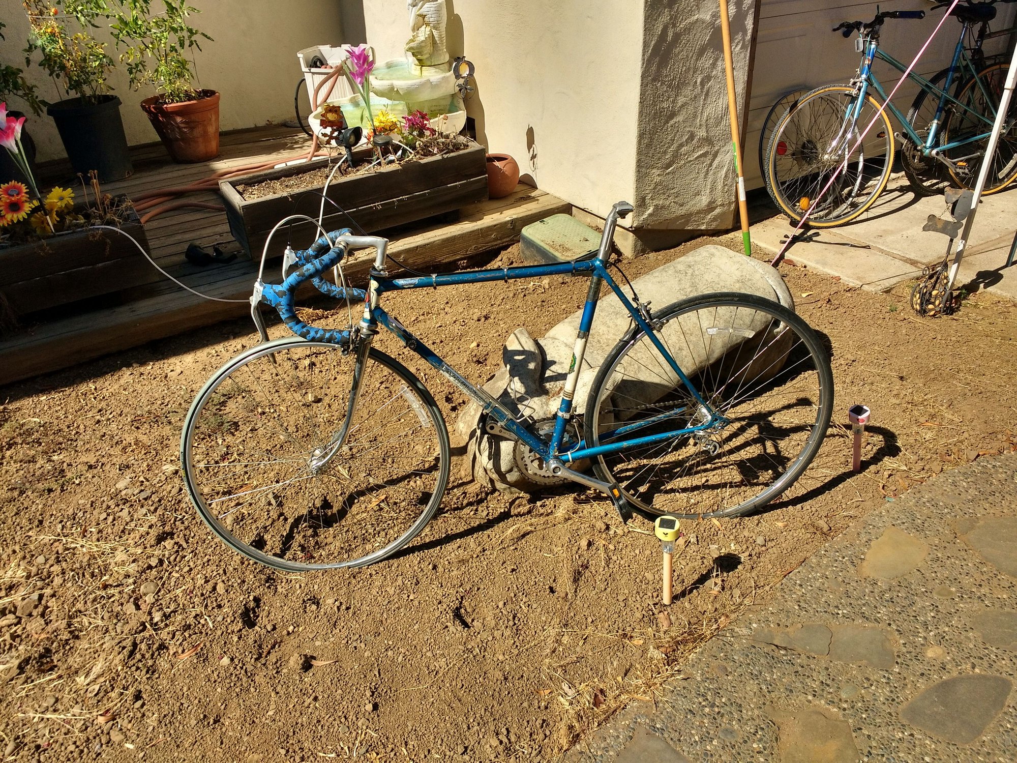

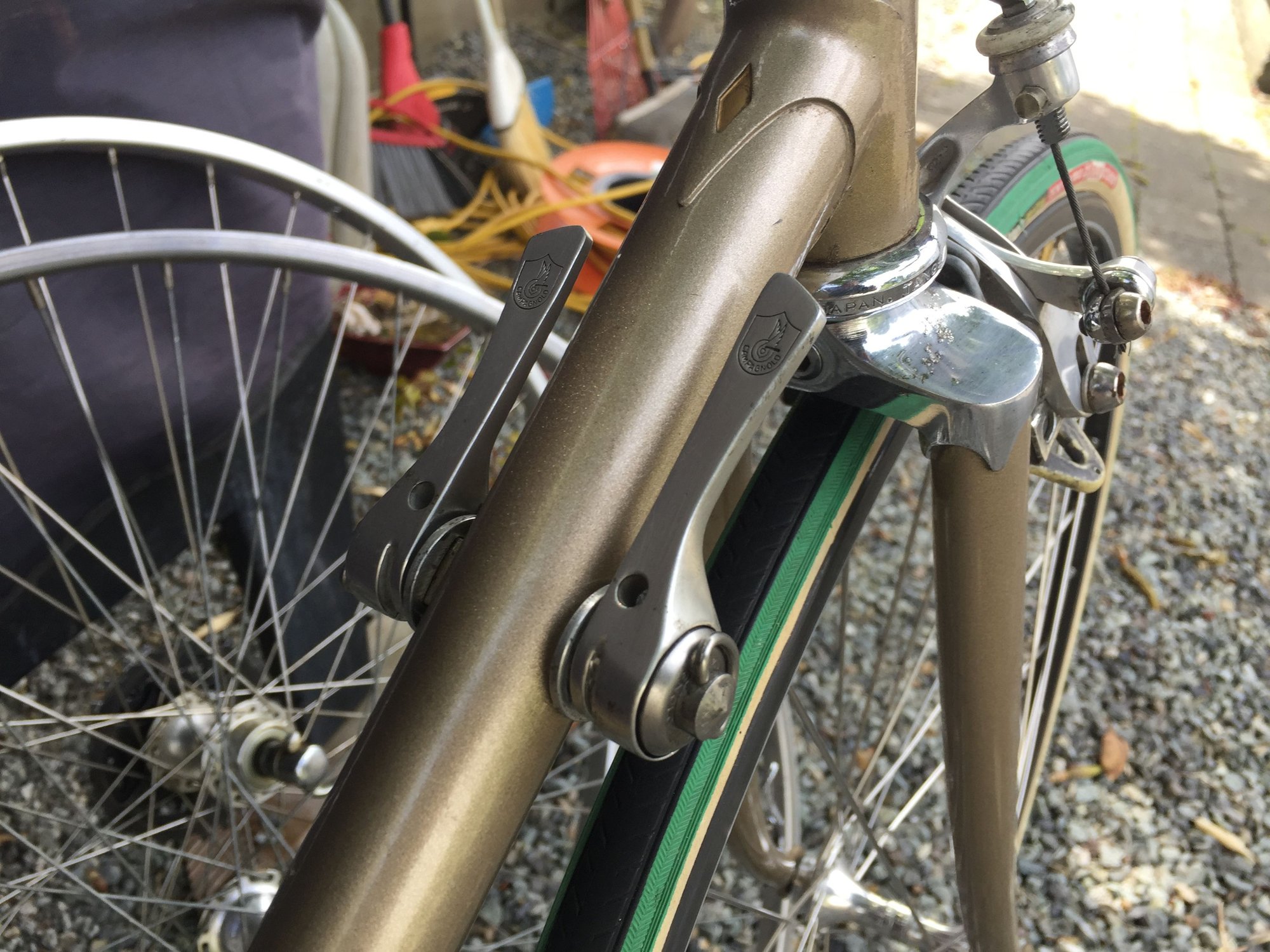

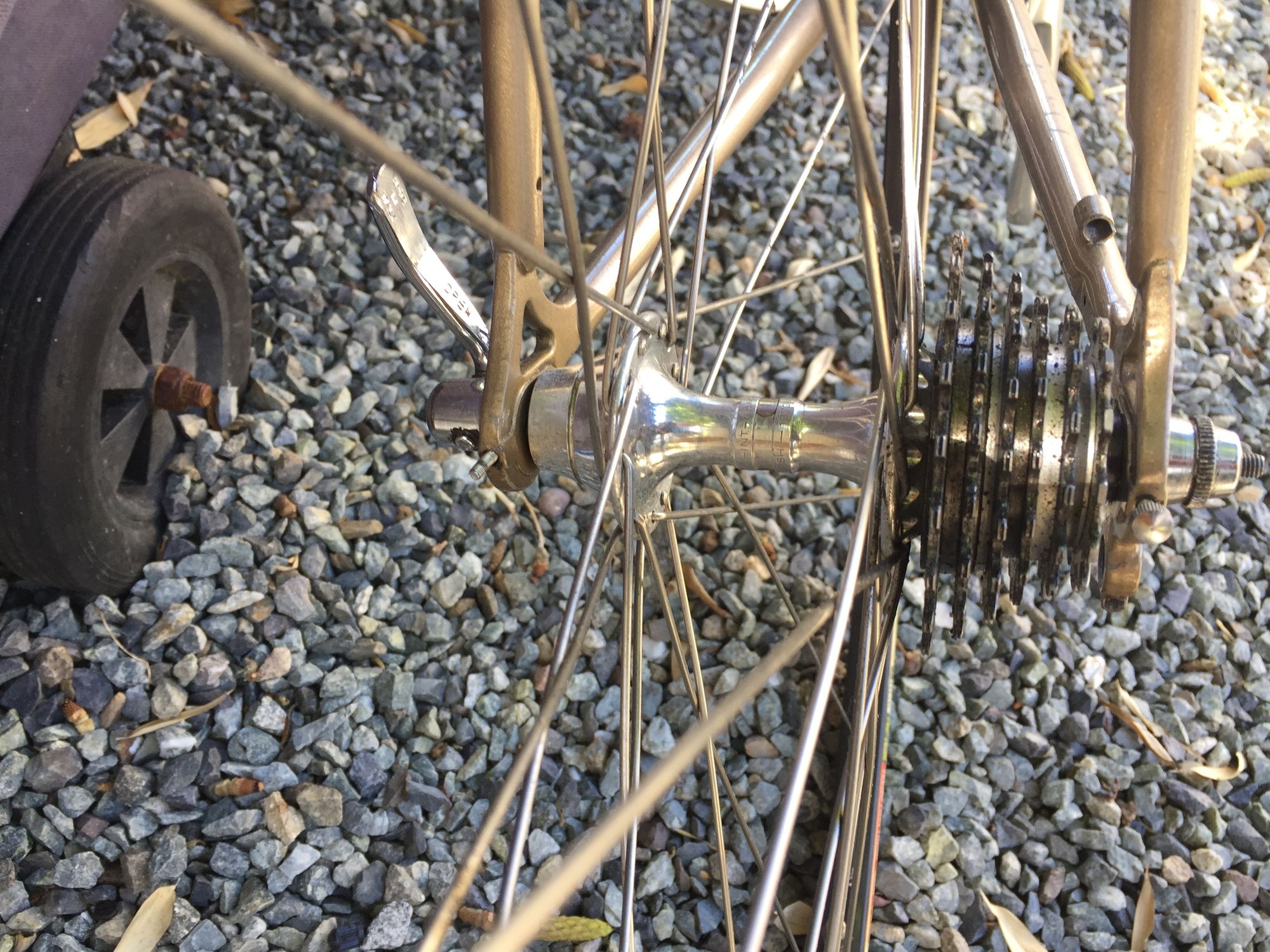

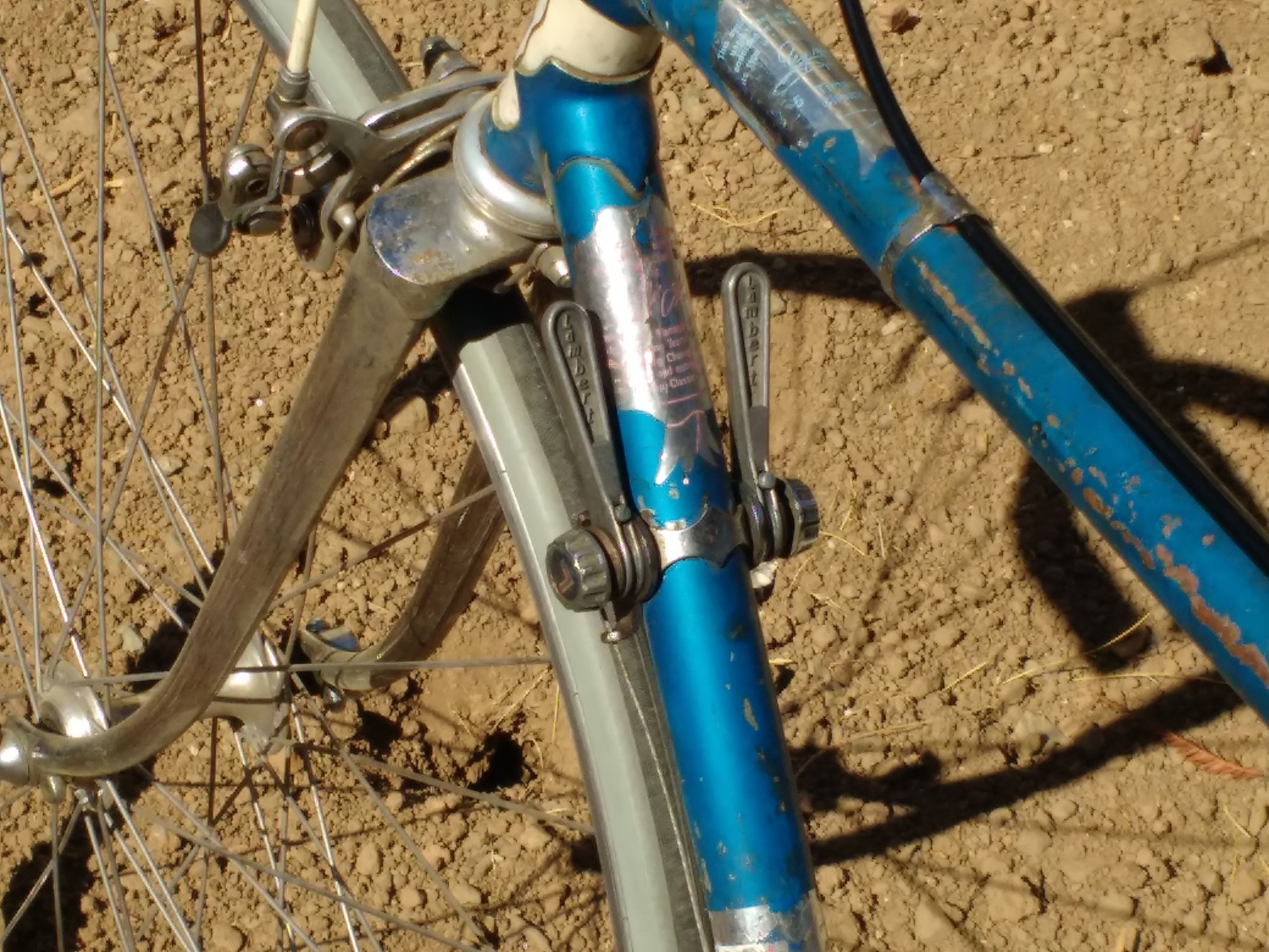

viking bike
60's Viking cycles racing bike
I love my job.
I went in to the Bike Exchange this morning to help set up for the Wednesday senior citizens bike fixing event. We just started up again last week, with extreme distancing working outdoors with a 10 person limit. I went to drop off the Finished Nishiki Mixte seen above as well as the French Mysterie bike and the 72 Botteccia I have been holding till there were people who could do quality control on them and put them somewhere safe.
As soon as I walked into the back of the shop where newly acquired bikes are stored I spotted the Viking and a nice blue Trophe de France mixte.
Obviously they had to come home with me . Here are a few snaps of the Viking . There is a Wikipedia article about the company , which was in Wolverhampton England from 1908 to 1967 , so this example is at the latest, from the 60's.
It has a mix of bits , some probably original and some definately later . in no particular order:
Suntour VtLuxe rear der. CompV front
Shimano 600 side pull brakes with Lambert levers
Lambert down tube shifters
lambert stem
shimano 600 head set
Sr seat post
Sugino VP crank
5 spd freewheel
Performance rear and Mavic front rims
Handle bars are English and ones I have never seen before.
Most of the decals are foil and barely readable . The one on the down tube says something about 1st place world championship , I think.
Anyone want to comment. What would the original equipment have been? This does not look like a high end bike but might have some value left original. I don't know. Thoughts please.

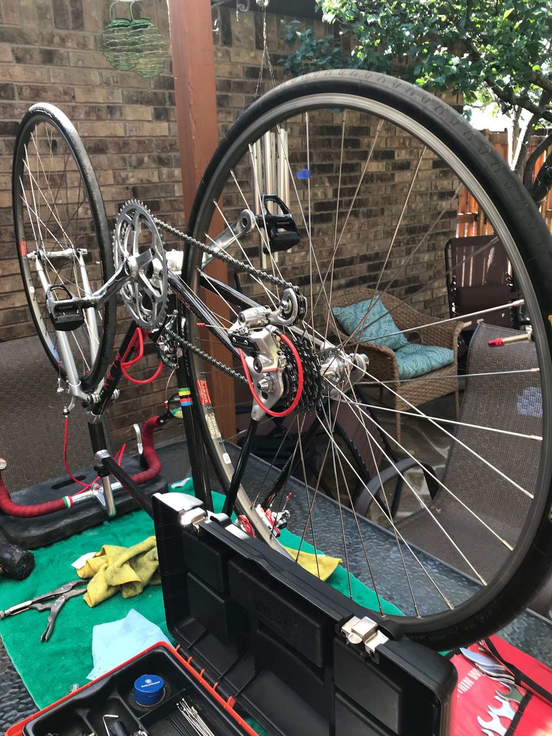

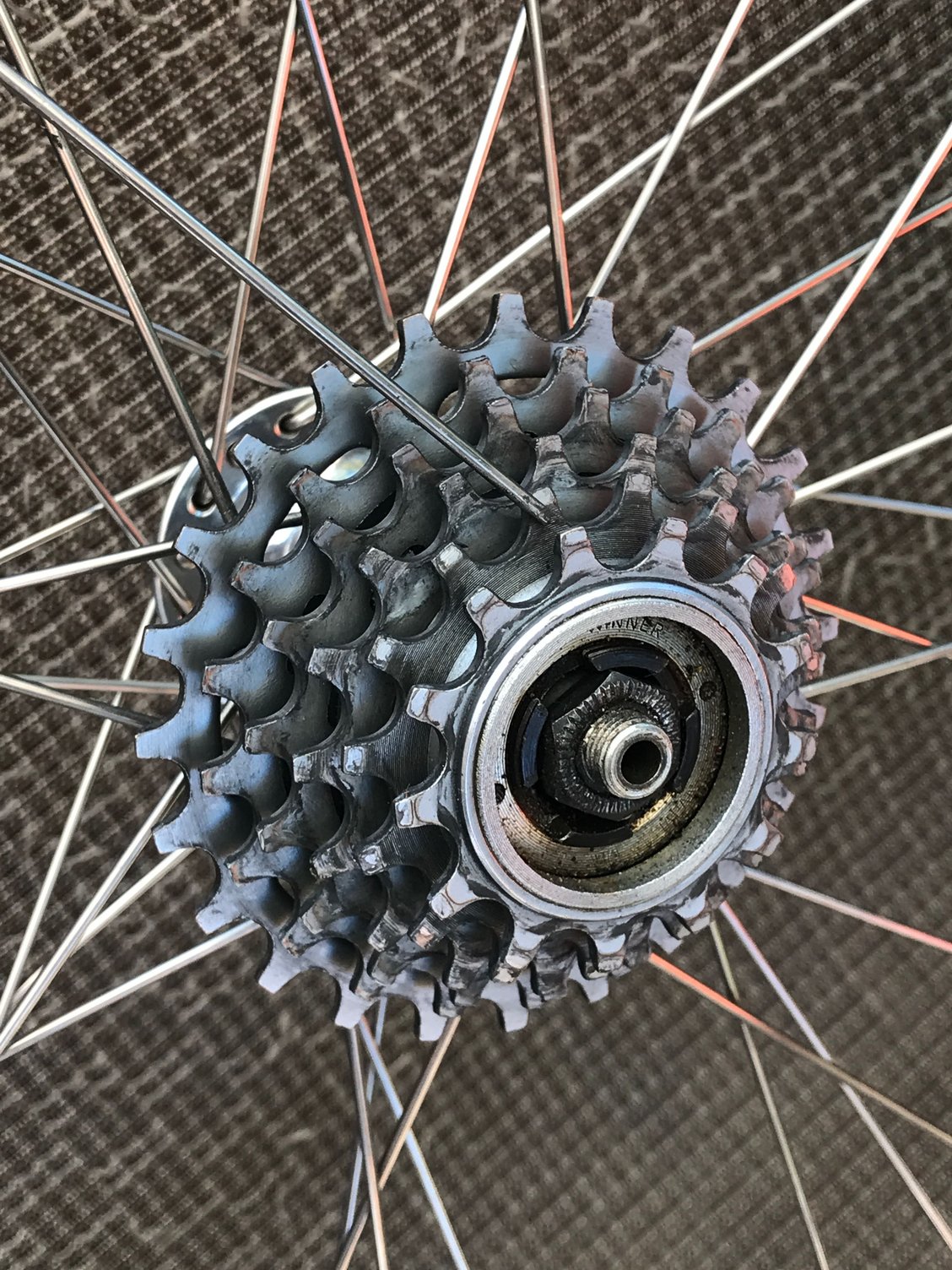

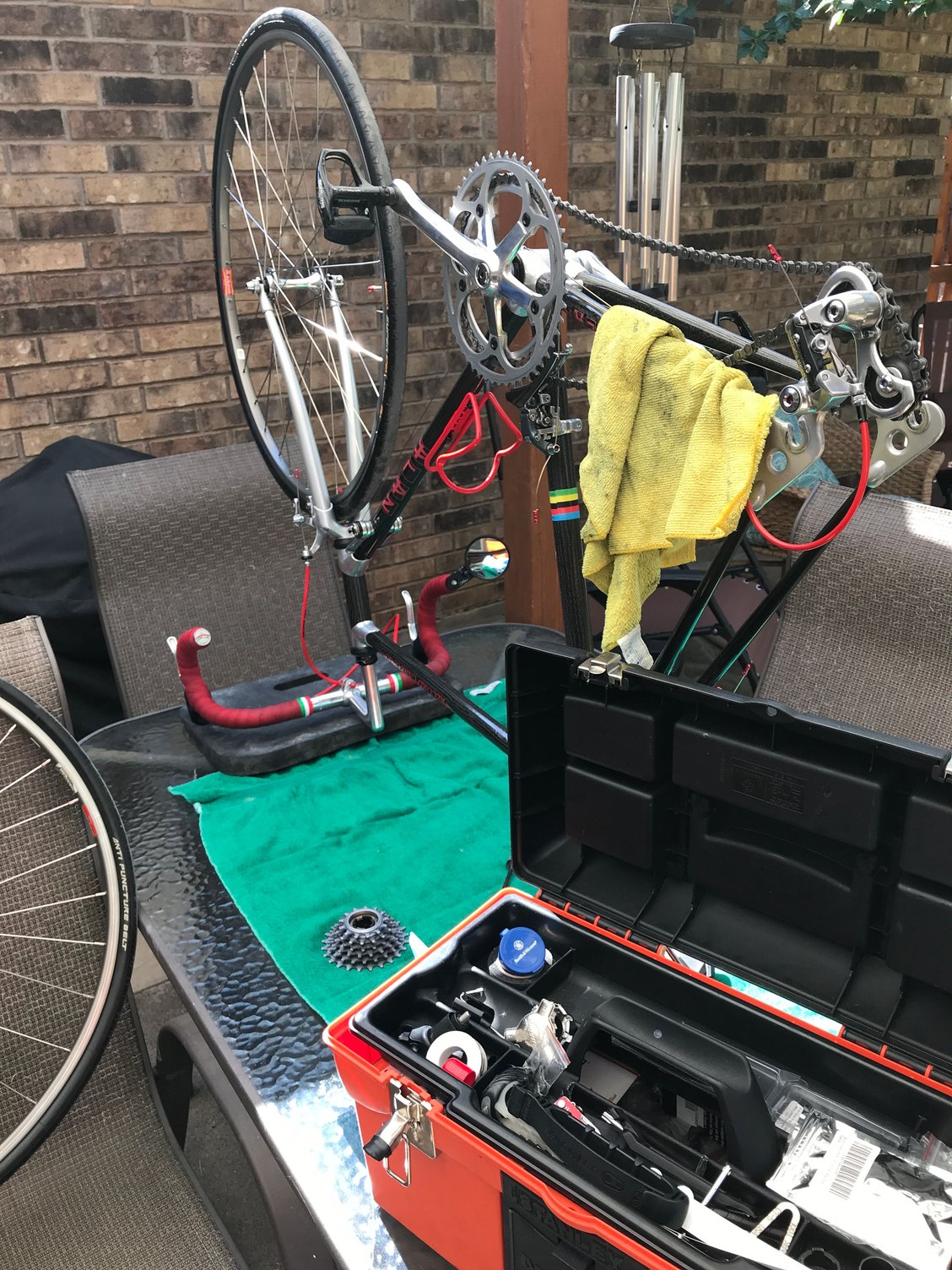

Broke Spoke ...
As Usual ... the drive side
Broke Spoke
Might as well clean up the hard to reach areas while apart
Ok, all better now.

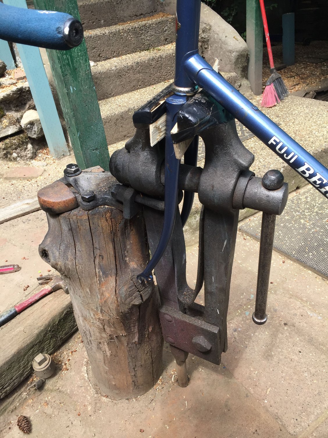

The Berk, Fuji Berkeley that had a stuck gooseneck, steel tapered cranks, bad wheels.
With the stem frozen in place I went to a friends with a more proper vice for handling this situation. Clamped the crown applied penetrates and torked the steel Nitto handle bars til they broke free.
New cup for the lower headset.
I removed 17.6 pounds of bike shaped parts.
I'll have it all together later today
Nice vise
