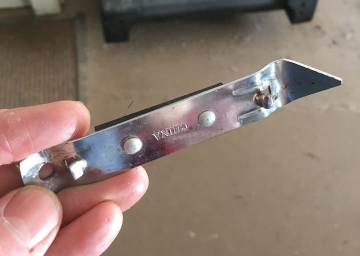

I had to do this a few days ago. I used a cheapo bottle opener to spread the stem to get it off the bars - one hand control of the squeeze and doesn't mar the edge of the stem clamp. As you can see from the edge of the clamp, I tried a screwdriver before I tried this)
