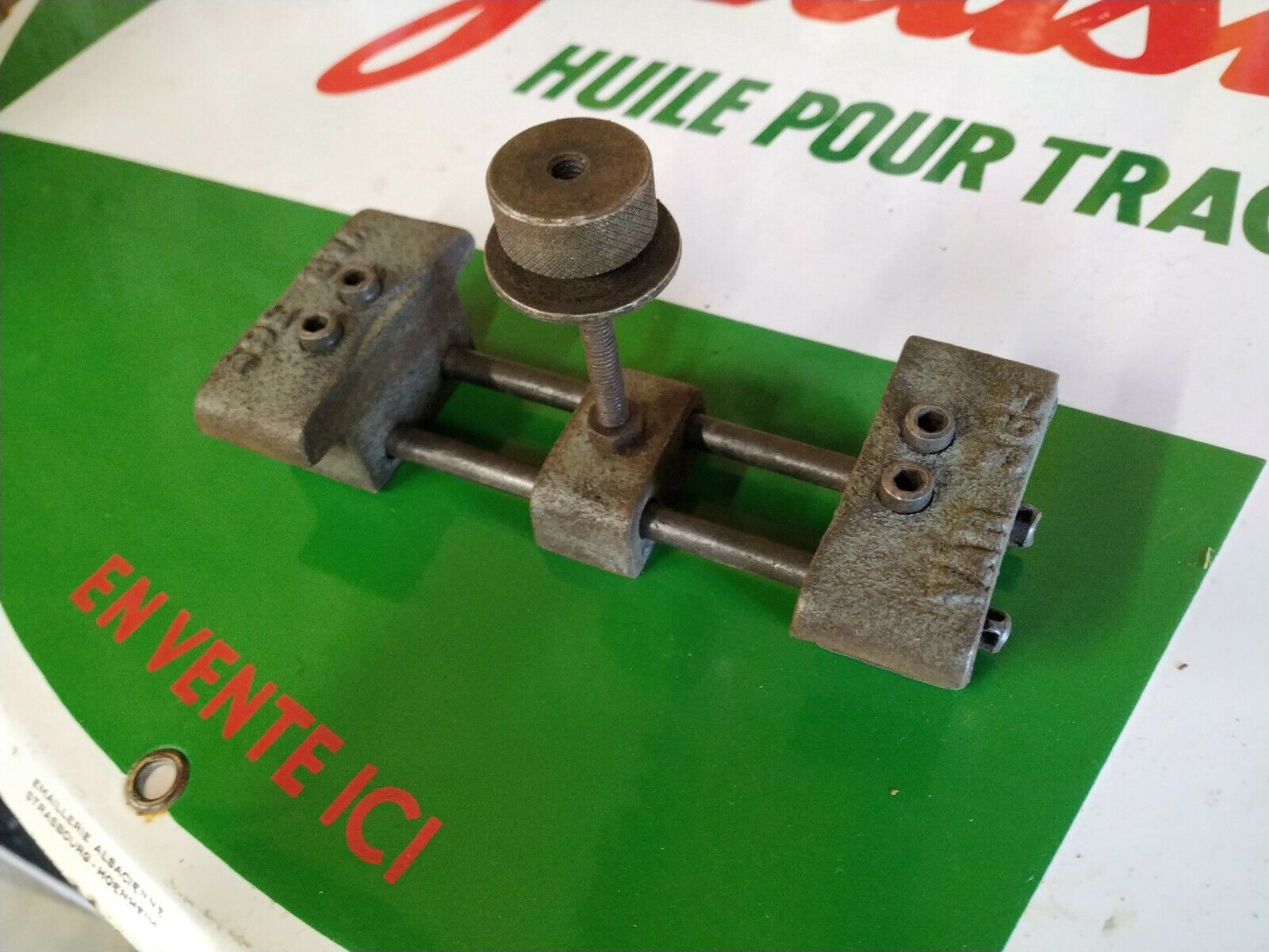

Is this the Maeda tool you're referring to?
Although I've never used it, I can see how a freewheel would fit:
It does seem to be able to do more than just hold a freewheel, but I haven't found out what yet.
Ja machen mein herr Oberst.
The semi-circular bits form an axle vise; two sizes for two diameters of axle.
Danke, Herr General!
I figured it would be something like that. Now I need to think of a reason to actually use it. It is a nice tool, BTW. Very elegant and minimalist. I like that. Very much.

Originally Posted by mpetry912 View Post
that's an interesting tool and if you take freewheels apart may be handy to have. The main reason you'd want to do that is to replace cogs, so you'll then need to accumulate an inventory of cogs.
the modern Chinese made Shimano freewheels work pretty well, they are riveted together so this tool really is not needed.
For decades I have custom built my own freewheels to obtain the ratio progressions I want. I use the Suntour tool in my bench vise, along with a chain whip -- the combination works like a champ.
Those pesky rivets in modern freehub cassettes are what Dremel tools are for. About a year ago I merged cogs from two of these "spiders" (one riveted, the other screwed) to make new 8-speed setup for my mountain bike.
John E is online now
Old 10-17-19, 01:32 PM
scarlson
scarlson's Avatar
Location: Medford MA
Posts: 810
Bikes: Ron Cooper touring, 1959 Jack Taylor 650b ladyback touring tandem, Vitus 979, Joe Bell painted Claud Butler Dalesman, Colin Laing curved tube tandem, heavily-Dilberted 1982 Trek 6xx
Quoted: 354 Post(s)
Liked 390 Times in 235 Posts
...for a long time I thought it was crazy to do all the work of changing out cogs on freewheels. That was when they cost ten bucks, and there were plenty of 5 and 6 speed close ratio freewheels available for purchase new. then there was a period when I could still find the smaller 5 speed ones with a 24 tooth largest cog in the used parts stream over at the co-op. So it still seemed like more work than I was willing to do.
Now the supply has grown thinner at the co-op, and they're selling for prices in the ridiculous range on e-bay. So it seems less crazy to me to have a box of old Suntour and Shimano freewheels to strip for usable cogs and to mix and match them to repair my old ones where one cog has gone bad. Fortunately I have one of those BSR tools, which works well as long as you also have a MAPP gas torch to apply some heat and a can of CRC Freeze Off. The majority of those I have worked on did not come apart easily.
This is so true. And of course all this is doubly true for French-threaded freewheels!!
