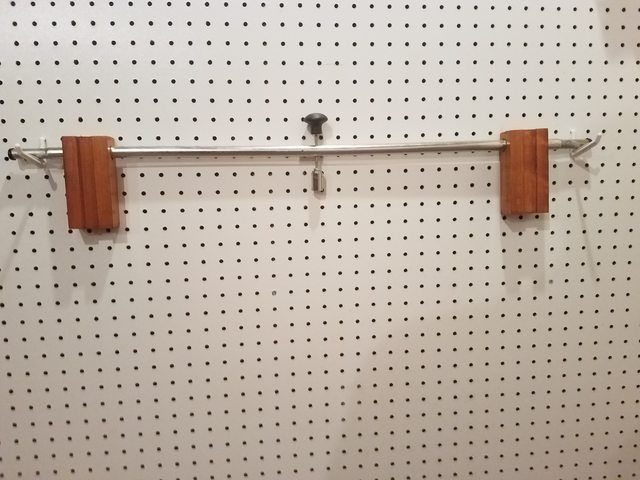

$0 - Crap on hand -- 2 pieces of scrap wood, an old socket, a nut, a piece of threaded rod, a drawer pull and a tent pole section from a defunct tent.

Also made with scraps on hand.
AlmostTrick is offline
Likes For AlmostTrick:

Originally Posted by AlmostTrick View Post
This is very cool, and I also have most materials on hand.
Thanks for sharing the pic...
