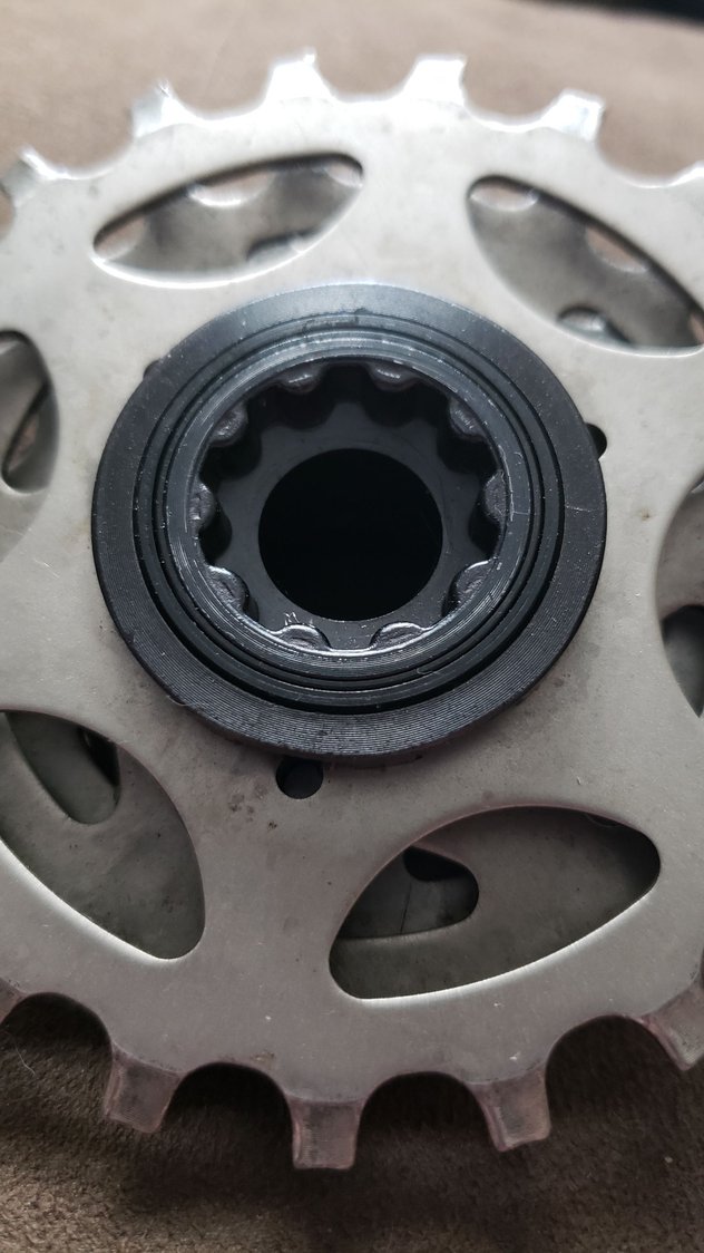

I recently picked up an 88 Ironman Master that I want to make some improvements to the gearing. It currently has a 12-21 cassette and I want something more like a 12-28. Apparently these originally came with a 13-24 so it may not be original. The hub is an HF6400 on a Mavic MA40 rim so I know the rim is not original. There's no name on the cassette, just 7s L1 on the smallest gear. This is my first dealings with a cassette, all my bikes use a freewheel. What do I need to look for in deciding on a new cassette?

That cassette doesn't look like anything I've seen before. If it's Shimano compatible this will work:
https://www.jensonusa.com/SRAM-PG-73...QaAgROEALw_wcB

Would the 6400 tri color Rd handle a 32 tooth?
The pic of the back of the cassette doesn't look right so here's a better one.
76SLT is offline

Looks like you removed the whole free hub? The cassette slides off of that free hub, so you can leave it on the wheel
It appears you removed theUniglide freehub body along with the Uniglide cassette cogs. You need a pair of chain whips to loosen the first cog or two then the rest just slide off.
If it was my bike and the wheel was in good shape I’d find a good used 7spd Hyperglide hub and transfer that axle set and freehub body to the wheel. The 7spd Hyperglide cassettes are easier to source

You're all correct, I removed the whole hub body from the hub. I removed a cassette before but there was a lock ring which this one does not have. Do I need to use two whips to remove the first cog? I only have one. Is there another way?
So this one is a Uniglide?
You can do it with one chain whip if you've got a bench vise. You can just clamp it in the vise & use the chain whip. Or, clamp a sacrificial piece of chain in the vise & around the cassette & use a chain whip.
I'll give it a try, thanks. I've gained a better understanding of what I have and what I need thanks to the help here. I think I'll probably take Bianchigirl's advice and replace the hub.
But just the freehub body and axleset yes? unless the bearing race on the left is worn.
If it was my wheel I'd use something like this to harvest the freehub body and axleset https://www.ebay.com/itm/Shimano-STX...0AAOSw74xdw6cJ

Is the RD A 62 series or 64 series. If you go to the IM thread, i put some how to guides there about how big of a rear cluster a 62 series RD will shift. I started the how to guides about the time the virus started shutting down. There should be info there to answer all of your questions.
The rd is a 6400. I also have a 6401.

A 640X RD will reliably shift a 28 tooth cog; I would not advise going larger unless using a Wolf Tooth extender.
There are 12 tooth UG first cogs out there but they are rare and relatively expensive.
Agree that installing an HG freehub will make it easier to find the cog sizes you want.
