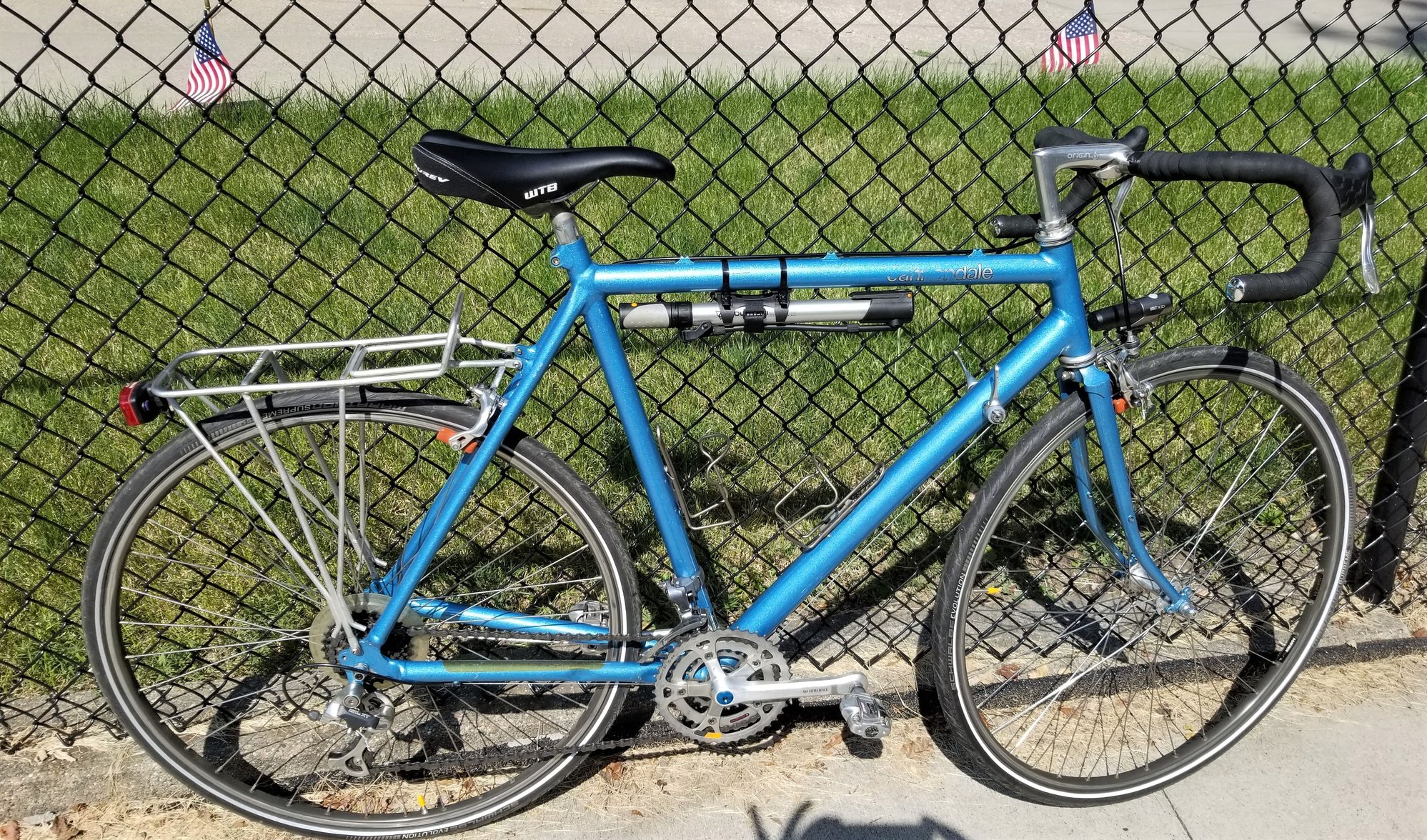

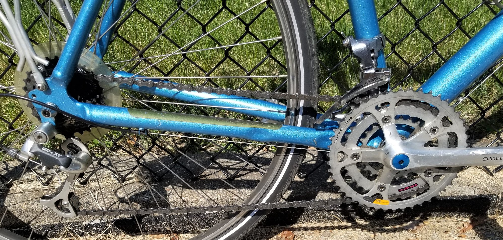

I bought this bike used, from a guy who used it in endurance rides, including RAAM
...it's pretty much a stock Cannondale tourer from the steel fork era. He had it set up with skinnier tyres, but I couldn't take the road shock without more cushion. With the exception of the tyres and the fenders, everything else is how it came from him. His alternate bike for the RAAM was a custom Spectrum titanium frame. The wheels are built with Phil Wood hubs.
The Merckx Century bikes are probably a good model for geometry, if you're looking for one to follow.
