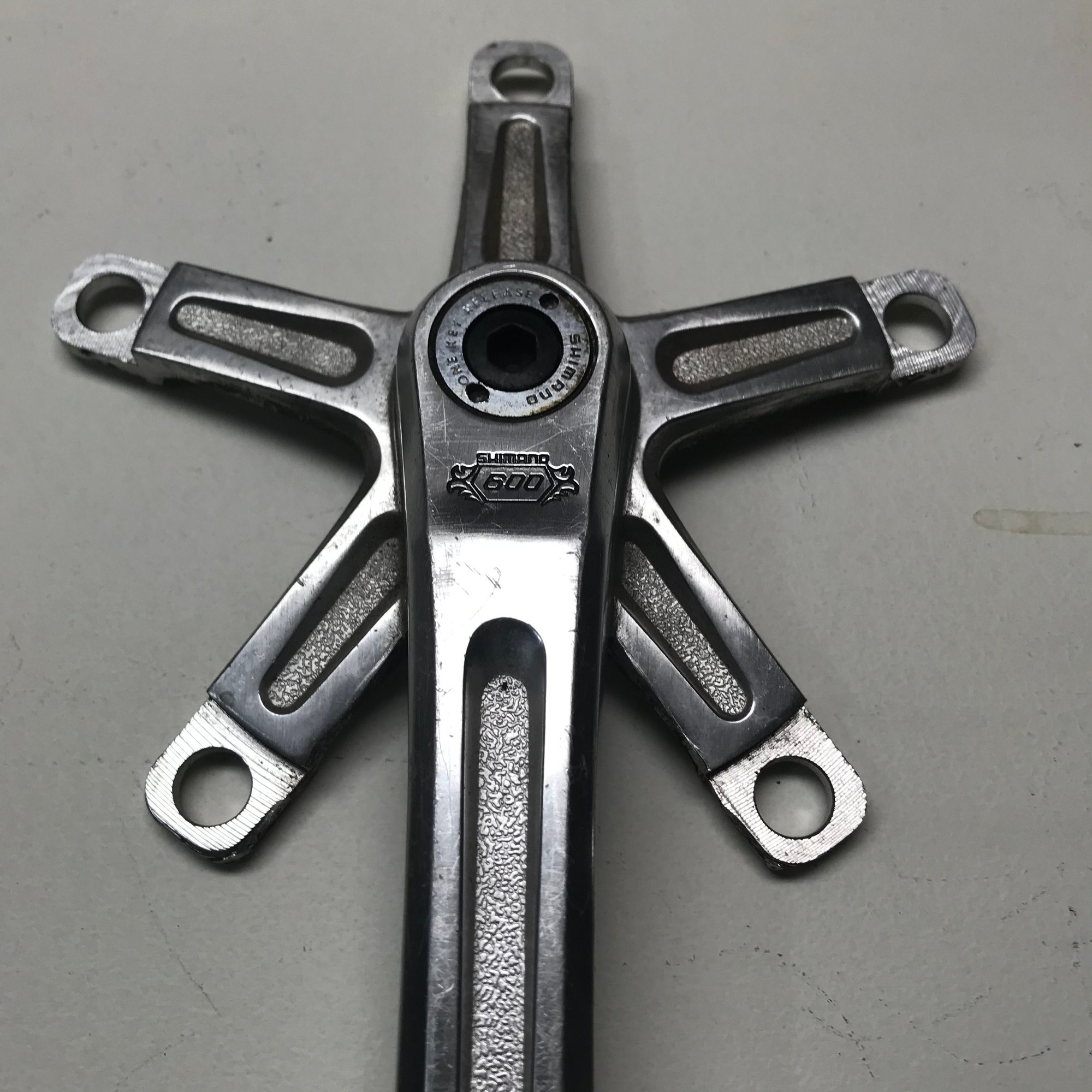

For fragile finishes like anodized aluminum, I like to use NEVR-DULL wadding compound and then a micro-fiber cloth to buff it out. LNKFixed , I'm pretty sure the lettering was printed after the anodizing process so go lightly over it with whatever you decide to use.
Regarding that "Ultimate Aluminum Polishing" thread, it's pretty wordy but I didn't find a silver bullet. After years of experimenting with buffing wheels and compounds, I've found the safest and most efficient way to buff raw aluminum is a soft wire wheel mounted in a slow speed arbor, then a polishing compound, then buff with a micro-fiber cloth.
Likes For branko_76:
Posts: 1,745
Quoted: 701 Post(s)
Liked 667 Times
417 Posts
btw, LNKFixed , if you can let go of the lettering, you can make those crank arms look better than new.
Here are a couple of Shimano cranks, the 600 has the original anodized finish, the 105 was badly scratched so I used fine emery cloth to remove the scratches (and the anodizing), buffed it with a soft wire wheel, then NEVR-DULL, then micro-fiber cloth as I previously described.
600 crank with original anodized finish
105 crank after finish was removed, buffed and polished
