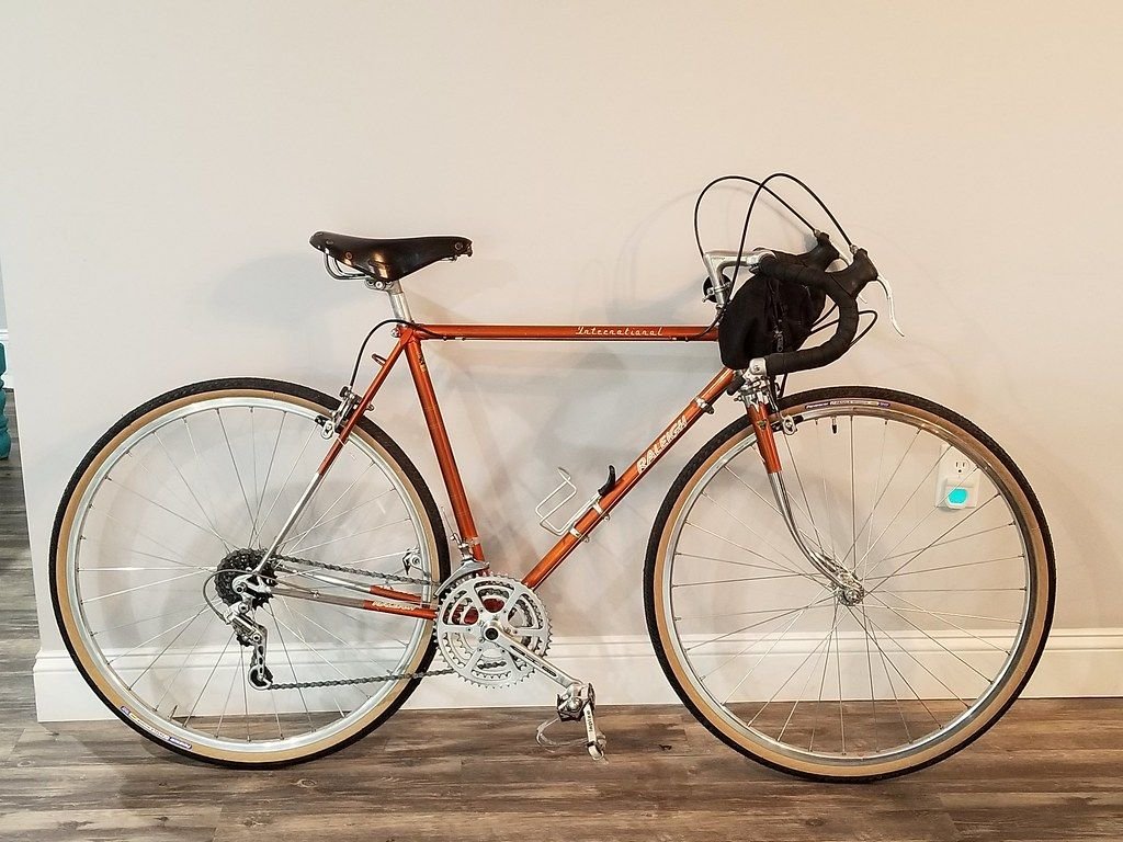

In it's current build it could still handle the rough stuff, running an 8-speed internal gear hub. It's optimized for urban commuting and errands, but the OP did show at least one upright build.
Many moons ago I re-imagined an early-90's Ross hardtail as a road warrior. It was a fun ride that I gave to a friend when I moved from the 'burbs to Manhattan.
Pretty sure that's the same Blackburn rack that's on the International now.

USAZorro -
Those old Raleighs you have are just beautiful, and what you say about 70s Sport Tourers being a sweet spot in terms of weight vs handling sounds very reasonable. If my intended use was for putting in more miles, I think those would be a perfect sort of retro gravel bike.
A bit more info: when I was in college, I commuted to and from class on a Schwinn High Plains from around 1991, which at the time was still a very old bike. I couldn't have cared less about bicycles at the time, but I still remember how beautifully springy and compliant the ride was with the steel frame and big mountain bike tires. For the short distances I was traveling, it was perfect for navigating around obstacles, cutting across paths, bunnyhopping up curbs, etc. Since the trails around my house are of a similar distance and type, I think the comfort and agility of a vintage MTB may be the ticket. I also just discovered that we have a moderately technical single track trail right near my house, which makes me lean in favor of the mountain bike rather than the 700C-based hybrid.
https://bikingtoplay.blogspot.com/20...onversion.html
I'm sure the author will appreciate it since I stole his picture after all.
Likes For c0rbin9:
