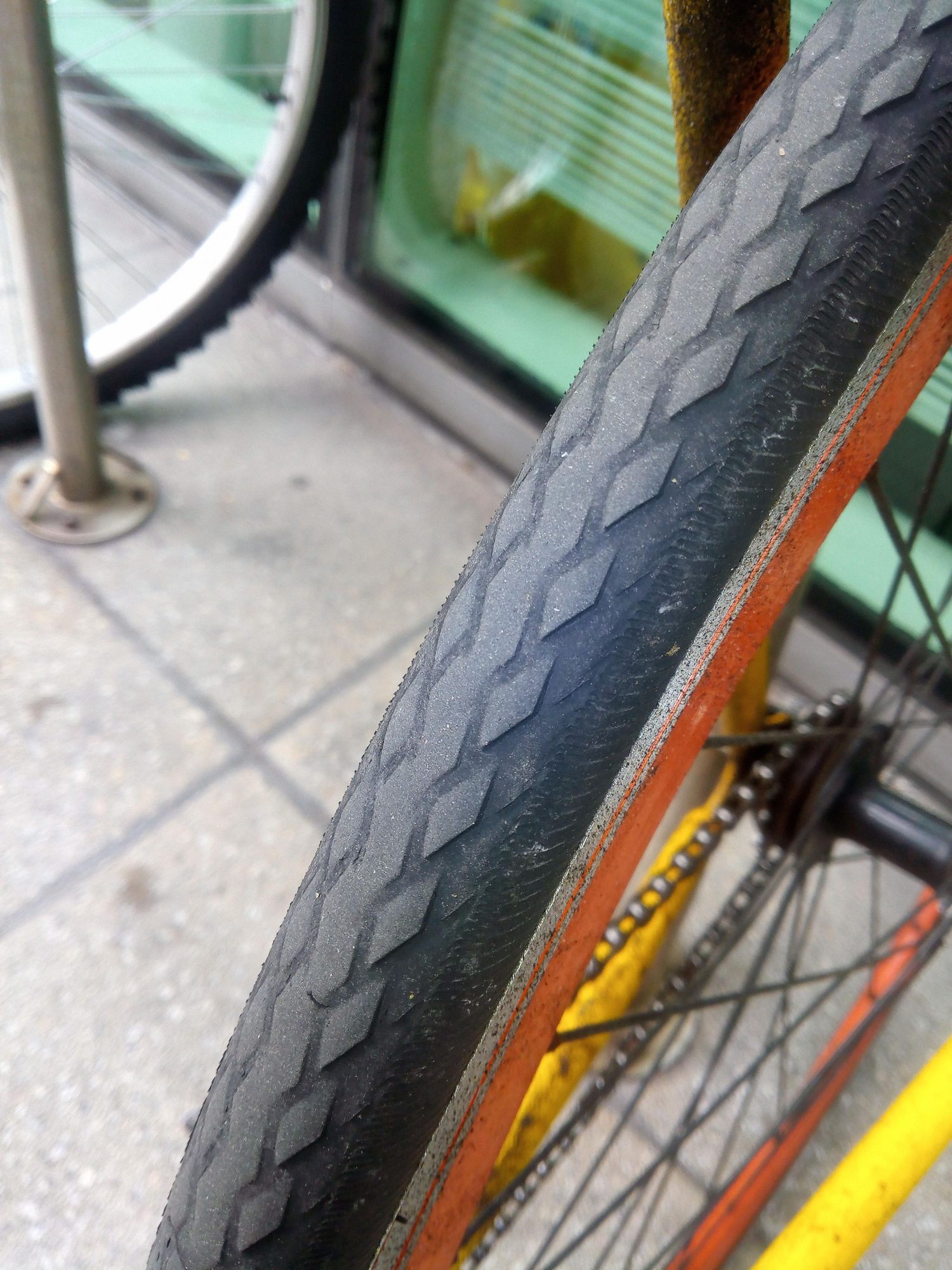

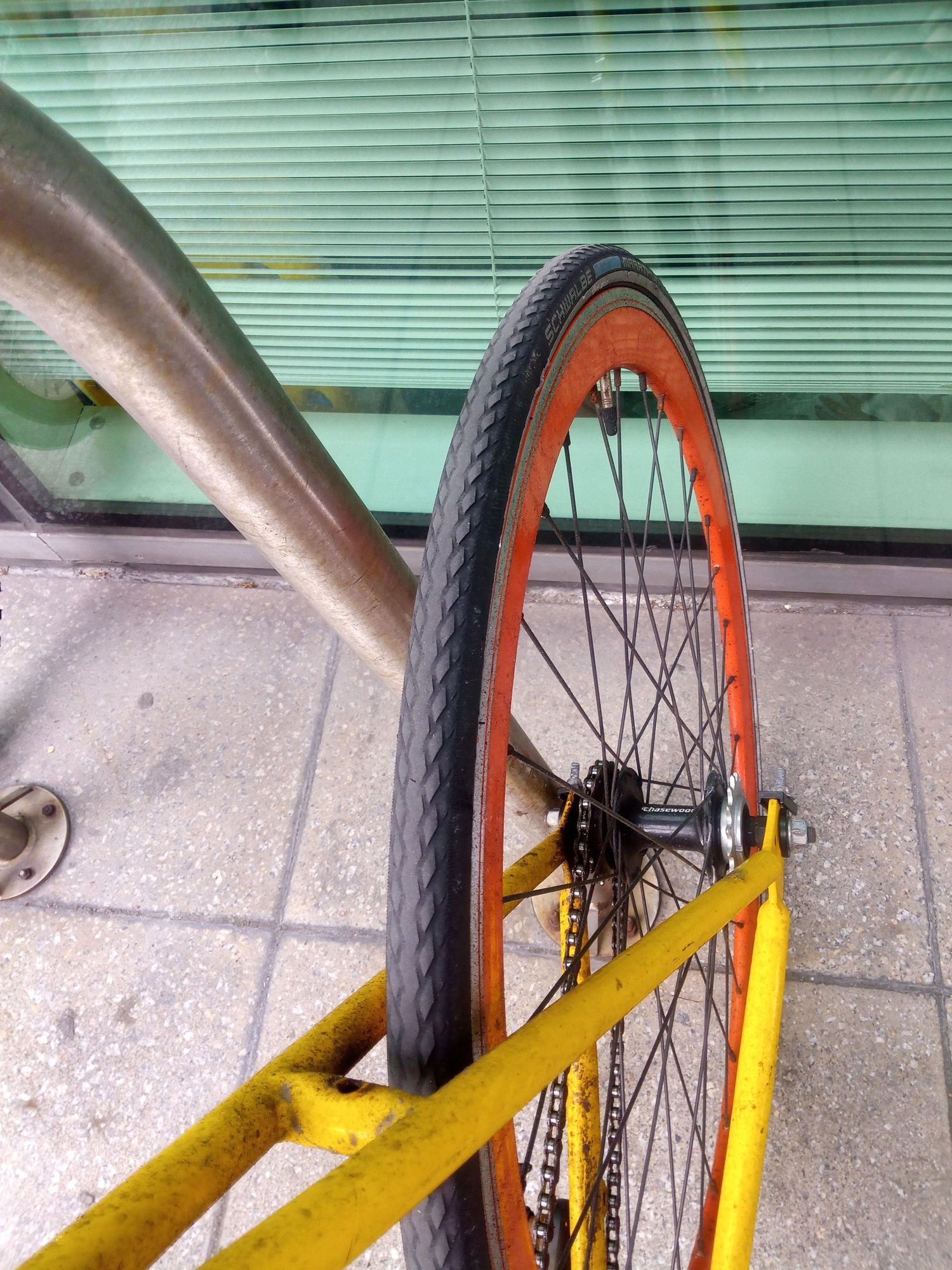

Here we go, in the work bike rack.
Schwalbe Marathon Original with Greenguard (HS420)
installed on 26 MAR 2015
cost: £19 shipped to my door from amazon
distance travelled: 1899km/1174mi
synopsis: greenguard has stopped several pieces of glass/metal from getting into the tube. have still had a few tubes get flat. One when I wa run over by a van and bent the wheel (the tyre was reused) and one in a different accident with a parked car.
I am a little surprised by the tyre wear for that short distance of usage.
How does this compare to other people's wear?
