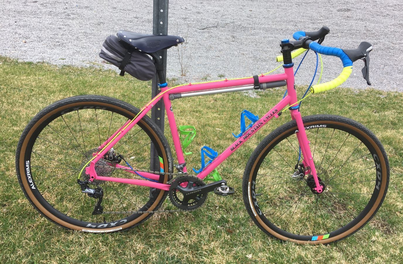

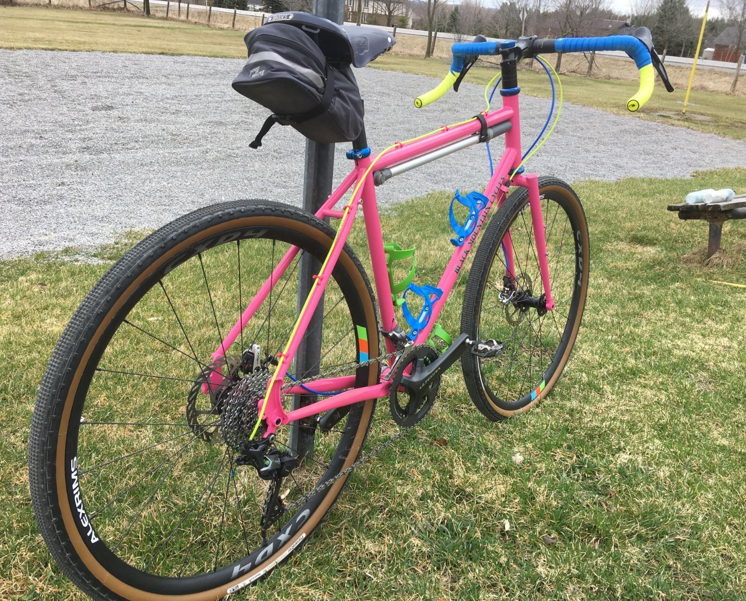

Mine is finally done. Got the frame couple of weeks ago, remainder of the parts came last week, only fenders left to install (they are in the mail, Honjo 62mm in black from SimWorks). Did not decide on the rack/bags yet. Love the bike, build below was just under 23lbs with tubes, runs tubeless now. 53cm, I call it Mr PeptoBismol (great match to my pink All-City Mr Pink). Very comfortable, fast to accelerate, keeps the speed without much effort, climbing is good sitting or out of saddle, handling is predictable and not slow, just right. I run 40psi at the back and 35 in the front.
46/34 Ultegra 6800 cranks, Ultegra CX70 FD, Ultegra RX 8000 RD, SRAM 11-36 cassette, 105 5800 brifters.

Inside distance between fork legs and between seatstays is around 70mm
Will figure out when they arrive 😀 I did measure and they should fit plus I saw BMC Road+ with the same fenders. Little bending may be required, especially around FD and chainstay yok but should be OK.

Please let me know how the fenders fit, what finagling you had to do, etc. What tires do you have on there now? Great build! Congrats.

Sure, I will post update when they are installed. Right now I have Panaracers GK SK, they measure to actual ~42 and change on 19mm internal width rims. Plan is to get ~45-40mm tire eventually - I'll have to see how much space I will have under fenders.

I think you will be OK with triple. I'll make sure to post detailed pic once fenders are on
