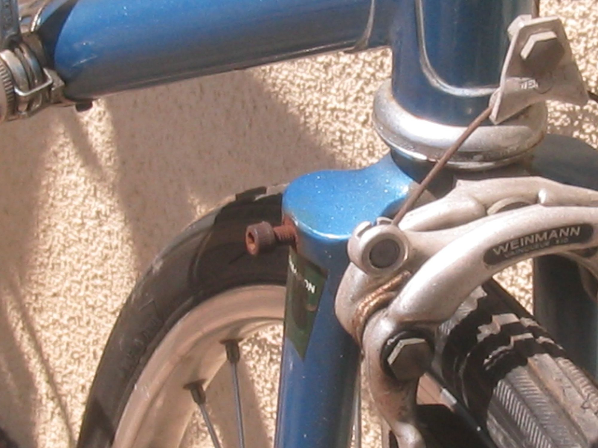

Fork Crown
what is the reason for the bolt on the crown, is there one on both sides?
Betty Swollocks is offline
Old 09-12-18, 08:14 AM
Andrew R Stewart
Andrew R Stewart's Avatar
Join Date: Feb 2012
Location: Rochester, NY
Posts: 13,803
Quoted: 2505 Post(s)
Liked 578 Times in 443 Posts
Racks can attach to these crown bolts. The above photo shows a small rack supporting the bottom of the bag. In this case the rack attaches to the brake pivot bolts though. Other racks can mount to the crown. TA was a popular brand rack for handle bar bags, when this bike was made. While I never liked the look of the crown mounting bolts it is a strong location. This is one more example of the skill and knowledge the frame builder had back when the interweb wasn't even a dream in Al Gore's mind. Andy
