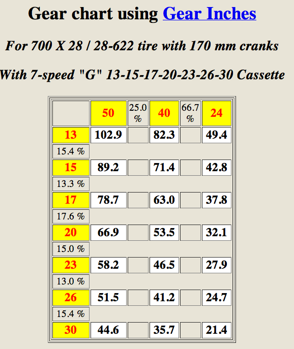

46/30 with a 34 in the back for touring? No go for me. Went with a 26/36 with a 42 in the back, 2x11 sram on my new bikepacking build. Surly Krampus, works well. Don't use drop bars on my tours stuff anyway.

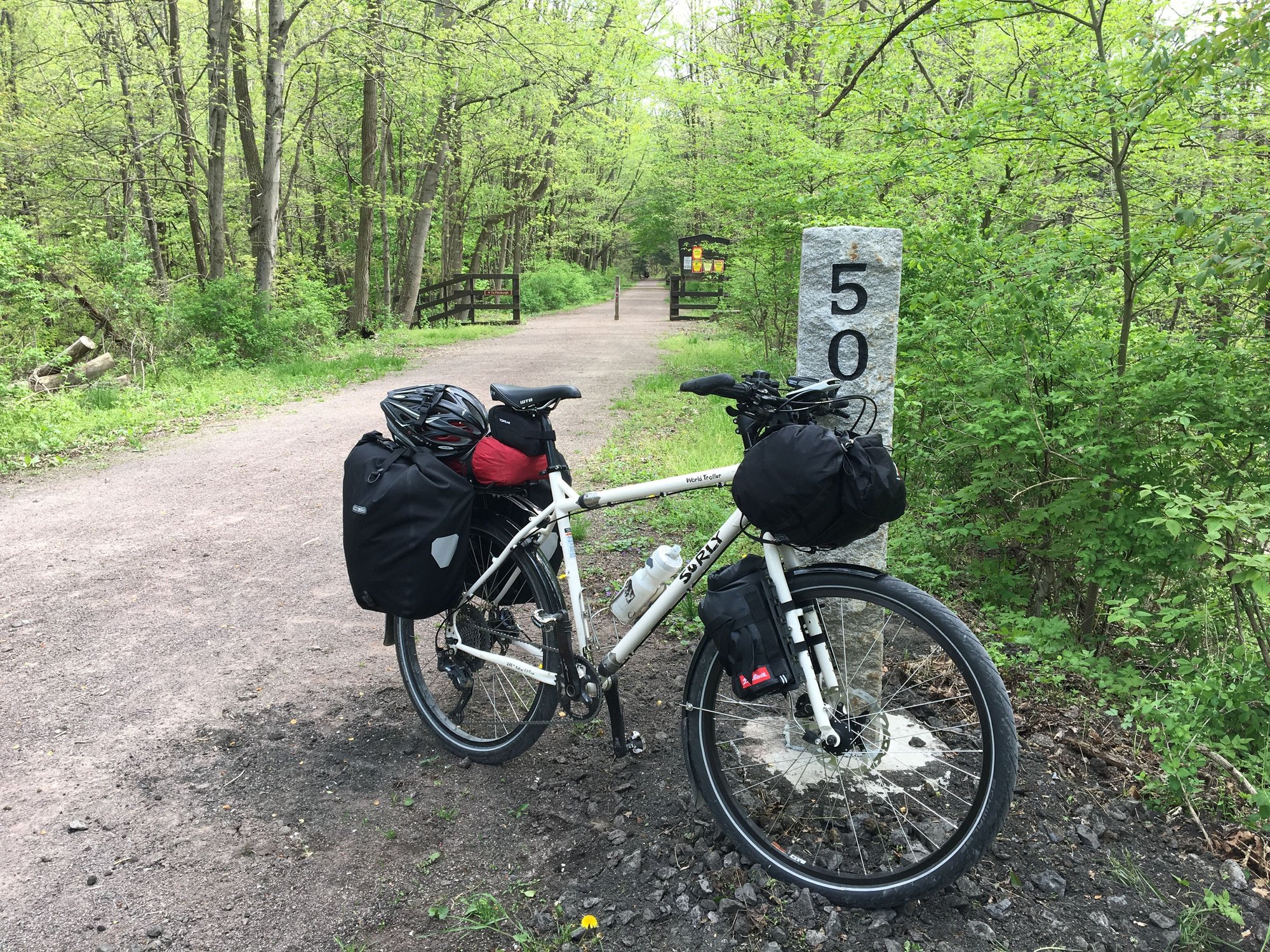

On my relatively flat most recent trip, I went with 1x11. The chainring was 38 and the cassette 11-46. I used the lowest and highest gears frequently enough to justify the range. 21.5 to 89.8 gear inches. Really liked the 1x setup. For a more typical tour, I’d go with a wider range.

That said, I'm still not really sold on the idea of 1x or even 2x, but just wanted to point out that your 1x setup is still a very useable setup, and comparing it to my old bike that I toured on and had a great time and was able to climb all kinds of hills, shows that your setup is still perfectly useable.
It will be interesting over time to see how chain life is with the diff 1x and 2x systems, 10 and 11 speed, and yes, cost of stuff to first put on a bike, and to replace chains, especially if there is a significant lower chain lifespan going on.
Ive used about 5000kms as a ruler ish for chain life for me, for the last many many years, thru the 7 to 9 eras.

I guess because I come from a triple background, I wonder how real life cross chaining is and how it affects chain life. I realize a double must put less chain angle than a triple, but I do wonder if chain life is a lot less than with older systems and triples where the chain is simply going to be a lot straighter most of the time. I guess we could also touch on the whole chain life/strength thing, ie are 10 and especially 11 speed not as strong as 8 or 9.
My guess is that Shimano shares some of your concerns. I also think they realize that some will push the boundaries of what's possible and are trying to put up guardrails.
Anyway, it is blocked in software. When I upgraded from 6870 to 8050 shadow/clutch, those two gears were simply gone.
-Tim-
