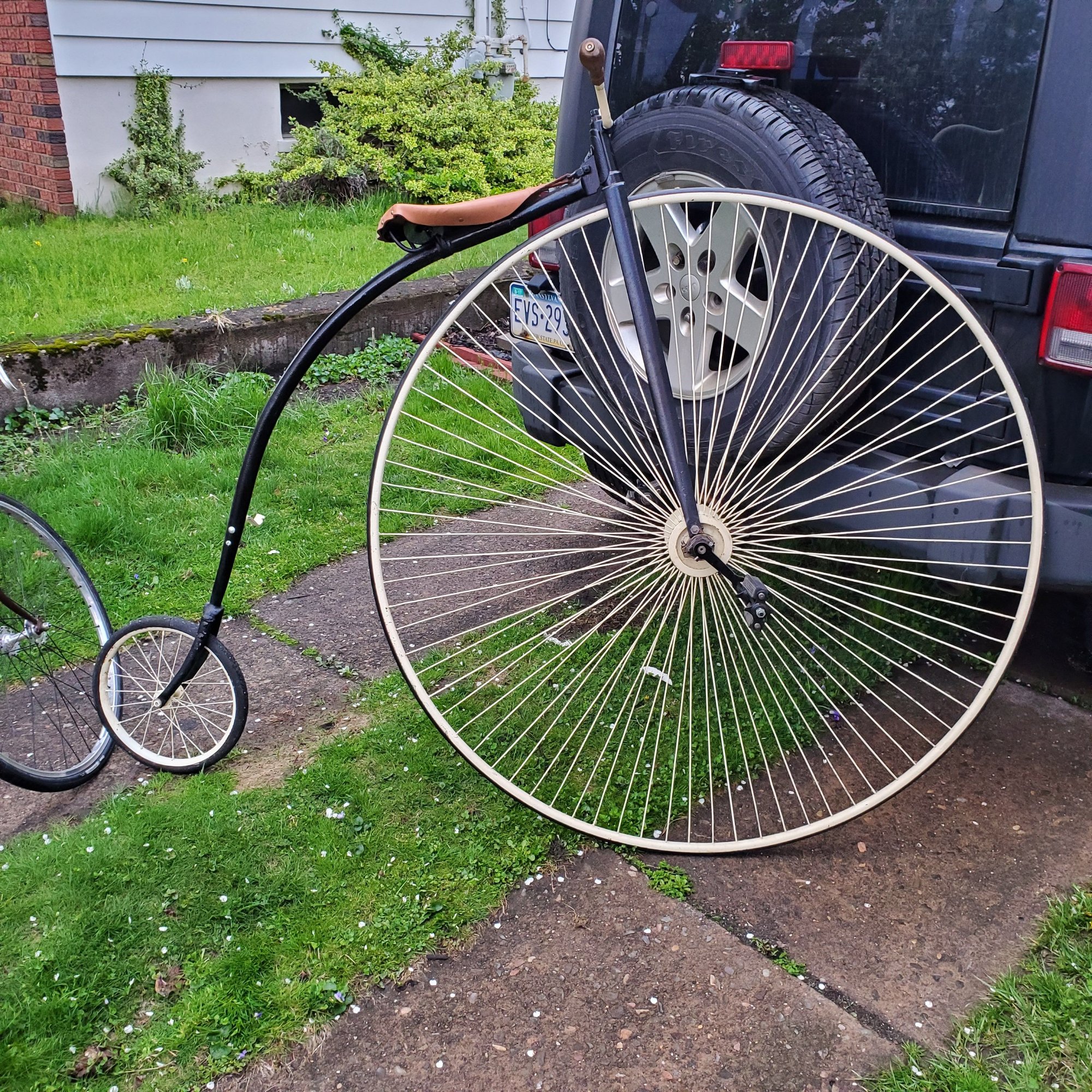

Im hoping someone can identify this penny farthing bike. I dont know anything about it other than the front wheel is 52". I do know grandfather rode it in parades when he was a mason, that was approx 60 years ago. Not sure if it was purchased new then, or if it was sitting in the masonic lodge he was a member of. The grips appear to be rubber or leather?

It almost looks like my Rudge roadster. That brake is very unusual, but very cool. Look at the bearings on the front hub. Does it have any markings there? And are they ball bearings or s bushing?
Here's a close up of the bearings. I dont really see any markings since it appears to have been heavily spray painted. Also a closer up picture of the brake. Was that brake a stock feature or did someone rig that on there?

I'm not familiar with bikes this old, but I think anybody making reproductions in later times would use some contemporary components in the build and not bother with things like rectangular cotters. I'll guess that this is a 19th century machine.

The steering knuckle and crank/hub look like those used by Columbia in the late 19th century. I don't think that spoon brake is original. It looks rather bodged up, as does the saddle. Still very nice. What plans do you have for it?

+1, this very reminiscent of a Columbia Expert, which would place it mid to late 1880s. I agree, the spoon brake and saddle appear to have been significantly altered. The badge on the Columbia of this era typically wrapped around the back side of the head tube. As noted, they typically carried patent information, which would establish a "no older than" date. Here's an example of one on Ebay: https://www.ebay.com/itm/273897411262

I wanted to give a quick update. The folks over at thecabe.com have also been really helpful. It appears the bike is an 1885 Columbia Expert. The brake system and seat is garbage. Someone fabricated those years ago...they are not original (as most of you said here.) I was able to pull a serial number, it reads 2902.
If you are Mechanically inclined, you can put new rubber tires on it. I will look for the name of the shop in Ohio I bought rubber from. Same material that horse buggies have. There is a hole in the center of the rubber that you fish solid steel wire through and clinch it together and solder it in place. The rubber then will cover it all. It looks like it has both original rims as the spokes are radial style. Mine has a very old replaced rear rim. The little u shaped rod under the frame from the front forks is a pants guard. So the wheel wont grab your pants.
Be careful riding it with the tires like that. It will ruin the rim . There is a little peg on the left side of the frame towards the bottom . Place your left shoe on that and sorta skip down the street until the bike feels stable, then sorta hop onto the seat and away you go. When you get good at dismounting it you leave your left foot on the pedal and when the right pedal reaches about top center , swing your right leg over the seat and ride the left pedal down. Its scary st first but it's cool when you get it down pat.

Quick update. We had the bike completely restored. Took approx 10 months. It turned out really well. We couldn't have been happier. New brake system and seat were fabricated. Lot of the parts were nickel plated. We hung it from our ceiling...looks really cool in the living room.
