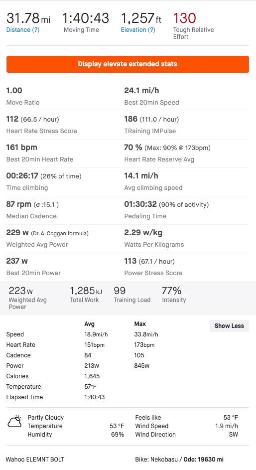

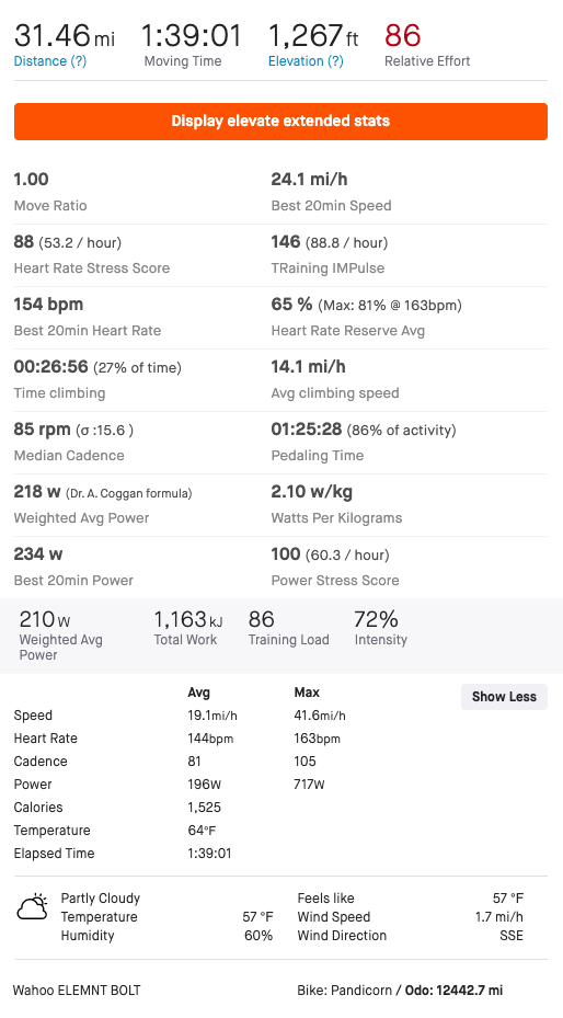

On the left, 1X Ritchey Swiss Cross on tubeless 700x35s, ~25lbs. On the right, Cervelo R3 on tubeless 700x25s, about 18lbs. Identical route. The difference in speed is about 8%-- brought about mostly by the lighter bike being slightly quicker uphill (lighter?) and slightly quicker on the descent (more gears.)
I have seen instances where a fellow rider on 44mm tires just rode away from me on really rough roads when I was riding on 32mm tires.

Back to back Tuesdays. On the left, the Cervelo from my previous post, on the right, the very same Ritchey. Only on Tuesday #2 I decided to see what it would take to match the
Cervelo's time with the Ritchey-- which is 40% heavier, has 50% more tire, and half the gears. I mean, I came close-- I think I missed the embedded segment time by about
40 seconds, but the increased level of effort is... pretty small on paper, really. But when I hit the last of the hills at around the 20 mile mark, I felt it a whole lot more today.
The most fun bit for me? In the first two efforts (posted above) the speed differential was ~8%. In these two efforts, I went harder on the steel bike trying to make the time.
How much harder? 8%. That's almost like a result.
I do have another ride from about 3 weeks ago where I put in the same roughly 130 score effort on the lighter bike. As expected, it's faster, about 5%. As the average speed
continues to increase, I'm experiencing diminishing returns.

I think his data are rather compelling.
For me, as a less-able rider, the percentage is probably smaller on the road. (I'm actually reproducibly slower on my 1987 steel Bianchi than my 2014 steel custom "gravel" bike, but it probably has more to do with comfort and optimal fit, even though I "feel" less sluggish on the Bianchi.)

Interesting. Your first side-by-side comparison showed slightly more effort/watts being used on the Cervelo. This seems to show more that you were having to work harder on the gravel bike to achieve the same speed. I know my carbon endurance bike is faster for the same effort than my Space horse over similar courses...but for the weight difference between the two, at least 6 pounds, and tire size roughly 28 versus 38....about 1 mph difference. Between my "gravel bike" and my endurance road, not much differences in geometry. Endurance bike is 72 HTA / 74 STA. SH is 71 / 73.5

8% is close to what i'd estimate. I would have said 10% based on my avg speed at end of 20 mile "favorite" ride i do often on either gravel bike with disc brakes and 37c gravel tire on rear, 30c cyclocross tire on front: or road bike with 28c road tires and rim brakes. Gravel bike is way more capable and comfortable on gravel. Road bike way faster on paved road. Too bad I usually ride a mix of both!
