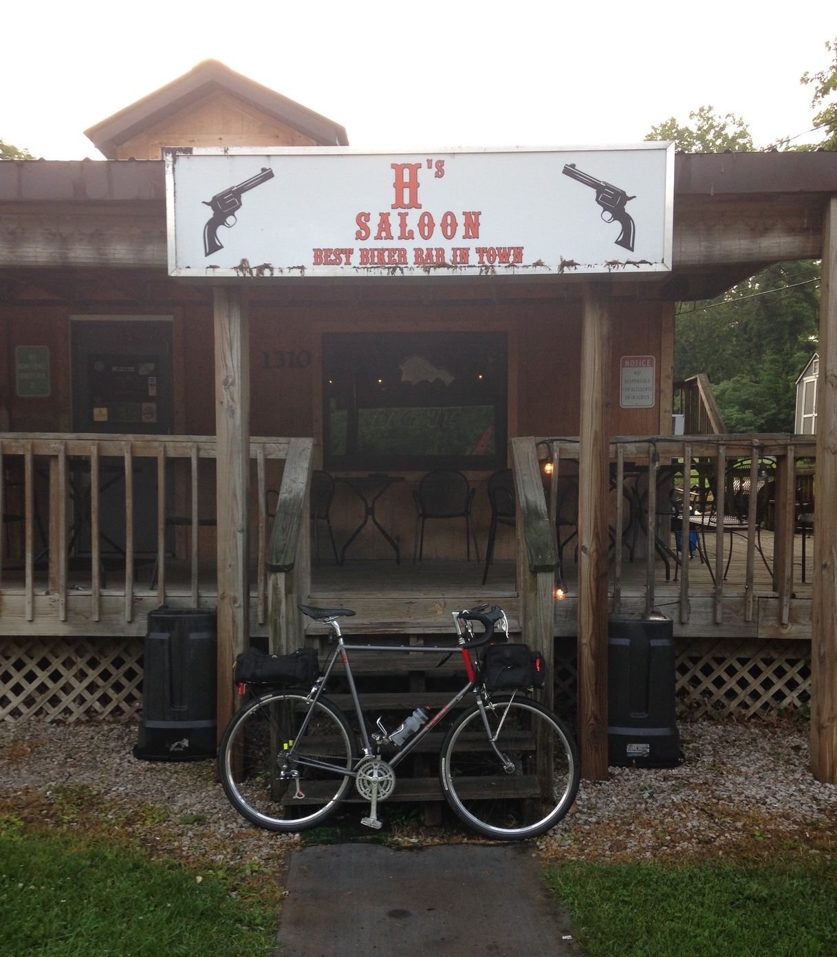

Got my 520C in October 2017. Did a 650b conversion. The combination has been the best money I have spent on a bike.
Trek 520 I converted to upright handlebar hybrid style. After ten years, my older brother still using it to get groceries & go all around town.

Panaracer Gravel King slicks. 38 x 584 on Velocity A23s, 36 hole front & rear, Shimano 5600 hubs.
Brakes are Tektro 559, they work fine for me.
Mine came from Craigslist. Original owner who rode it a lot. I was looking for a canti 520 but have no complaints with calipers. Easy conversion.

38s?!?!?! Dang, I may have to do this, just cause something that wide fits... I just put new cantis on a Miyata build, so I'm ok not splurging for another set. I think calipers are sexy, lol.
