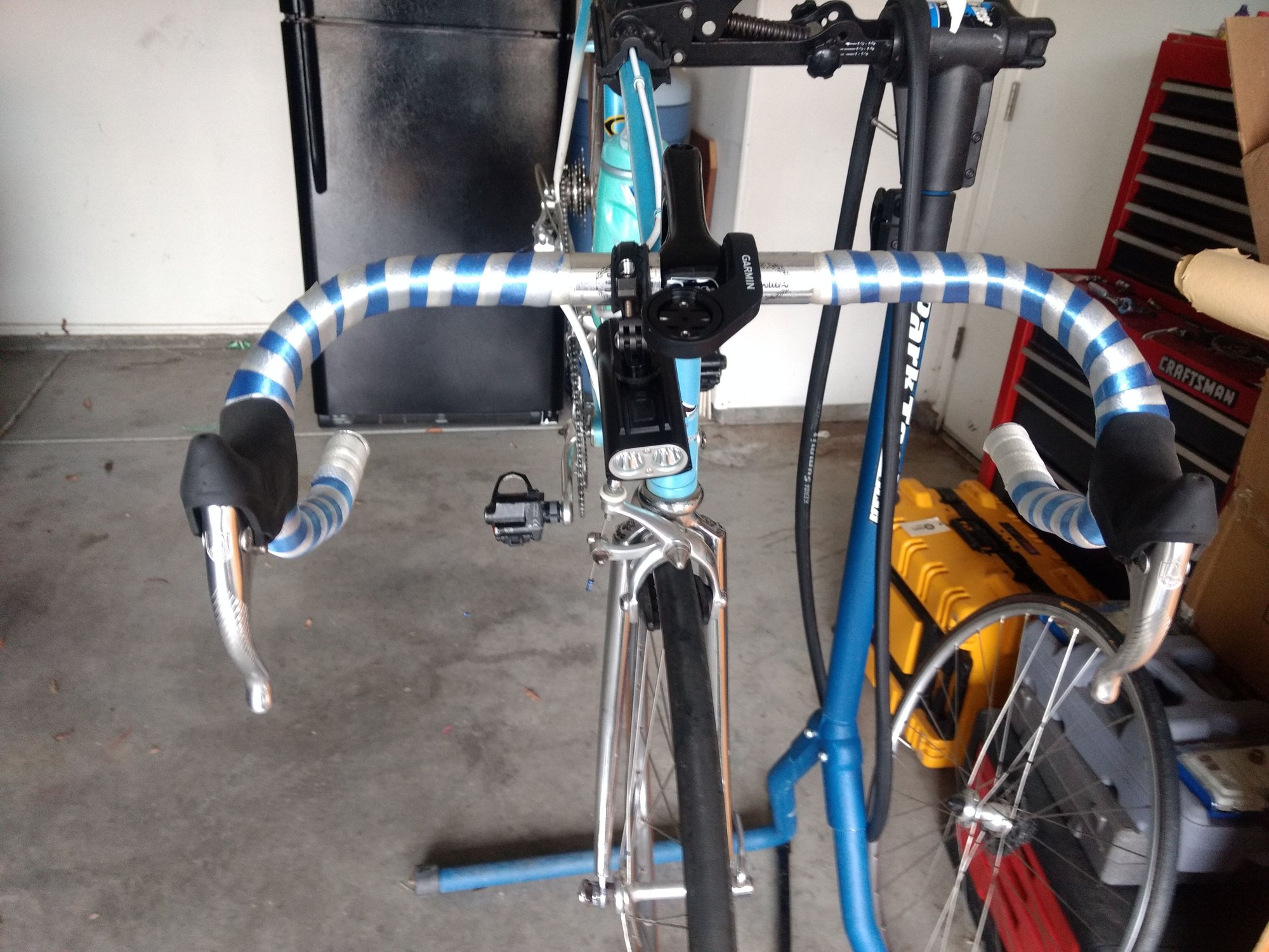

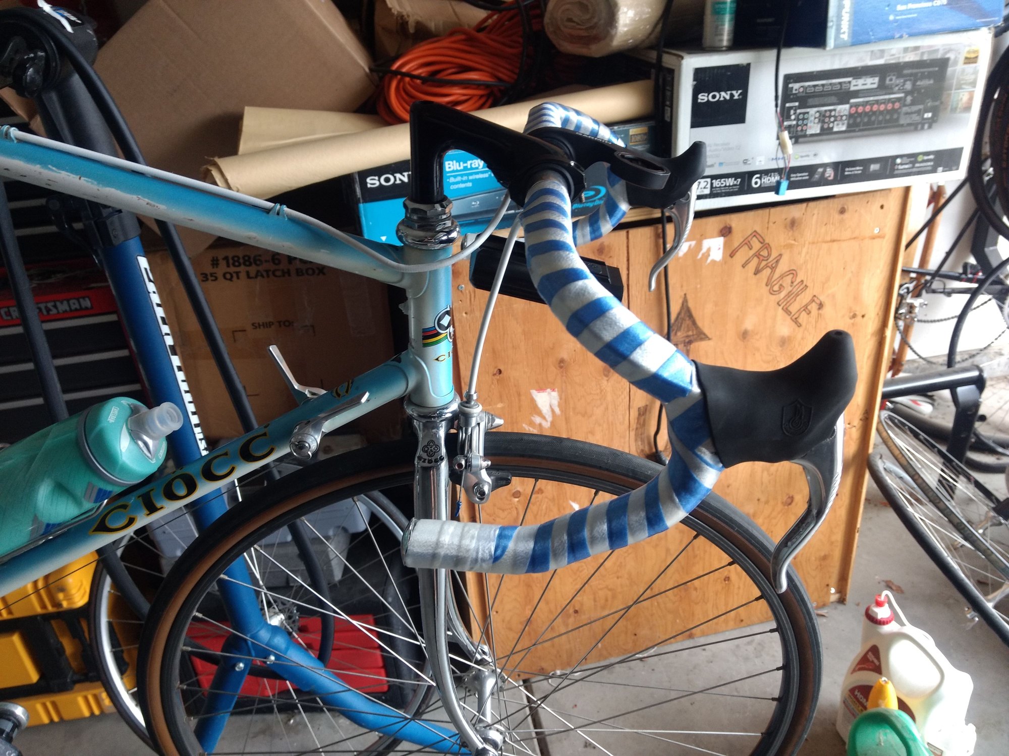

Finally got around to rewrapping my bars on the Ciocc. First time was a disaster. Whomever mentioned not to try Harlequin wraps was not freaking kidding. Wound up with pretty short rolls after ripping the tape. So I decided I could do a candy cane wrap... I was really good at those back in my bike shop days. Well it separated and looked like ass. Anyways, here is the rewrap...
i ran short on blue on the second side, so I re-finished the first side to match. I still need to put on the white brake hoods, and campy headset, but too lazy today. I also have 2 rolls of the blue from the box o' crap, but I am saving it for special!
