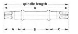

@katzenfinch: If you could measure your current spindle to get the dimension shown as "B" in the drawing below, I could look at my reference books and give you some ideas about what might work for you.
One thing to consider is that vintage TA and Stronglight cranks may not fit well on spindles of other manufacturers. The taper angle is the same, but the taper end size and the taper length may be different enough cause problems.

@Moe Zhoost: Thanks! It’s 55mm.

I found a reference for the Peugeot U08 spindle: 145 total length, 55 center, 43 left side, 47 right so that matches what you have. I found some spindles with a center measurement close to yours: Nervar 117 or 121, TA 344 or 373, or Stronglight 118/120/121/or 123; however there will be some issues using your same cups. First, the Peugeot spindles are slightly smaller in diameter at the shoulder of the bearing race. Second, the cup bearing races are smaller in diameter than other manufacturers. This will force the bearing balls to run on a different track on the spindle race. Certainly not optimum, though you may be able to get away with it.
The bottom line is that I'd recommend that you pick your crank first and then select a complete BB by the same manufacturer (though Stronglight cranks will work on TA axles). Proper spindle length will very between manufacturers since cranks don't mount a uniform distance on the taper. All of the spindle numbers I referenced above are for double cranks. The Stronglight 121 is specific to Peugeot with 5 arm cranks.
Hope this helps. Also, stay away from JIS spec bottom brackets if you plan to use TA or Stronglight Cranks, they just won't work.
Let us know how it goes.
