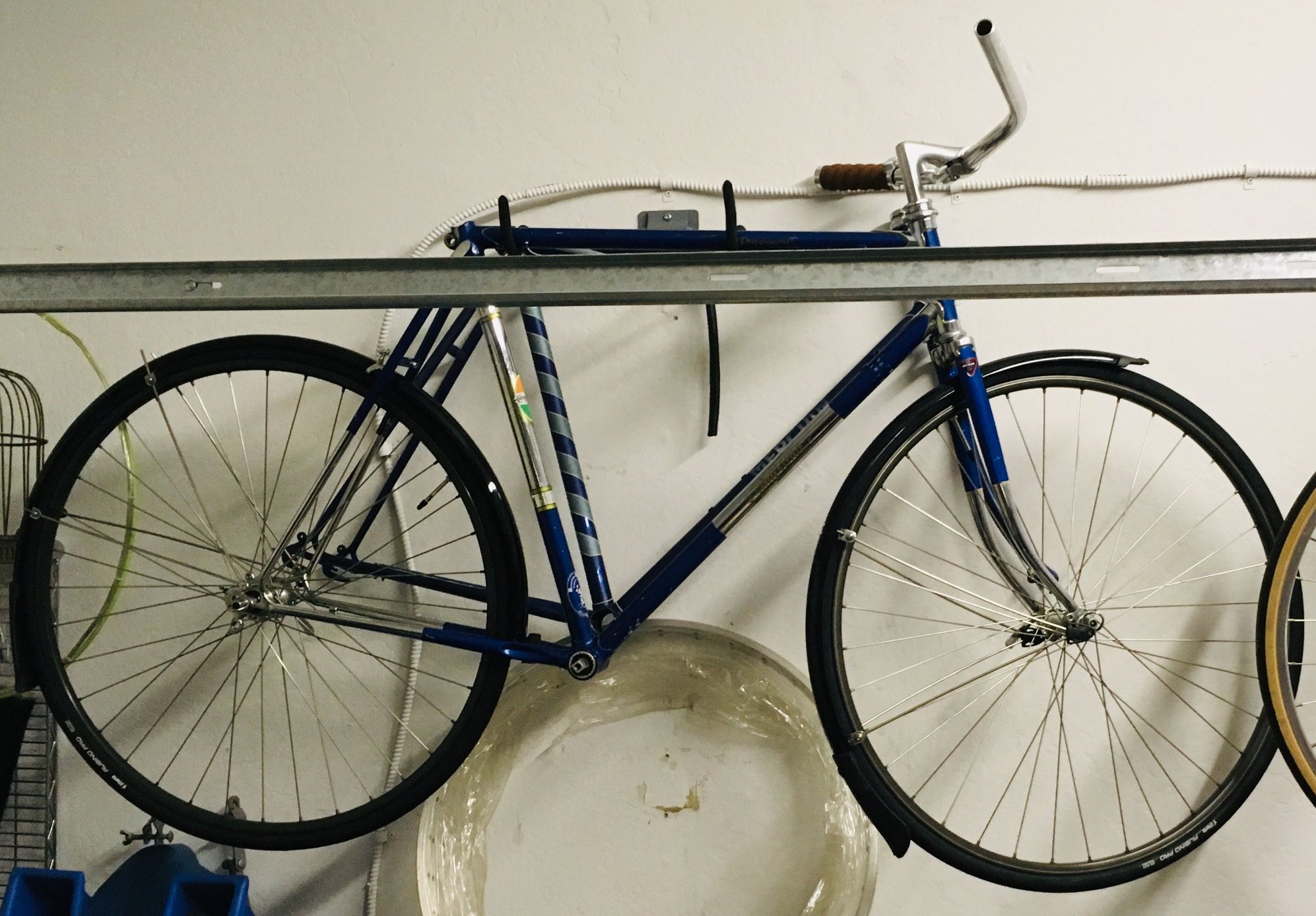

I don't know the identity of the manufacturer but the format is consistent with the Japanese source used by Bianchi in the 1980s. The frame itself is from June 1974 while the fork is a standard, off the shelf, Ishiwata product from May 1974. Given that the fork is Ishiwata, the frame tubing is likely Ishiwata too. Consequently, we may be able to determine the tubeset from the inner diameter of the seat tube or the diameter of a proper fitting seat post.
Wow, thanks for this info... The seat post that came with it, and appears to fit, is a 27.0. Does that reveal something definitive?
It's almost certainly Ishiwata 024, as 27.0mm would be the correct size post and it's an appropriate tubeset given the level of workmanship on the frame. The only Tange possibility would be Champion Pro but that seems unrealistically optimistic given the mass production workmanship and Ishiwata fork.

Originally Posted by noobinsf View Post
Picked this up last weekend from a neighbor. Dr. Google tells me this was a Japanese brand that was trying to evoke Italian flair, and this was apparently the top model. It’s nothing special, but it is double butted chromoly, and apparently fully chromed under the paint. Neat little frame with some nice SR Royal components and KKT pedals. I’ll likely clean this up and sell it locally. Just wanted to share...
These were fairly common in Oregon back in the 70's, FWIW. And I LOVE that seatpost!

I just thought I’d record a couple more details since I see so little information about these on the interwebs. I am less convinced that I’ll sell, and am toying with the idea of making it a townie commuter.
The weight of the frame is 6.8 lbs or thereabouts. This is the difference on the bathroom scale between me and me+bike. Not a featherweight, but consistent with a posted weight I saw for an Ishiwata 024 frame, so I am still going along with T-Mar’s suggestion that this is likely the tubeset. Revisiting the specs I had seen before, my measured weight now seems excessive, so I'll need to doublecheck the weight.
Also, I am intrigued by the Suntour GS dropouts, as they have this fold inward toward the hub at the eyelet. I haven’t seen it before, and I just think it’s pretty. I have a couple of angles of this below. Spacing is 123mm.
In addition, YCF fork ends.

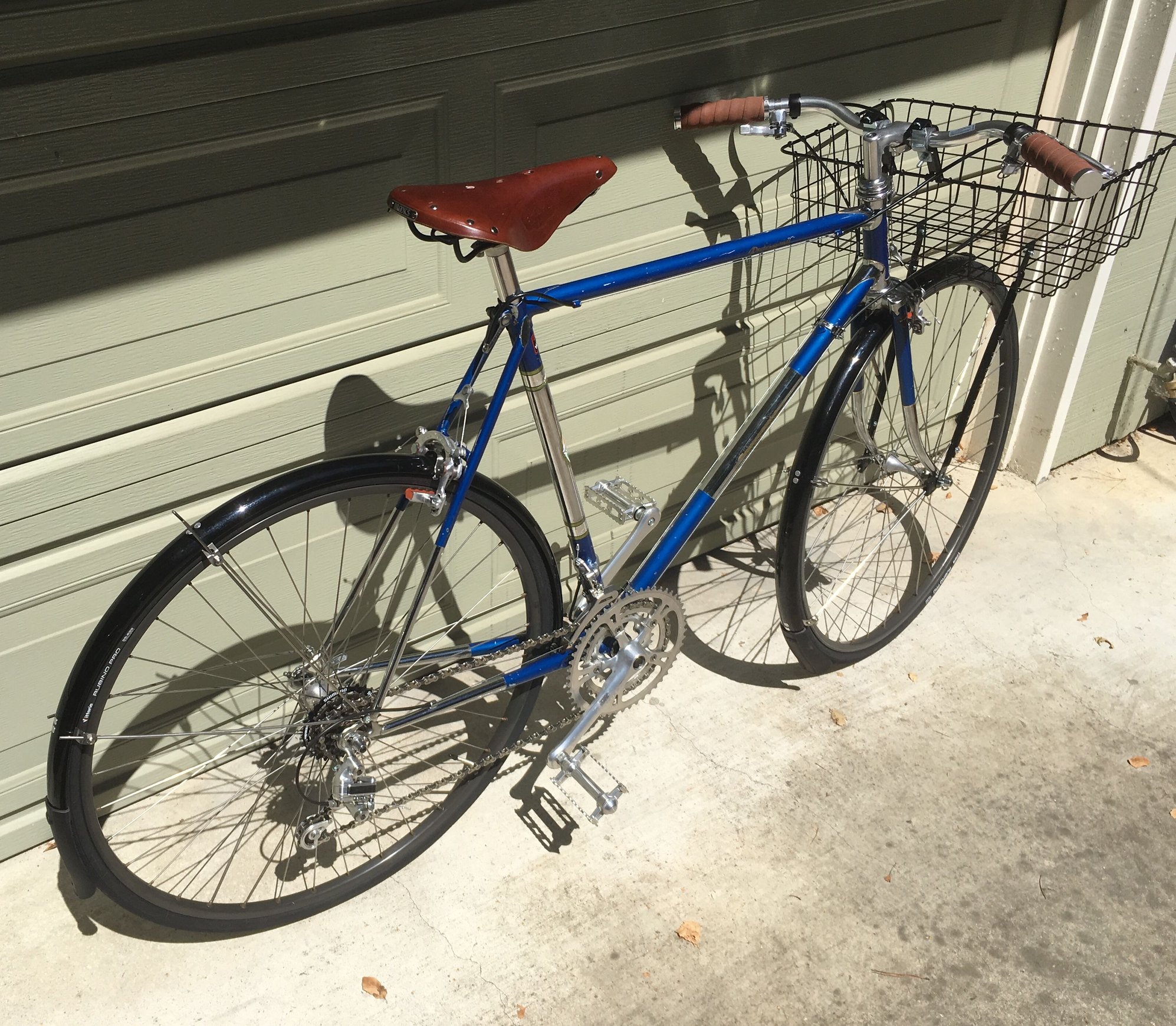

... And finished!
Finally, after stealing time here and there, I have a new commuter. I couldn’t be more happy that this freebie frame turned into such a swan. With basket, it weighs 27.4 pounds, which is several pounds lighter than my previous commuter, the Puch.
Build details:
I decided early on that I would repurpose the SKS longboards, so that dictated the decision to go no wider than 25mm in this iteration. I found a CL posting for these brand new Vittoria Rubino Pros for $12 apiece, and the rest sprung from there.
- VO Milan bars w/ Origin8 stem
- Tektro FL540 levers
- Suntour thumb shifters (from BF)
- Public Bikes grips (cheap, on sale)
- Sugino AT 52-38-28
- MKS Sylvan Touring pedals
- Shimano UN55 bottom bracket 127mm spindle
- Shimano 6sp freewheel 14-28
- Sunshine Gyromaster hubs laced to Mavic rims, unsure of model
- Mafac Racer brakes w/ Koolstop pads
- Brooks B17
- Bontrager 27.0 seat post
- Suntour Blue Line fd and rd - low mileage, came from a long sold Univega touring
- Wald 1392 basket
Withe exception of the shifters, bars, grips, and basket, everything was either in the parts bin or repurposed from past builds.

SKS fenders? Now you just have to pray for rain...Looks like an excellent downtown runner.

That build list sounds like a who's who of sweet bicycle goodness. Pretty sweet build.
