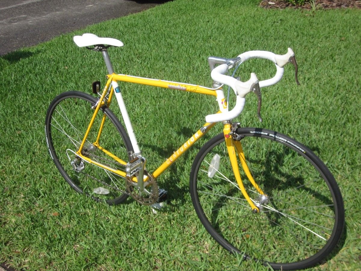

?..my daughter's 1987 Ironman (with the 24" front wheel)....
...The stock 105 friction front derailleur and downtube lever also seems to shift this setup fine. So often you just don't know what will work until you try.
I also moved the 48-tooth big ring from the 105 crank over to the new crank, so my 9 year old daughter now has a nice 48-42-30, makes the 13-28 in the back entirely sufficient even for steep Vermont hills (Vermont road builders apparently never heard of switchbacks....)
N
N

All cleaned, refurbished & advertised for sale today. I think it's a 1987 but, not completely sure. It's a Centurion Master with Shimano 600 groupset.
Likes For ramzilla:
