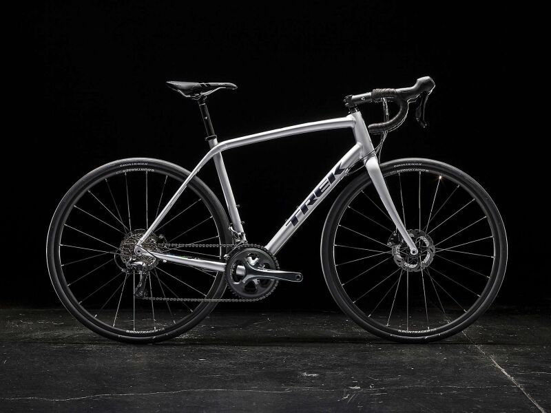

I am a small guy. I am 17 years old, 5’3” and 115lbs so putting down power to go fast on flats isn’t easy. People say I am really good at climbing and eh on the decents (I am ok with).
Generally every other day I go 20 miles at 20mph avg. I am 17 so don’t have crazy amounts of money for aero bikes. I ride a trek domane alr4 disc and it’s endurance. Where I ride is generally slightly hilly but no huge long climbs. It’s not a flood plain but not like The alps. The biggest thing that slows me down is head winds at like 12mph.
I want to get faster on flats and need a training plan. Tips?
