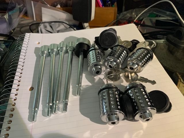

All,
I can't get my 1Up hitch pin to engage with the inside of the lock mechanism. The pic below shows as far as it will go in before bottoming out on the internal female threads.
Of course the male screw thread is rectangular as well as the portion you can see right where it inters the lock. I think the non-threaded rectangular portion of the screw is supposed to go all the way in past the lip in the female side so that it can then be turned to engage the internal threads.
Seems that the pin bottoms out on the internal thread before the rectangular piece clears the opening in the lock.
The wheel locks have the same problem.
Any ideas?
Thanks much.
Glenn
Any ideas?
Thanks much.
Glenn

Seems strange that they all have the same problem. Stupid question, and please don't be mad at me for suggesting it, but have you made sure the key was turned counterclockwise all the way before inserting the male end? I know, it's like asking if the computer is actually on when you call Apple tech support, but I was just trying to think of what could cause all of them to have the same problem. Do they physically work and just not look right, or do they not work? IIRC, they do draw in a little as you are tightening the threads with the key. Also, I'm not totally sure they go all the way in when engaged. My 1up locks are at home, so I can see what mine look like when engaged later tonight.

Either that wasn't in the instructions or I missed it (more likely). I can't tell you how much I appreciate your help. Is it safe to use the rack with just the Security Hitch Bolt screwed in with the Security wrench? It seems so, but then again, I'm not sure. Again, many thanks.

Glad it worked out. Free fixes are the best kind. On your security bolt/wrench question, I assume you mean the hex key/Allen wrench that fits into the end of the hitch and tightens the rack to the hitch? If so, yes, it's totally safe. Everything beyond that is just insurance. Just make sure it's tight. The keyed hitch lock isn't for attaching the hitch, it's just to keep someone from stealing it. Enjoy!
