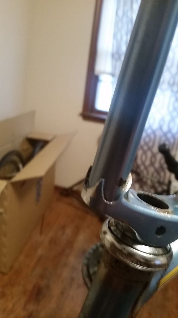

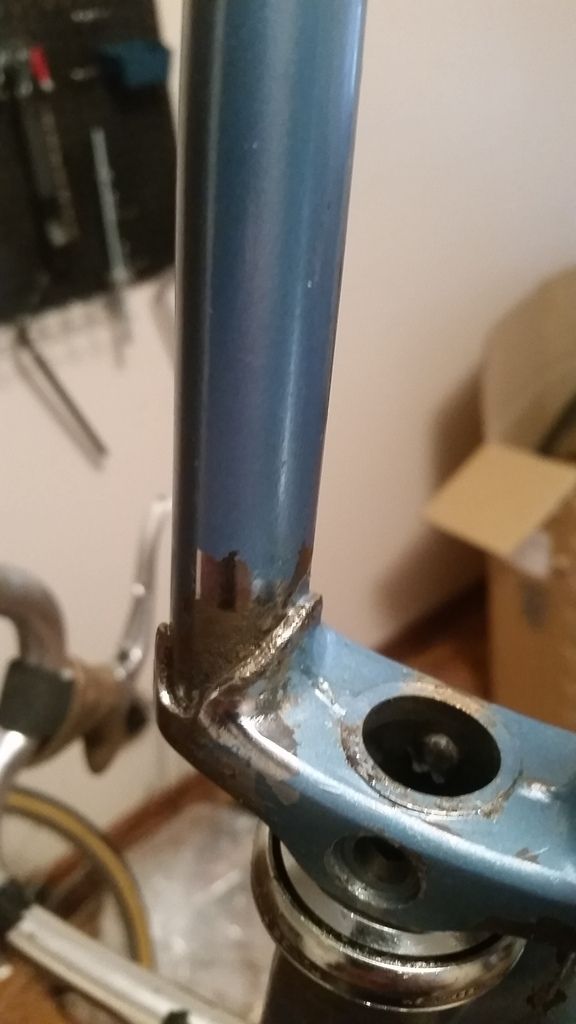

Here's and update. I soaked most of it in ER for about 48 hours. Lots of scrubbing and wd40. Unfortunately there a lot of pitting. I think I SS this and keep the "patina" I already have 2 geared road bikes.

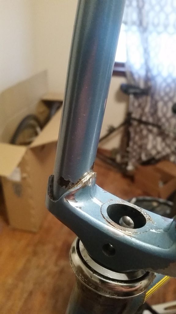

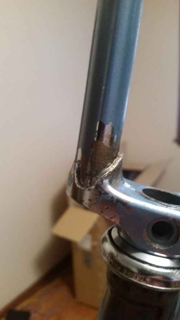

Originally Posted by tricky View Post
The fork is the only thing that gives me pause and is the main thing that could cause a serious crash if it failed. That said, consider this another vote for fully removing all the rust via naval jelly, evaporust and/or some vigourous wire brushing and you will be able to see what the condition is of the metal underneath. I am doing the same and then POR-15'ing and riding the heck out of an '84 Mongoose frame that looks like the BB area was submerged in the Puget Sound for a couple years.
+1
It's rare to find a frame that's so rusted out that it couldn't be saved.
jSteel frame strength is 99.9999% in the joints - lugs, TIG weld area, fillet braze, etc. Focus on that bad rust area near the fork crown, from what I see. Remove the rust, if it's solid underneath, I'd say you have a rider.

The fork actually cane out the best. It looked the worde, but was mostly surface. The rust totally came off.

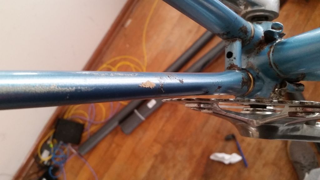

I used a sealed 110mm BB from a local used parts place. Spins nicely, but wanted to make sure that it isnt too close to the frame? It obviously doesnt rub, but, was just making sure. Am I Okay here?

It depends on how much the frame flexes when you are really hammering on the pedals. You could put a spacer between the bottom bracket fixed cup and the frame to move it out a mm, or if it doesn't mess up the chain line, you could put the chain ring on the outside of the crank arm.

Oh boy, nice suggestion! I can't believe I didn't think of that. I will hammer it and see if it flexes. If it does, I'll swap the chain ring to the other side. I have a SS conversion kit in the back so if the chainline isnt right, i can swap the spacers around. I suspect it wont be an issue though
