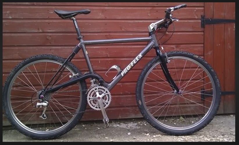

Any of the K2/ProFlex/Girvin bikes can accommodate a belt w/o modification. Either the aluminum swing arm, CroMo arm, or the carbon one. No hassles. There are other brands with arched swing arms.
On the elastomer suspension bikes, you can use a stiffer poly bushing. On the shock arms, you can put in an Air Shock and pump it up enough and you will never have to worry about pedaling losses from bobbing.
I don't mind a bit of bobbing for the plush ride on my K2, even on the street (Fox Shock). It only happens when I'm up on the pedals climbing steeply, and not much even then. As long as I sit, no issues.
28 lbs all up with plush seat and rear rack, not bad for a trail bike that can run errands too
Not mine, just a snap off the Net:
Many are now getting converted to Gravel Bikes

If you modded a ProFlex with the elastomer rear "strut" it would not change length much. It could be your tensioning system.
Harleys have been running belt drives for years with 3 inches of suspension travel at least. Belts can handle some slack, just not as much as chains with a spring loaded derailleur ... And you can add an idler roller with a spring to keep the tension constant, if you want to.
I was just offering a rear end example that did not require cutting the rear triangle ... I'll bet there are a lot of older MTB designs where the seat stays or upper suspension "rods" are moveable/removable, making them easy candidates for a belt conversion. Limit the travel and you are good to go
An ingenious person could prolly calc the belt length so that as the rear triangle came into alignment, it would induce correct tension ... And maybe adding a simple roller in the right place would keep the tension as the swing arm moved a bit for better ride ...

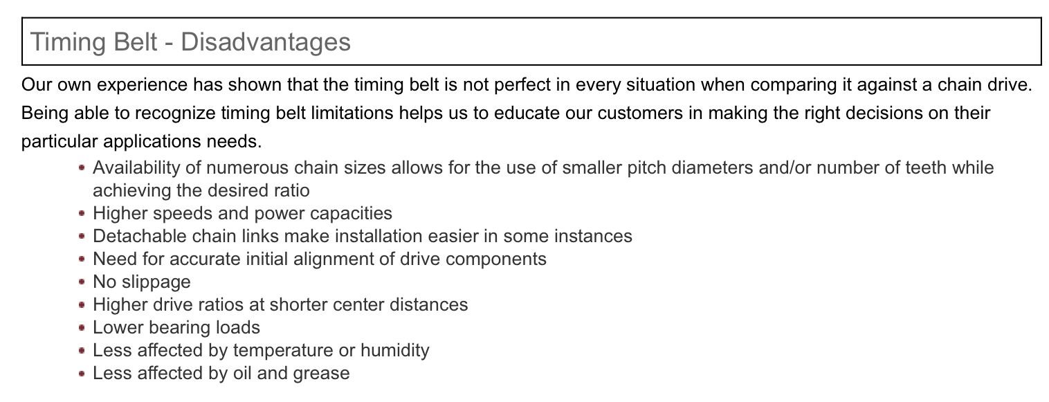

This is the comparison of timing belt drives vs chain drives for industrial drives. Note that some of the remarks would not apply to bicycle drive trains. Also, I think repair is problematic as likely more people would attempt to repair a rear derailleur compared to opening up an internally geared hub...
Timing Belt Advantages & Disadvantages | Pfeifer Industries
