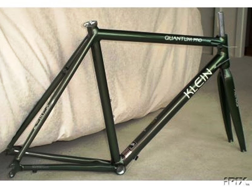

Just in case any Klein fans haven't seen this:
MyHistoryOfKleinRoadBikes
Performance model was offered with at various times with Victory, Ultegra, or Chorus or DuraAce.
My Quantum Pro is still my best bike and main ride at 21 years old and I have hardly any motivation to get something newer.
Built it up from a bare, unused frame: 1998 model in 2003, picked every single component... replaced almost all of them since then too.

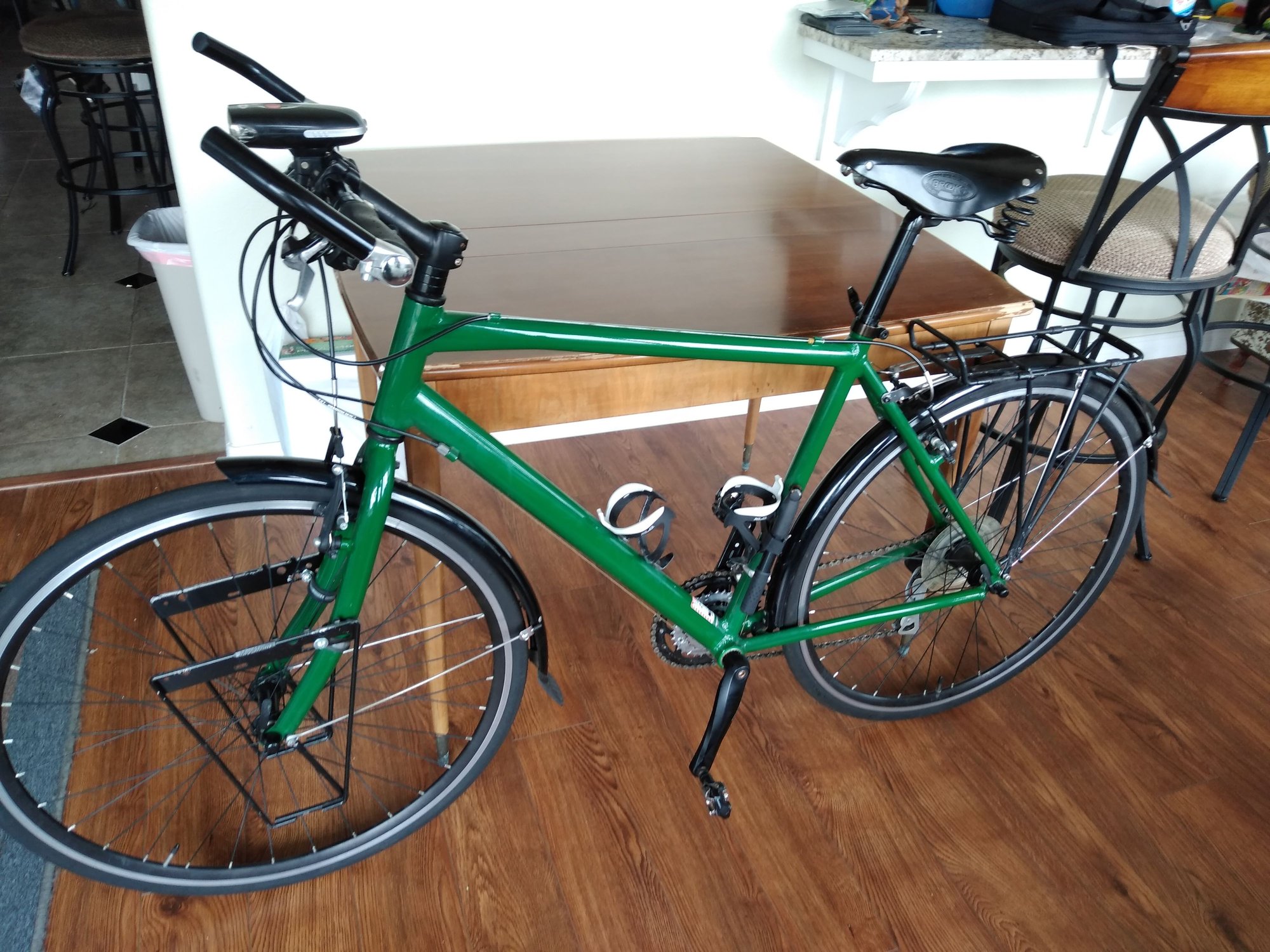

Originally Posted by Lascauxcaveman
Looks every bit as good as a pre-canti Cannonade ST. I've been looking at Kleins for the last couple years, but haven't seen a tourer for sale before.
Any idea what year it is? Looks like early 90s Deore on there, but I'm no expert on that timeline.
Right. 92 maybe 93. I've got some barend shifters coming.
I'm retiring my touring bike to someone moving to South Dakota so it's down to the Dale and the Klein, two bikes i could never touch when I was their age. I must say they held up better than I have..😆
Cycle Tourist is offline
Old 05-04-19, 02:06 PM
Cycle Tourist
Posts: 659
Quoted: 195 Post(s)
Liked 207 Times in 126 Posts
Originally Posted by Bad Lag
That frame is awesome!
How long are the crank arms on that bike? In the first photo, they appear to be so long as to not afford any reasonable lean angle while pedaling.
I do not care for the seat post, the seat, the stem, the bars, the white tape, the grey cables, the pump and its location. The rear rack using P-clamps around that beautiful paint when there appears to be two lugs meant for rack attachment is bugging me.
The frame is worthy of better.
I know what you mean. One of the braze ons will not unscrew. I tried pulling and twisting. No go. I rewrapped the clamps with rubber tape. The front forks had no braze ons so the clamps are nesssesary. I like having them so they stay with all the care I can bestow to the frame.

Old 05-04-19, 02:11 PM
Cycle Tourist
Posts: 659
Quoted: 195 Post(s)
I just thought I'd offer a critique, something the OP could think about. Sometimes we don't see things the same way others see them.
No matter, I still like the frame.
The crank arm in that first pic looks like it would barely clear the ground when fully upright. Are they really THAT long? How long are they?
Only 175. My Dale came with 180 on the 63cc frame.

Cycle Tourist
Posts: 659
Quoted: 195 Post(s)
Thanks guys. It's great to join the Klein Klub. The rivnut got recrimped, the clamps put in the parts bin, the saddle got replaced with a Brooks team pro and the DT got swapped to Suntour barends. I'm still deciding about the suspension seat post and I'm in no rush to change the tape. It does look a little like something I dug outta my first aid kit😂 but I can live with it for awhile. Oh, the FD was pretty rusted so it sports a unknown brand new one.(sunrace?) I know it's not a typical touring bike but I think it would be just fine with a smaller granny when or if I take off for an extended tour.
