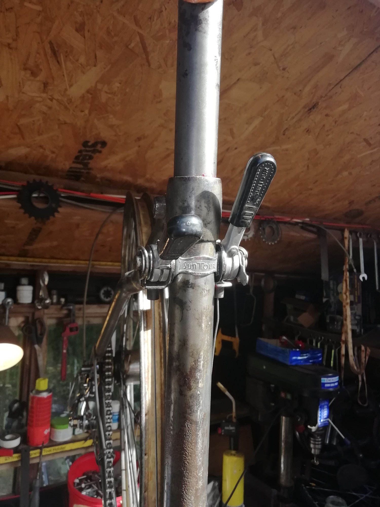

Sun Tour shifters on seatpost
I'm trying to find a nice old brass quadrant shifter for the top tube, but I'm not even sure if the cable pull is the same.
That's the first time I've ever seen a seat-tube shifter. I wonder how hard that would be to get used to.
The tires are Fairweather Touring "Cruise" Tire, 700x38c - Cream from Velo Orange. Nicest, smoothest tires I've ever ridden on.
IGHs have a strong spring and can overwhelm most variable shifters. These Sun Tours work a 1930s derailleur and a 1946 SA 4 speed. They have a very good clutch so that they move freely but hold the position you select and don't slip.
In situ. The shift lever travel for the IGH is very short. Maybe 20 degrees of rotation selects gears 1 to 4.

1950 Superbe reassembly
Hey all,
I've got an issue with axle room on the drive side for the three speed cog. When I place the original washers in their position as found when I disassembled, there isn't enough room for the axle to slide into the drop out with enough leftover for the indicator chain bolt (the name escapes me right now). If I remove spacing washers, the tube is too close to the cog set which results in chain rub. Any thoughts? I'm new to setting these up so it's a bit confusing. Did I somehow move the axle too far toward the non drive side? Photo:

Originally Posted by Ged117 View Post
Hey all,
I need a refresher. This is a block with three cogs you've fit onto a standard AW hub? Or three separate cogs on the original driver? I understand two cogs will fit, how three, as they are thicker than the spacers?
This is an AG hub with a Cyclo derailer three speed added onto it I assume at purchase or just afterward. Right now I'm fitting just the AG and the cogset to make sure the AG shifts properly before installing the Cyclo parts.
With an AW there's no moving the hub left or right on the axle. I imagine the AG is the same way. You can get a right side axle nut that combines, into one piece, the hex nut and the part with the indicator window. That will solve the insufficient threads problem. As for the indicator chain, the length is correct when with it pulled out all the way the rod peeps a little bit over the end of the axle. But a shorter one should work, in my experience. But you lose the handy visual guide to position.
