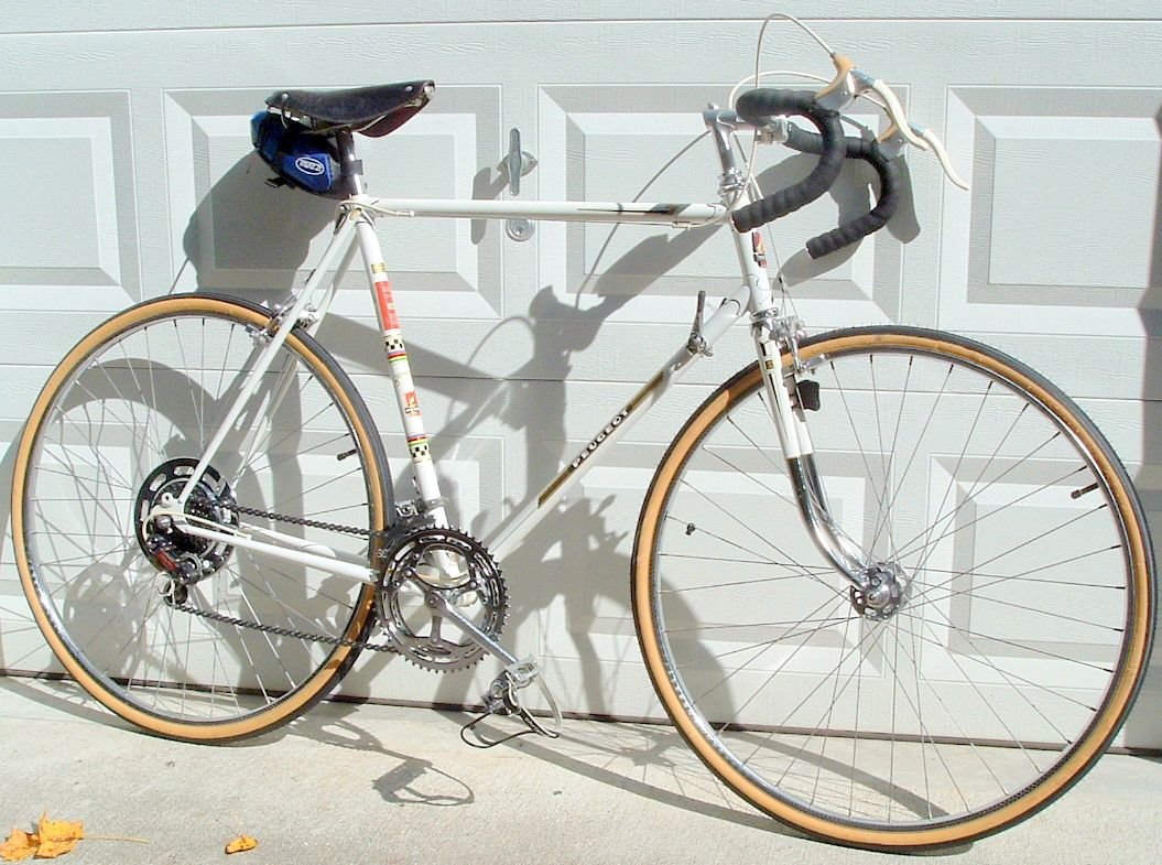

One of my bikes that I shouldn't have sold, and still regret selling. The picture is as it was originally restored, and later sold. In between, the majority of it's life was spent sporting Normandy hubs and French tubular rims (forget the brand) and tires. The difference in performance was, as would be expected, incredible. I've always loved a late 60's/early 70's low end amateur racing bike, and really enjoyed riding this bike.
Another moment of "one too many bikes and I'm moving". So the UO-8 went so the Tour de France could stay.
