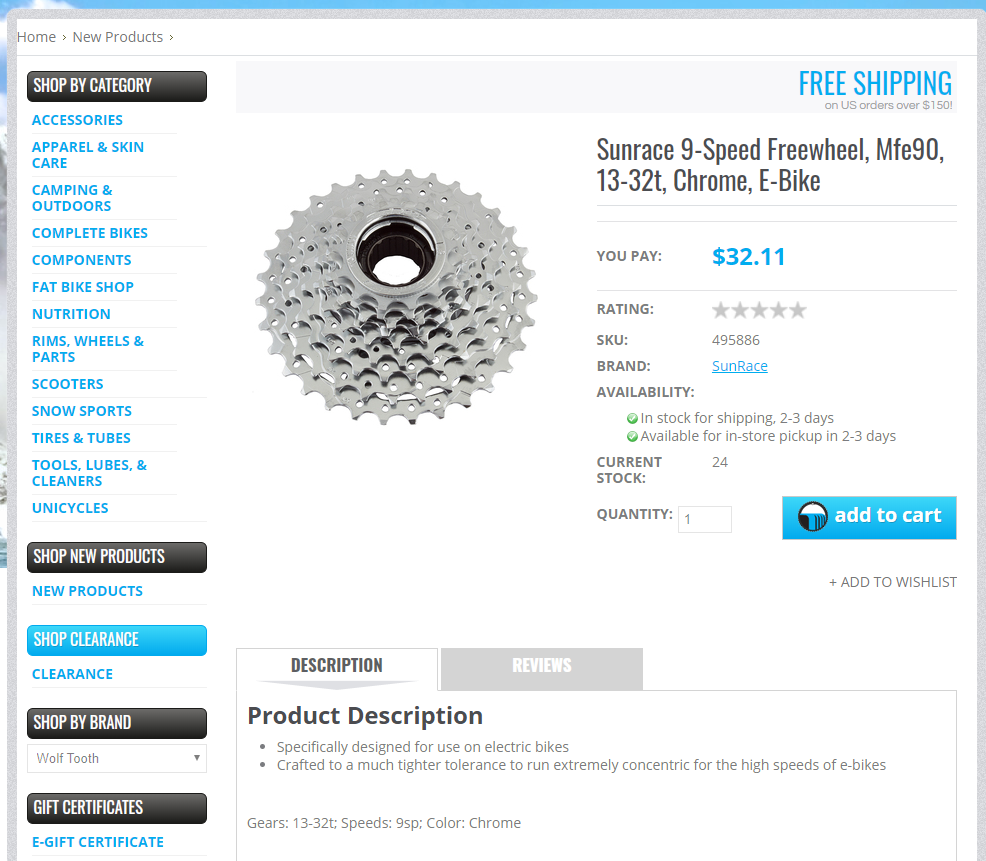

is this the one you got? claims it was designed for electric bikes....if it is not the one you got, may be worth looking at
https://www.thebikeshopstore.com/cat...xoCPhAQAvD_BwE

It is not the one I got, but I am interested! I think I will wait and see what happens with the parts I already have coming, though, before I buy any more.
Since I posted last night I have been reading Sheldon Brown again, and he says the cogs are spaced the same in 7/8/9 and that all these claims of incompatiblity are just to sell us things. So maybe the 7-cog freewheel WILL work with my 9-speed derailleur/chain/shifter and the indexing detentes will be correct. One way to know, try it and see. If it does, I will just stick with that and save myself from the frame springing drama, no need to order more parts. Or maybe I will follow his instruction on springing the frame. I will keep you guys posted.

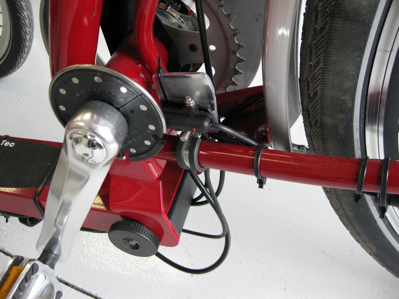

The pedal assist works well. It is controlled by magnets on a disc that spins with the pedals, like a more elaborate cadence sensor. I have discovered that if I downshift, the magnets pass the sensor faster and more assist comes on. Which is perfect since going uphill is when you need more assist! I have got the menus set to give me a max of 3mph with the throttle, so if I want to go faster I have to pedal. But if I am in a low gear and pedal the assist kicks in pretty strong. The bike was super heavy even before the motor and battery went on, so I am shifting the gears a lot. Mainly because if the gear is too low, it helps me too much and I need at least some resistance when I pedal. I used to be able to keep my cadence high and spin all day, but now I am fumbling. I have some nice old Campy quill pedals which I just finished putting on, see if that helps me smooth this out, but sloppy pedaling and feeling like my knees are going to fly away may just be something I have to live with. I ran these pedals for years, back in the early 90s before I switched to clipless, and now I have them to remind me of what it felt like to be a serious cyclist.

Here are some pictures:

Pedal assist sensor
