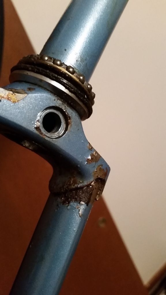

Tempo too far gone?
Hey guys. Picked up this sweet Tempo for 10 bucks. It has a lot of rust but the paint is clean in most sports. Do you think its too far gone? If anything, I got a nice headset and seatpost binder bolt

It ain't beautiful, but then if it were you wouldn't have gotten it for $10.
I wouldn't bother with much more besides removing the worst of the rust and some rattle can touch up. Then build it with spare parts form the salvage bin, and you'll have a decent beater bike.

I would have it sand blasted to see the extent of the rust damage, then rattle can it. Framesaver for sure as that looks to have been an outside bike.

You did okay for 10 bucks. Looks like a good winter project. As others have said, can't really tell about the frame until you clean those areas very well. You will probably find some hidden rust in other places. If after cleaning the frame it is still strong, treat for future rust problems....then you come back and tell us your plans for it.
Look forward to the report! Those are good bikes. Too bad the frame did not come with a fork. Is there tube damage near the HT joining the top tube or down tube ?

I think I will do a Evaporust treatment first to assess the dmg. Im not sure I want to spend the 70 (sand blast and podwercoat quote) + decals for this.....Decisions

The fork is the only thing that gives me pause and is the main thing that could cause a serious crash if it failed. That said, consider this another vote for fully removing all the rust via naval jelly, evaporust and/or some vigourous wire brushing and you will be able to see what the condition is of the metal underneath. I am doing the same and then POR-15'ing and riding the heck out of an '84 Mongoose frame that looks like the BB area was submerged in the Puget Sound for a couple years.

Those are sweet bikes. I'd de-rust it and if you're lucky, the thin tubes will not be rusted through anywhere. Then build it up make a cool and inexpensive racer out of it.
