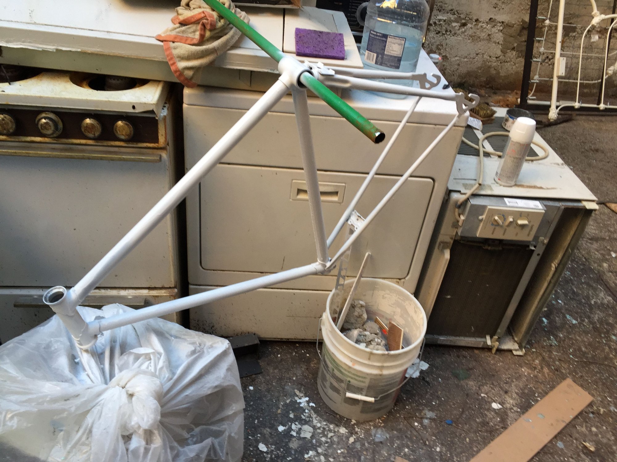

Im stripping down my bike with a goal of repainting it. However, Iím starting to like the bare metal (itís a vintage bike frame so probably steel) as it has tha silver look to it.
do I need to treat it? Or can I leave it bare? and whatís thecoldest temperature I can paint in? I live in nyc and I hear that cold weather causes the spray paint to drip and bubble
(I out on primer and realized that I messed it up and so I took it off...Iím new to spray painting!)

Clean it up the way you like and clear coat it. Left bare it will surface rust pretty quick (depending on conditions) before eventually developing deep, cancerous rust thereafter. A few coats of clear lacquer will preserve the bare metal look nicely. Lacquer will leave a very slight amber tint if you’re concerned.
Winter is a tough time of year for painting projects. When it’s too cold, flow and curing problems result. You can use a space heater to warm up your painting space, but NEVER NEVER NEVER use any type of open flame heater. I’ve painted frames in a cold garage using a radiator type space heater. Keep in mind you’ll need to keep the area warm well after you’ve applied the paint for the best dry and cure.
Google other cool possibilities like a copper sulfate wash, boiled linseed oil or acid washes. Some finishes won’t require a clear coat for protection while others won’t last without something over the top. Lots of possibilities.

Coat the bare steel in a light oil or even WD40 to prevent flash rusting, and take it to Arcane Moto in Brooklyn. They should be able to do a clear powder coat, it will be a much more durable finish than ordinary paint.

Be patient between the coats if you're doing it in winter. Give it a full day between coats. It's excessive but worth it in colder conditions.
Give it a few weeks to fully cure. It will be dry to the touch 2 hours after your last coat. You will be able to handle it safely without leaving any finger prints. But it wont' be ready to use. The paint will be soft and prone to scratching. Once the paint it full cured (assuming you applied it properly and used the correct paint) it will be a very durable coating. A clear coat, 2 or 3 coats worth, will add more protection to the paint job. Give the clear coat the same 2 week cure time.
The first time I did this (March time frame in the mid atlantic, so cool outside) I was discouraged by how soft the dry paint was and how easy it was to scratch. But after 3 weeks of leaving it alone and letting the paint really cure it's now a very durable finish.

I live in West Michigan. Right now it is 20 degrees out there. Painted a fork 6 weeks ago. Temp was 35 degrees. The fork and spray paint in a rattle can (Rustoleum) were at room temp, roughly 65 degrees. Sprayed outside and immediately brought inside to dry. Wait time between coats was 3 hours. Three coats plus 3 clear coats. Not sure at 20 degrees how the paint will atomize, but at 35 degrees it was just fine provided it cured indoors.

If you like the look of bare metal, one thing you might do is put cold blue on it -- which is a finish to touch up firearms. It creates a kind of rust to protect the steel, but instead of being orange-ish red, it's dark grey-ish. It looks especially cool with fillet brazing, because the brass stays brass. This is a delicate finish that offers very little protection to the metal, so I'd rub car wax or a really light coat of linseed or tung oil. You could spray a clearcoat, but that would diminish the effect I think you might be going for -- that very raw texture and appearance of bare metal.
Bluing is best applied hot -- that's how it goes on in a factory -- but the cold blue works. The color won't be totally uniform. Prep work makes a difference. The smoother the metal, the shinier the end finish will be.

  • I would paint it in a bare metal epoxy primer. I have some around for painting body panels on the Jag that I'm restoring.
  • Lightly sand the primer and hit it with a build up primer. Again, I have some around.
  • Lightly sand it and spray it with a durable single stage enamel with hardener.
Mind you all of these steps require an air sourced painting hood as the hardeners and other materials are very harmful.
Or I'd take to t local powder coater and have it powder coated.
