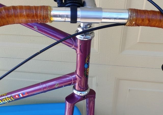

Is this a real Pogliaghi???

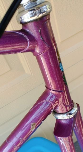

Per ad
"Steel frame, campy headset and bottom bracket. Handle bars and stem set with arrow levers and cables. Sugino crank set with delta pedals. Campy front derailer, campy cable guides. American classic seat pin. 56cm"
My BS detector is on high alert but did notice the pink paint is over the decals and it's not a make most people would think of for a scam,.....

The pink looks spray bombed.

I agree about spray. Spray over decals could also be spray over a crack. Puzzled why someone would start to spray then stop, unless covering something up (crack or serial number). Can't see it being paint scrapes surely on the front of the seat tube at the BB shell?
As I said BS detector on high....

never seen any true Pog (even those made by Basso or Rossin) that had those Prugnat (?) headlugs or "shot-in" Victor-style seat stays. My guess is "British" not Italian, so I suggest: check the BB threading! May be a decent bike but not a Pog.

I'm no expert in high-end Italian frames, but I am somewhat well-versed in high-end British ones. The fastback seat lug looks like a '70s Holdsworth Mistral or Raleigh Pro. The top head lug, with those weird blunt crests/points going forward on the head tube looks like a design I've only ever seen on Holdsworth and other Holdsworth-manufactured frames from around the '70s and '80s. I've never been able to find the lug manufacturer, I always assumed it was something done just for Holdsworth.
The question remains, Why. Running a scam like that for what, a frame worth $1000 at most (and probably more like $600 right?) isn't even worth the scammer's time! Even to do half-decent decal work and paint with clear like that would require hours of prep. Long enough to realize you're doing something stupid. Plus, a Holdsworth Mistral or Raleigh Pro is not a bad bike and would sell for nearly as much (these days). If there's not a motive, I have to question whether there was a crime committed. My knowledge of lugs isn't good enough to say guilty beyond a reasonable doubt. Hung jury.
Maybe it's a prop from the film Breaking Away...didn't they decal up some fakes for that film?
Edit: @unworthy1 beat me to it! Are they Prugnat? I had that in my head but they don't quite match anything from the catalogs I've seen
+1
The Brampton Victor seat lug combined with this pattern Prugnat lugset screams UK.
Like other posters have na'er see'd this combination from Sante.
Expect a BSC shell.

Mid 1980's Pog was bought out by Rossin. So if it is one it would be a Rossin example. But that does scream late 1980 color scheme.

One possibility is that he was on a team, or in a club, that rode Pogs, and this was painted to fit in. I mean, it's worth 100 regardless.

Looks to be a Raleigh frame in the close up shots of the seat cluster, dropouts and fork crown.

That is definitely not a Pogliaghi. That frameset has all the characteristics of a Raleigh Professional, a Carlton Professional or one of the higher end Holdsworths. The flat crown fork has me leaning towards a Holdsworth but forks are changeable. The bottle mounts and cable guides are after market from the respray but the details of the shot in seat lug suggest a Carlton product. Check the rear non-drive dropout for a serial or the bottom bracket. If a Carlton build then there should be a letter followed by 4 or 5 numerals. If it fits, you can't go wrong one this one.
https://on-the-drops.blogspot.com/20...p-raleigh.html

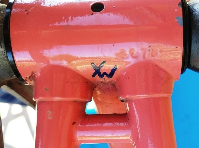

Okay - still reeling from this adventure, very much like a trip to the twilight zone.
I had a bad connection when I spoke to the PO and said something about having a Poliaghi fork for it (???) and 'some other stuff"" but I couldn't follow him due to interference.
As @thinktubes said "Buy - at this point you're in pretty deep."

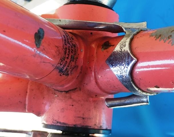

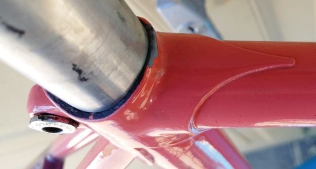

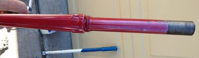

I met with the seller. Immediately upon exiting my truck he handed me a copy of Cycling Quarterly and said read this and if you don't you will never know anything about bikes and that even frame builders who don't read this don't know anything about bikes.
Ok.....
He claims he rode a lot, BITD. Knew Steve Bauer and named other Canadian racers going back to 60's/70's. Told me he had sold all his bikes except this one and a mountain bike.
Good so far.
We look at the bike frame (no explanation as to why he chose to add the stickers). Levers aren't Arrow, they are Suntour GPX and very scuffed so not impressed but still looking.
He claims it was a "hand made frame" and later that he recalled it was an "MKS frame" or an "MK frame". Note there is a sticker from Cycles Plus of Clarence NY which is still in business and I will call later to see if they know about it. It's possible that Cycles Plus brokered the sale of a "hand made frame" but more likely it's what folks on here deemed it to be but PO was adamant it was not a Raleigh.
Rear drops
Ht jugs from DS
HT again
TT lugs at Seat post
ST lugs
Top of BB shell with sticker from Cycle Plus
Serial might be 3878 under the paint??

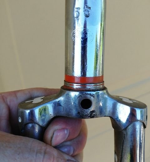

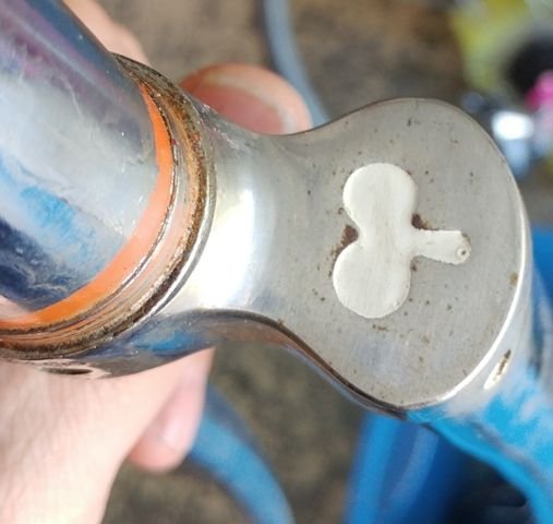

We talked cars and bikes for a bit and then out came a fork. PO said this 2nd fork was the original fork. Lugs aren't the same as the frame but serial # seems to be the same. Shouldn't the lugs on the fork have matched the frame?
Serial is 3878
Then out comes a 3rd fork which is chrome. he looks at it and says, "no not Poliaghi, I think it's Colnago". I can't read the writing but don't think it says Colnago and I thought Colnagos had different lugs. These clovers (there are only two) on lugs are poorly filled in with white paint and workmanship looks very very poor.....
By now I can't tell if he believes everything he says or is making it up to impress me as we go.
Do these look Colnago to you???
Workmanship doesn't look that good......

I emailed the store (Cyles Plus)
Hi
I purchased a bike from an older guy named "Gary" he said he was 72 from Hamburg. The frame has one of your stickers. "Gary" claimed the bike was a "handmade frame" and later that it was an "MK or MKS" frame". He claimed he got it 45 years or so ago. It looks like a Raleigh Professional, Carlton Professional or a Holdsworth. At some point he (or the original buyer from your store) added Pogliaghi stickers. "Gary" was vague on how they got there. The Serial number was 3878. I wondered if you recall the bike? I realize you must sell a lot of bikes but this would have been an unusual one. PS: I understand if you can't help me, I realize it's a shot in the dark. WesleyVery quick replyNo info old store was house of wheels it closed in the early 90s, sorry.
So, I guess I am back to him making it up as he went along or him truly believing what he was saying.....

Old 06-07-19, 11:36 AM
T-Mar
Posts: 17,823
Mentioned: 431 Post(s)
Quoted: 2473 Post(s)
Liked 58 Times in 54 Posts
Sounds like it may be an MKM. They had a Dominator model that used the Brampton Victor fastback seat lug and those head lugs. If so, the serial number indicates circa 1976.
T-Mar is offline

I should have said that the chrome forks are stamped Columbus. Can't hazard a guess who made them.

Yeah, well worth the efforts for quite a HAUL and I think TMar has nailed it as an MKM (3 British gents Arthur METCALFE, Ron KITCHING & Wes MASON) and no idea who made the Columbus fork (not a Colnago) but not shabby and you have 2 forks that will match the MKM when you repaint)!
You might check out this site and especially this page with "known serial numbers" listed:
https://www.mkm-cycles.co.uk/frame-numbering

Unworthy1. I emailed the registry. Offered photos if they desire. Cool that MKM offered 1/2 inch increments for sizing which must have made getting the right frame easier.
My question is was it an actual "handmade frame" in that they made for individuals who walked in the shop themselves or was it a "handmade frame" made in small batches and sent to specific shops? Probably not an important point just wondering.
