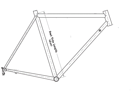

Hi
I think I uncovered something worth noting.
Below is from Surly's website for the LHT.
Their "frame size" is from center of BB to the top of the top-tube.
This is not the standardized way of measurement.
One could have missed this minor difference and order one size too large or too small.

That is the common method for showing "effective" seat tube length, here in the era of sloping top tubes. It would be nice if Surly were to point that out, though.
Though I guess so long as they provide reach/stack and standover, it all works out.
Meanwhile, my bikes have like 8" of seatpost showing because of sloping top tubes.
Yeah for sloping top tubes.
But the LHT is a flat top tube bike.
If I pick the right size LHT for me, the seat post would only show about 3cm.
And if I pick one size larger, the saddle would be slammed on the seat tube.
I like to pick larger size so I can get higher stack and compensate with shorter stem.

I would think that too small/too large would be determined by stack/reach before seat tube length, unless you have wee little kickers. I have stick legs like a stick person, so I dunno.

Considering frame sizes based on seat tube length died a long time ago. With modern frame design it's all about the effective top tube length and stack/reach dimensions. Heck, even when frame sizing was seat tube based, there was little consensus over where to measure point-to-point. Center of crank to center of top tube/seat tube junction? Center of crank to top of seat tube? Measuring from the top of the bottom bracket housing? Nobody agreed on a standard.

All that matters is the height from the seat to the centre of the BB. Things like seat stays or top tubes vary on frame design and aren't relevant to saddle height. Stand-over height depends not only on the type of bike but also the specification of any one example, so that should always be specified optionally.
So the relevant measurement for seat tube length is from the centre of the BB to the highest part of the seat tube - i.e. the part which stops the seat travelling any lower.
Surly have got it wrong.

Kona still designates their frame sizes based on seat tube length -- even with sloping top tube frames. Imagine ordering a size 54 Sutra only to realize after delivery that the top tube is 57cm long? I doubt something like that happens a lot, but I think they'd be better off going with a S, M, L, XL scheme instead.
"Reach" only addresses a portion of the saddle-to-bars length and completely disregards the length associated with seat tube angle. Frame sizing is still pretty much a "buyer beware" situation.

There are several different methods for measuring even traditional horizontal top tube bikes. This can lead to confusion about what a frame size is all about. Even then, top tube length can change the way a bike fits. With sloping top tube frames, most of that goes out the window, so you have to learn about such arcane fitting methods as reach and stack to get a good fit. Thank heavens that I own a couple of great well fitted bikes that I am content with for now. For Dave Moulton, Surly's frame measuring system is spot on.
Dave Moulton's Blog - Dave Moulton's Bike Blog - Measuring Frames

C to T is really common. The other was/is C to C.
Neither was right or wrong. It differed based on brands and areas of manufacture.
Sure, one could have missed what you mention...but then they didn't try very hard to find the frame that fits since Surly lists complete frame geometry, of which seat tube length is but a minor part.

For those interested some manufacturers measure CTC some to CTT either way you still want to test ride a bike if you can especially if you are unsure about geometry but also ride quality. I test rode the Sequoia a bunch and that is why I got it, I really really liked it almost instantly. Surly makes some excellent bikes that may not be flashy or blingy but super durable and reliable and excellent platforms to get started cycling. My first bike I purchased was a Disc Trucker and I loved it.

If you choose your size based on seat tube length, you are doing it wrong, anyway.
