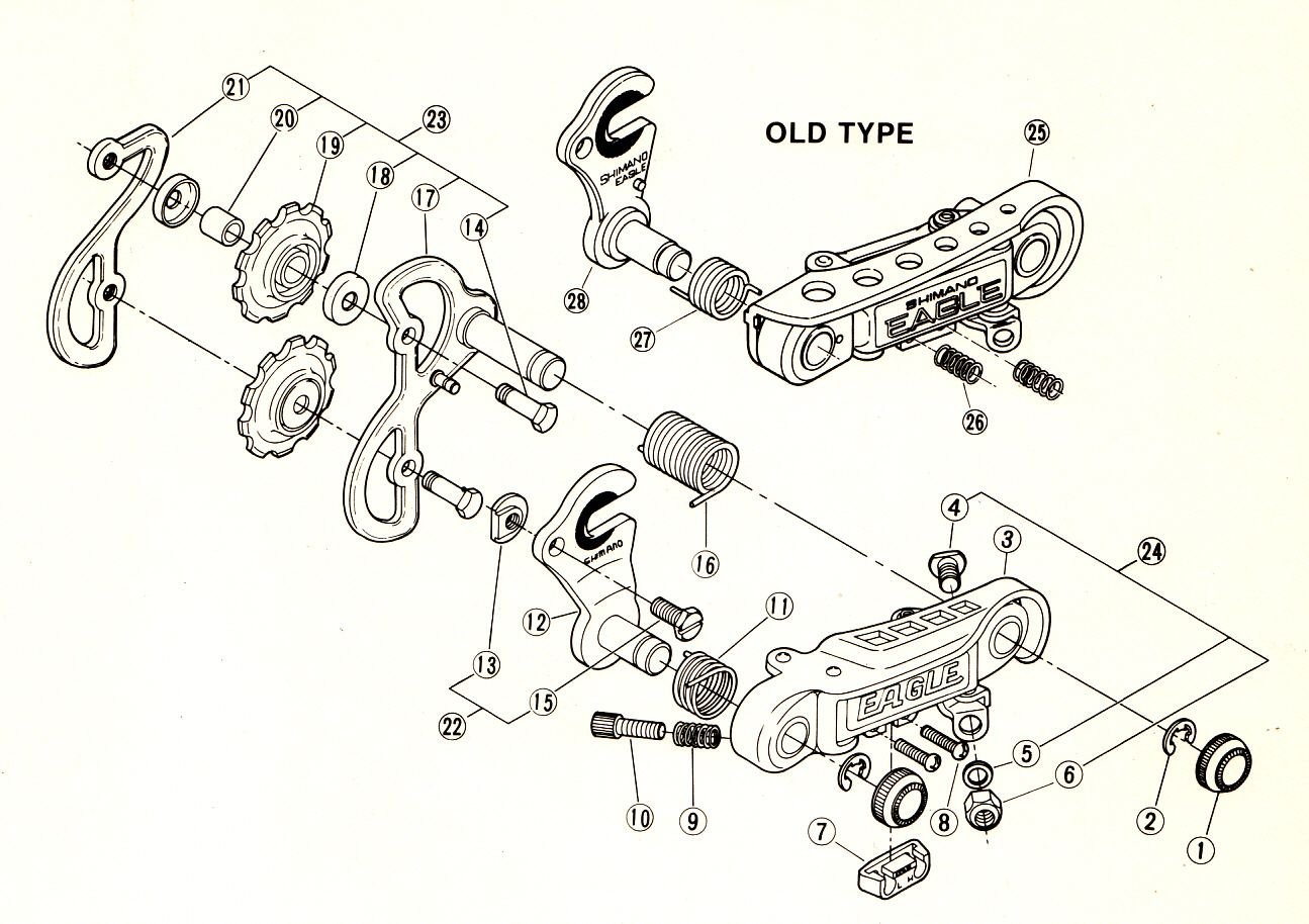

What I like about it is mostly theoretical -- the upper pulley goes down as the mech swings in towards low gear, where most other parallelograms swing up as they move in -- the opposite of what you want, for the jockey wheel to follow the shape of the freewheel and maintain a constant gap from the sprockets. Other mechs have different ways of achieving this, such as the upper pulley floating downward by various means even though the parallelogram is swinging up. DuoPar, Mountech, Super Plate were some of the ways that come to mind. But the Svelto had none of those, so its pulley swings up as it goes in. Thus it has to start out rather far away from the sprockets, and this also limits the largest sprocket it can clear. My Allvit shifts easily to a 32t and could probably clear a 34t (tho I haven't tried). Here's Rebour's explanation of the benefit of the Allvit:
The big heavy main body of the Allvit is needed because the fixed parallelogram pivots are at the bottom, and the free moving pivots are at the top. This is the opposite of every other mech ever made, to the best of my knowledge. No one ever copied it.
The Svelto was made as a cheaper alternative, for OEMs who didn't want to spring for the relatively pricey Allvit! I know this is hard to imagine nowadays, but the Allvit was actually kinda high-end, as touring mechs go. (Campy was not their competition.) Rene Herse among others spec'd the Allvit for ultimate cost-no-object constructeur bikes because for a while there ('60s), it was the best derailleur in the world for that sort of bike.
Allvit pros: shifts better, rebuildable.
Cons: needs to be rebuilt! The pivots get gummed up and need to be cleaned and oiled now and then, and many Allvits have bent parallelogram arms that bind up the action. When I overhauled the one on my Schwinn Super Sport, I straightened the bent arms, lubed and properly adjusted the pivots, and I couldn't believe the difference, the thing shifts really well now.
Oh yeah I also bent the parallelogram-return spring in the direction that increases the spring preload, so it shifts down to the small sprocket with more authority. Balky shifts into high gear was one of the common complaints about the Allvit, especially after it accumulated a bit of grit in the pivots. They should have made the spring stronger to begin with, but the mod I did on mine fixed that.
I know, who rebuilds an Allvit?? No one, right? Just throw it away and put on a Suntour, everyone sez. I only did it because I'm stubborn, and I kinda liked doing it.
Mark B in Seattle
Likes For bulgie:

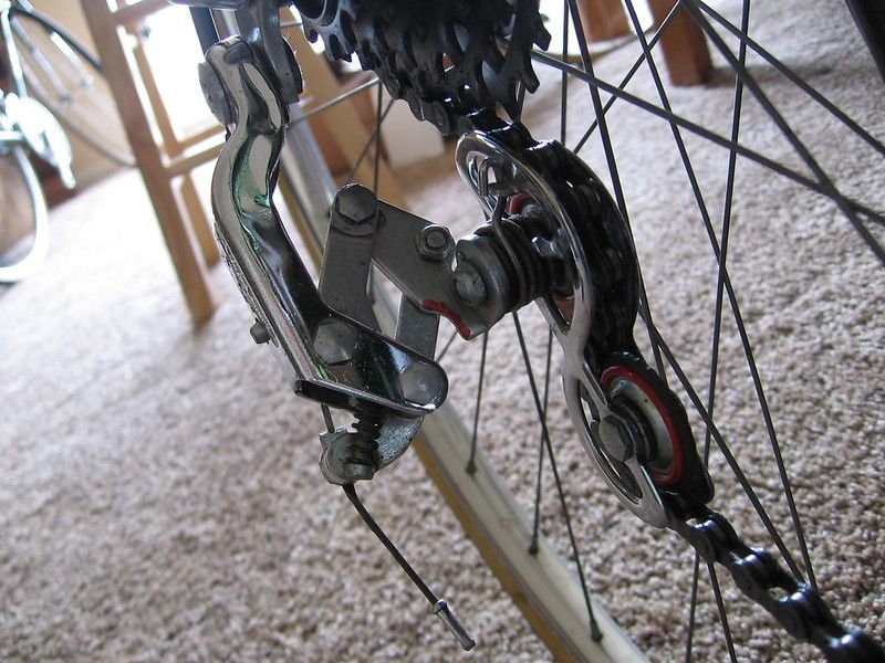

Who can argue with tech drawings from Mark B?
I have a few miles on a Svelto (residing on a Frejus), and it’s OK for old and slow and looks nice. My Sachs&Huret experiences have been better, but never owned Allvit.
best pic I got quick

That does look nicer than I remembered it. They also made a cheaper Svelto with dull plating, and that's what I was remembering. I forgot how nice the polished chrome one looks.

I don't consider the Allvit's drop-down knuckle to be a bash-guard, if anything the longer knuckle only adds leverage to bend the dropout hanger if the bike tips over.
But the normal, later Allvits did "fill in" the simpler early knuckle by maintaining a U-shaped cross-section, which provided support to both ends of the main para arm's bushing while taking away from it's minimalist form. I personally think that this re-design of the B-knuckle was unfortunate, though I am still a fan of the Allvit, modifying them for 6-speed operation (not such an easy task) on several occasions.
The Svelto's disadvantageous travel path with respect to the freewheel's contour will be more of an issue with modern chain, which is much more flexible. But it still can shift well with the right combination of chain and right-sized freewheel.
Thanks, Mark, for your excellent illustrations!
