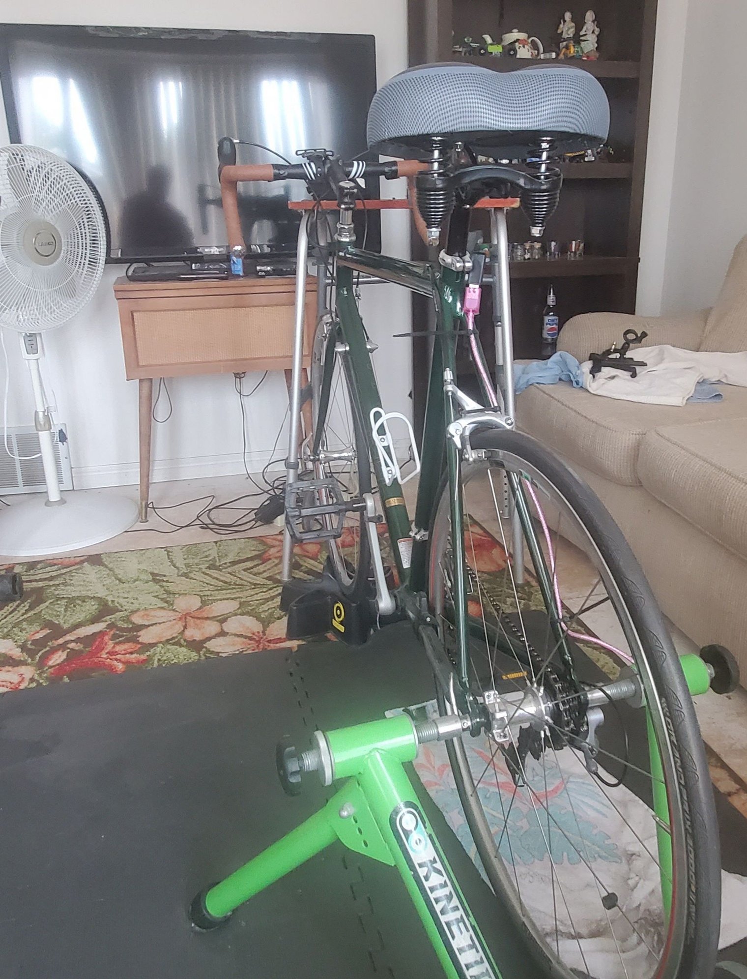

Thanks! I went into the project not expecting much. It is an old machine. I can still use it with some flavor of Linux, as a file and media server. It was a fun exercise at least. Ok. A bit frustrating. But a good learning experience and realizing I stepped away from what the current state of tech is for a bit too long.
Edit: I was thinking about how to make a PC not look out of place.
Then I decided to build it in this sewing machine table. It was my mother in laws, and hasn't been used in 20 years. I think this can tidy up a lot of things. Next comment when parts show up...

out of place? with that saddle???
Haha! Yeah, um. That works well indoors. No way would I like it outdoors.. if I ever do a rocker plate, then I might hate it. I lost over 140 pounds and my butt is not self padded anymore...
