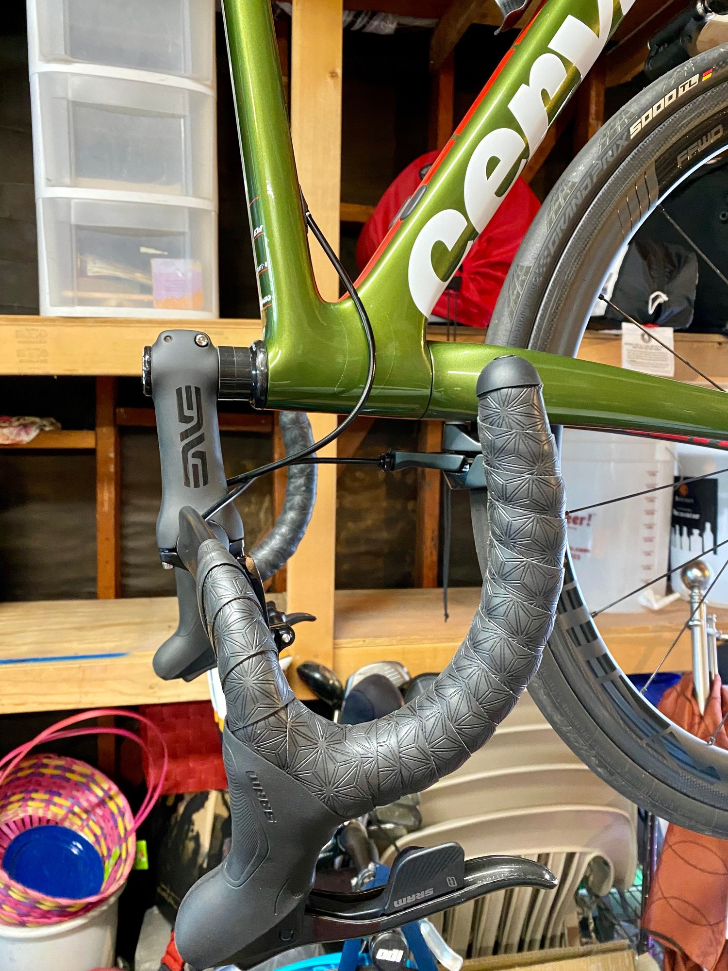

I like Arundel Gecko.
Here is the Supacaz on my R3
