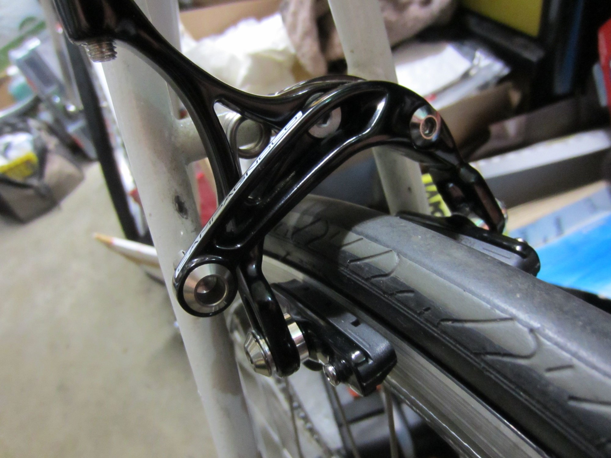

I am pondering a similar question. I have two pair of shorty fendewrs I want to use and it dawned on the other day the reason they never seem to 'fit' is due to the Chorus brakes I keep trying to use. So will an older style caliper like a 600EX be wider? Reach is a issue too

So to sort of bump my add on question, will a pair of 600EX sttyle brakes allow enough clearance for a pair of narrow ESGE 'shorty' fenders?

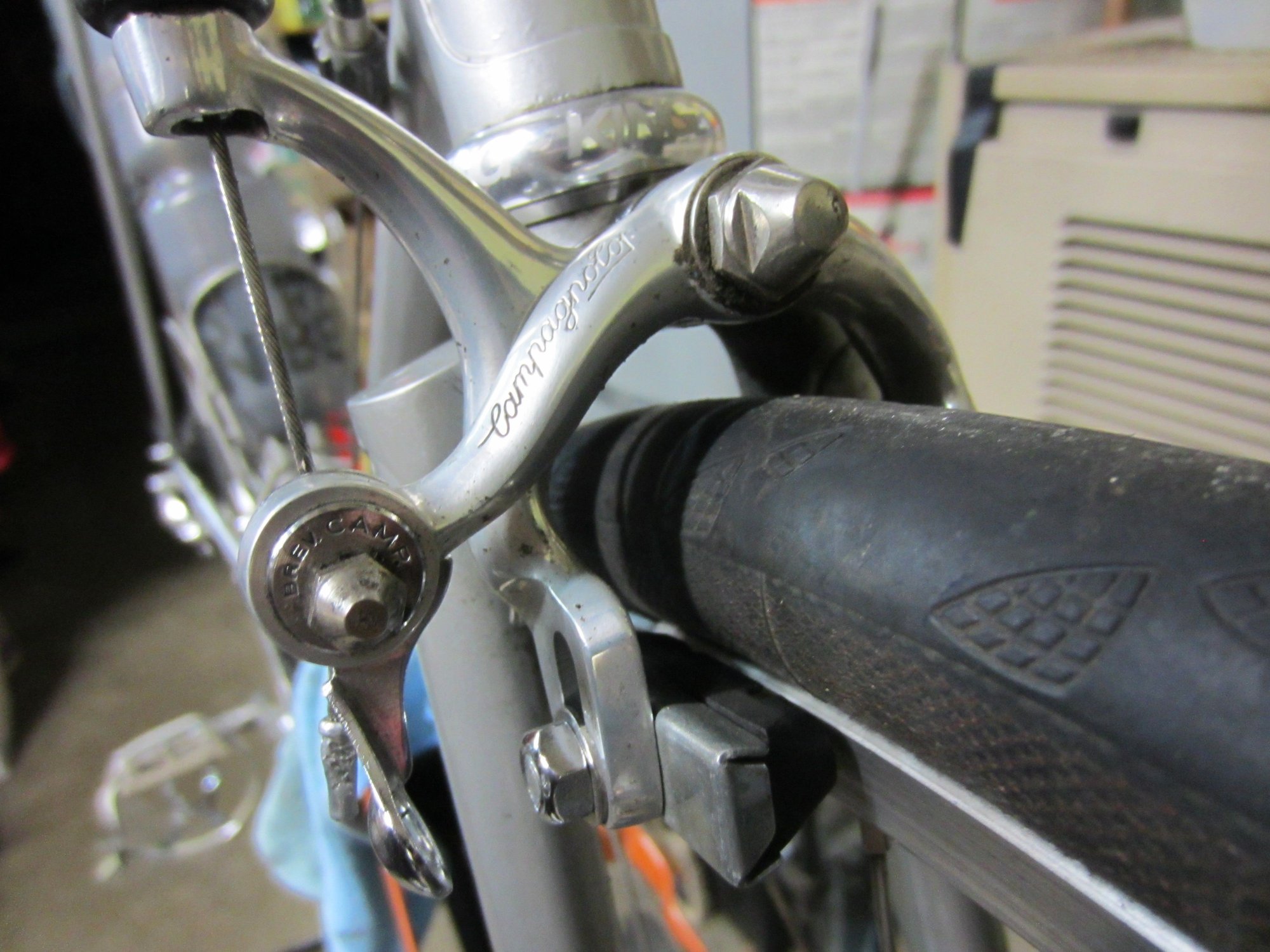

The frame is also a bigger factor. Here is the big Merz that I am pretty sure was built for fenders with 32's and a PX-10 that was probably not but has a ton of room for tires and fenders.
The Merz was used as an example for the new Strawberry I built but still was a huge challenge as the crowns on it were designed for 650b rando builds, not 700c builds with 32's but Dave made it happen.

This was a huge challenge that Dave whipped on without breaking a sweat, still ruminating on if 35's will fit but I have little need for more and this is not likely to see any gravel if at all, there is very little clearance under the crown but with plenty of reach leftover there is wiggle room to work with I think.
