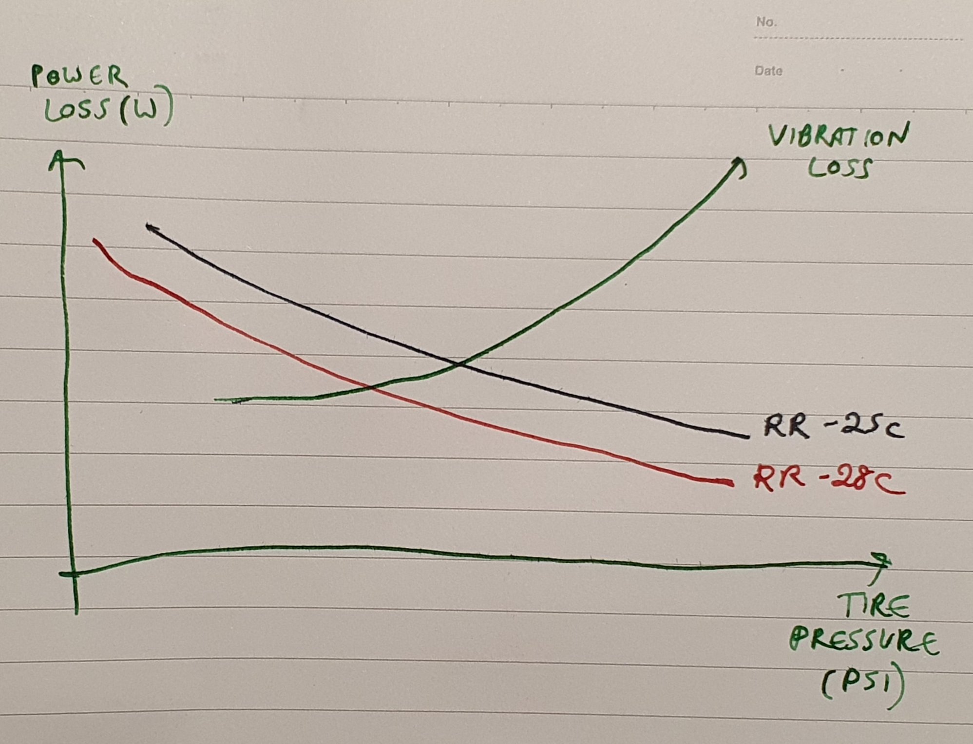

I hear you about the lure of the wide. I have actually put my R5 frameset on sale and am getting a Factor LS precisely because i am getting hooked to the idea of having atleast one bike that i can ride whereever the hell i want, without worrying too much about the road conditions.
ST seems to be slowly getting on the wider=faster bandwagon but you know the place - it's like the 41 on cocaine: saying the sun rises in the East will get atleast 5 dissenting opinions.
Honestly, even i am not convinced about the math behind it. Generally, the argument, as I understand it:
- RR reduces with tire size but for the same pressure - lowering the pressure increases RR, although not significantly (1W or so for 10psi lower)
- RR also reduces at higher tire pressures - but up to a point. After this, vibration losses increases significantly and you lose a lot more watts (5-10W for 10psi more)
- So it is better to be a little too low than a little too high
So far so good.
My 2 issues with this:
1) the sweet spot for, say, a 25c tire, is around 90-100psi as per Silca's blog. Based on info that i got from emailing Zipp about the vibration loss curve, the sweet spot for a 28c tire should also be in approx the same pressure range, albeit with a lower overall number (ie, better efficiency). So i dont understand where this whole "run them at 70psi" math is coming from, that Zipp and Enve seem to be fobbing on us. The sweet spot for max speed seems to be around 80-100psi, depending on the quality of your tarmac.
- I have yet to see any numbers that compare aero for an optimized 28mm tire on a matching rim vs an optimized 23mm tire on a matching rim. Going to a wider tire saves you a bit on RR. But what does it ocost you in aerodynamics? No data on this.
In short, I admit to being a bit skeptical about the degree to which the pendulum is swinging towards wide tires, atleast from maximizing performance.

I thought the "wider tires lower RR, but only at the same pressure" comes form BRR, which made me skeptical of their pressure findings (as opposed to overall, which I suspect they do a great job of ranking tires). Zipp's statement to you counteracts their chart of decreasing pressure reducing RR until an inflection point. And that's separate from what I notice, which is that handling worsens under 70psi with good tarmac; it's most clearly visible on COTA in the descent from Turn1. But being able to run 80psi for a tri would be great on certain courses.
And yes, the whole "fully optimized for each situation" is the test we never seem to get for anything.
I seem to recall seeing in a few places that "wider = lower RR for a given pressure" and "lower pressure = higher RR" (although this is for a perfectly smooth surface - the vibration losses account for the roughness, I guess).
So here is what I was trying to say. If you take a 25mm tire and plot its RR and vibration loss, you get 2 curves - the line in blue showing the RR and the line in green, showing the vibration loss for a given surface. The point at which the sum of the two is minimum is the inflection point. This is the whole Silca graph (https://blog.silca.cc/part-4b-rollin...-and-impedance). Assuming for a second that the "wider = lower RR", then for any given pressure, a wider tire will have a lower RR than a thinner tire. So the RR curve for a 28c tire will look like the line in red. My question for Zipp was whether the vibration loss curvel (for a given surface) changed for a tire width or was it dependent entirely on pressure - their reply was that it was more or less dependent entirely on tire pressure (again, for a given surface).
If so, then the inflection point for a wider tire is going to be fairly close to the inflection point for a narrower tire (given the the RR curve for the 28mm tire and the RR curve for a 25c tire are separated by less than a watt - source: https://www.bicyclerollingresistance...000-comparison) .
If you look at the Silca graph on the link above for optimal inflection point for asphalt, it is around 90-110psi for a 25c tire. Based on this, the inflection point for a 28c tire or even a 32c tire should be well within 5-10psi of the same pressure. So 80-100psi. Where the heck are Zipp and Enve coming up with 60-70psi? Admittedly, using the Silca graph again, this means we are looking at a 2W reduction in efficiency - so it isnt huge. But for a product aimed for maximizing speed where even fraction of watts saved were touted as a Big Thing (that's why we are buying $2k wheelsets, right? For that little marginal gain), it seems weird to move to what appears to be a slower product.
And I havent even gotten into the aero side yet. Scroll down a bit to the section on Rolling Resistance vs Aero on the DT Swiss site (https://www.roadrevolution18.dtswiss.com/endurance/) and you find this chart:
So the wider tire has an aero disadvantage. And that disadvantage is worsened at speed. So above 35kph, you dont really want too wide a tire after all, it seems. Atleast as per DT Swiss and SwissSide.
Yet the narrative from Zipp and Enve is pushing us all to wider tires (which have a very small improvement RR for a given pressure, but a significant reduction in aero at higher speeds) and lower pressures (which appear to be far lower than what would be indicated by Silca's numbers, atleast).
Possible reasons I can think of:
1) Industry is latching on to a new trend to sell more wheels (which is a bit overly simplistic - I dont think the industry would just make stuff up across various companies)
2) Silca's science is correct but the numbers are off, and that in reality, the inflection point is at a lot lower pressures
3) There is another aspect - perhaps rider comfort/fatigue - that we havent considered. But if the wheel brands had factored it in, they would talk about it

I think that the other thing that needs to be considered, in terms of optimization, is the average Schmoe on the bike is a lot ******g heavier than the guys getting paid to play bikes. To me, that moves the break point considerably - moving from 23/25 at ~100 psi to 28/30 at 65-70 immediately translated to being fresher, less beat up and faster on anything longer than an hour or so.
Ah, that's a really good point - I didnt factor weight into account as a variable.
Would a heavier rider shift the break point to the left or the right, compared to a lighter rider? On one hand, heavier could mean less bouncing and so less vibration loss. OTOH, heavier could also mean a greater downward force, resulting in a greater upward force (and so more vibration loss). I dont know the answer to that.
The Silca tests were done with 190lb rider+bike weight, FWIW.
