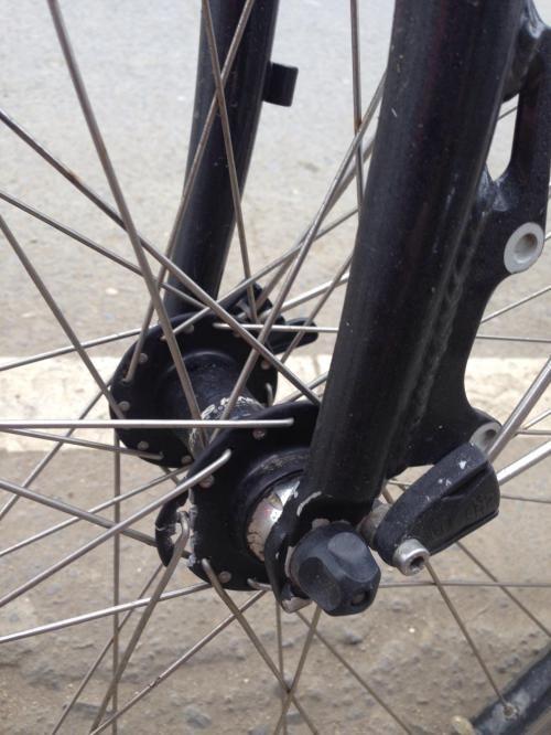

I have Shimano 105, Deore, Ultegra. They all work well here in Cambodia, easy to service and keep adjusted. A handful of ball bearing and some grease is all I need.
